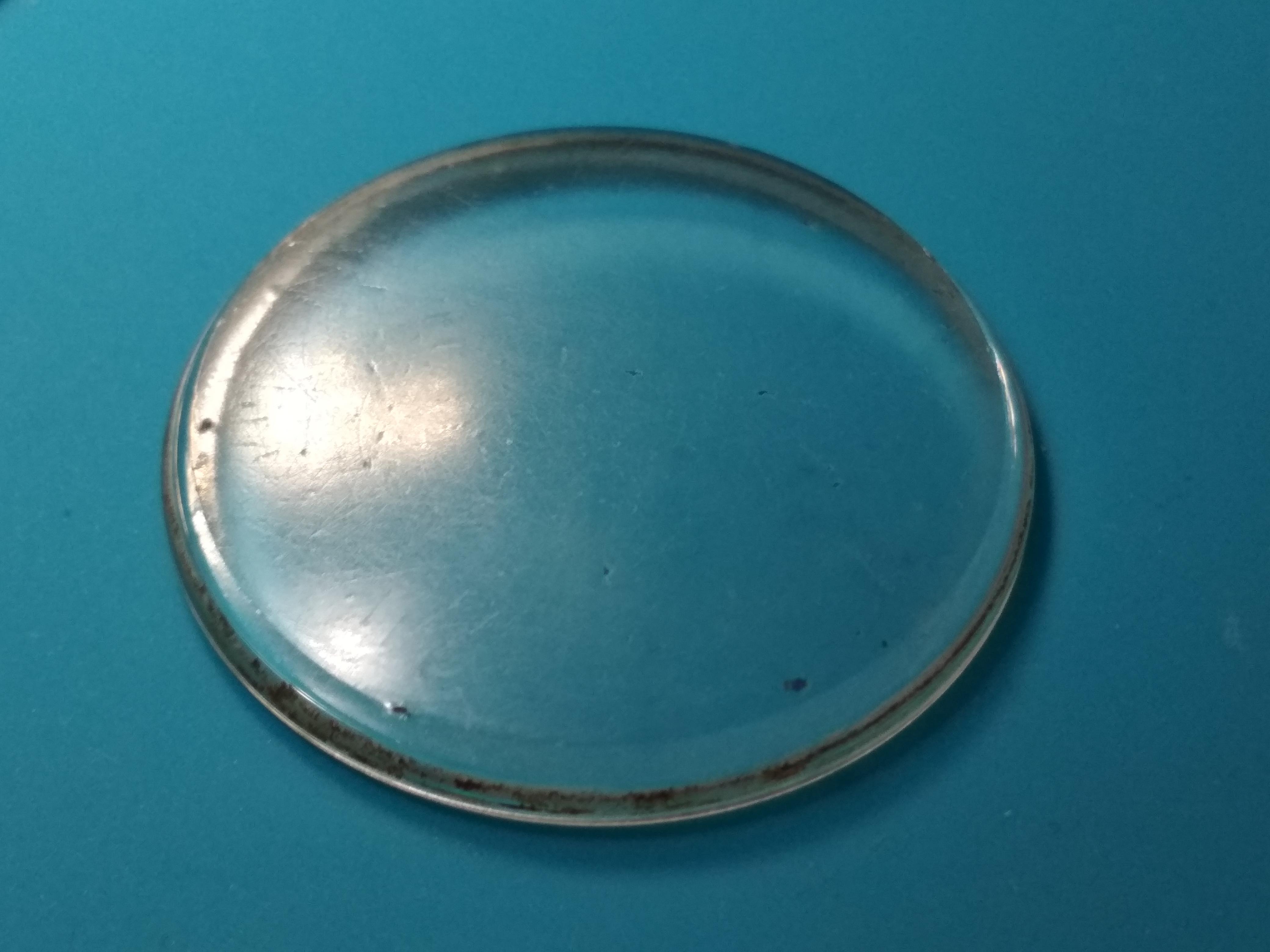

I polish mineral glass with good result only using water paper and cerium oxide powder. You can see result below.
Blimey what a difference! How long did it take you?
