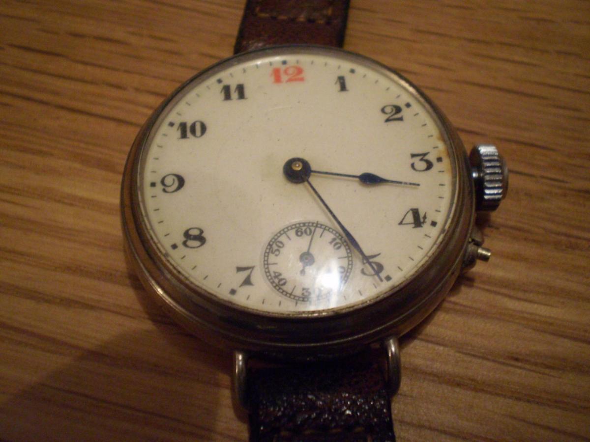

Thank you for your suggestions so far, I am familiar with Cousins having bought the necessary tools from them (I love tool shopping :)) There are no markings anywhere to give a hint, foolishly I did not photograph the movement before dismantling it and my pencil drawings won't be much help! The movement is held in place by one large cock and another that holds the balance, it does not look very elegant. This is what it looks like whole:
Clearly the crown has been replaced at some time.
I did think at first that the balance staff was broken but looking at it closely when disassembling I am pretty certain it was simply dislodged from its cock.
I have another coming in the post that looks very similar so that might give some clues and I'll see how many springs on Cousin's website might fit the bill.
Looks like a typical, pin-set "transition" watch from the 1910s/1920s - often paraded as "trench" watches on eBay - and not uncommon. It should be possible to get a spring for this if you can identify the movement.

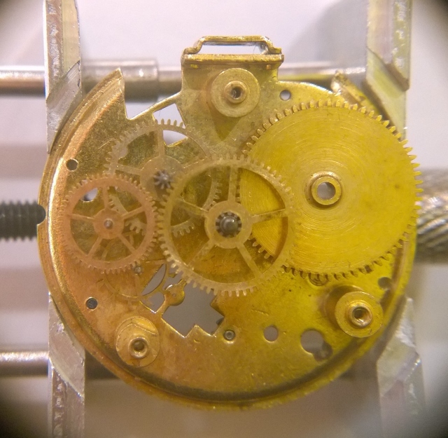

I promised to prop the movement together so you could see it - here it is without the balance both with and without the back plate. I am already wondering how on earth I'm going to get it back together with everything in place:
I have also had a go at the mainspring calculations, I could not get the calculator on the website to give anything meaningful but working through the calculations by hand gives a suggested mainspring with depth 1.9 - 2.0 mm, thickness 0.12 mm and length of 426 mm which seems plausible though there is nothing matching that on Cousins website. Those calculations are based on having 30 hours per full wind which would equate to 27.25 full turns of the mainspring.
