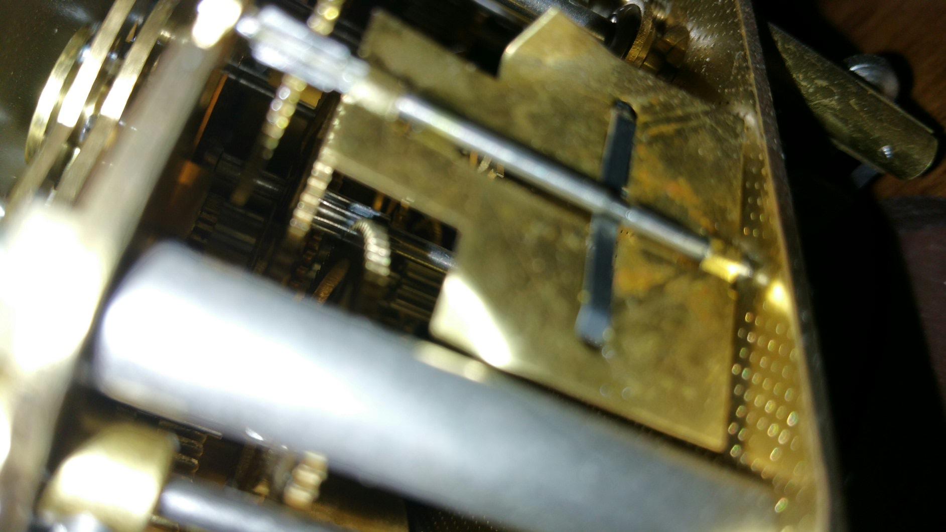

A friends Mum has a lovely wall clock with pendulum and 3 spring barrels (chime and half hourly) which slows and eventually stops within about 2 minutes of being started by hand.
The pendulum appears to be tilting back slightly. I.e. clock case leaning backwards. I've adjusted this a little but it's still not perfectly hanging down. It's not catching anywhere and the movement from a cursory inspection appear very clean.

Is it in beat?
Is it making a nice Tick, Tock sound, or does it sound like an old man walking on crutches?
If its not in beat it won't run well, or if badly out of beat not at all.
An easy test is to tilt the whole case on the wall left or right a few degrees and see if the ticking sounds better or not.
If it does then its out of beat and needs to be adjusted which is not hard, just Google 'Putting Clock in Beat'
If it was working, got taken home and then stopped working being out of beat is very likely.

This movement has a friction tight crutch with an attached scale for the pendulum to show it is dead center. The clock should have a nice even tic tok. There is nothing in the way that can interrupt the pendulum that I can see, the suspension spring looks right. The escape wheel and pallets look dry so a little oiling will help a lot, that could be the reason why it is temperamental.
