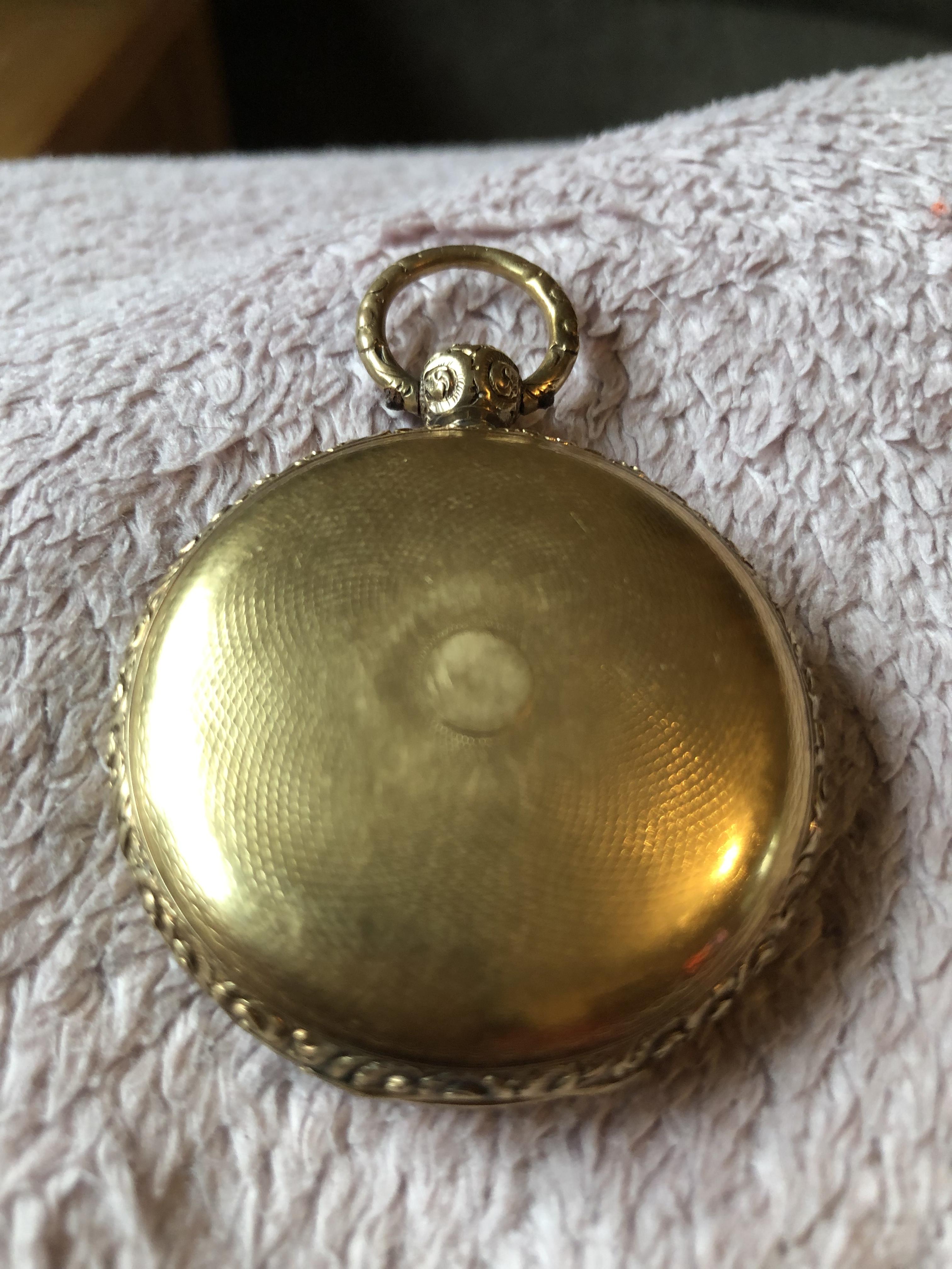

I have today picked up a pocket watch to play with and try and get working. I have no knowledge at all what it is so am asking the collective for any information and help.
The movement is loose and has two steel bands inside one of which has rusted. The hands are not there but will be arriving at the weekend. There is no glass so will need to be sourced. I’m not sure if the case is gold, plated or whatever but it will need a polish, any suggestions.

It has a gold stamp (crown) with 18 underneath and there is on EBay at the moment a very similar watch with the same case (slightly different) which is listed as three colour gold which this appears to be.
There is a stamp mark which appears to be JLS & Co but I cannot find them listed. Ok I got a little fed up with hundreds of sites for some kids boy band and gave up :(
Looks like an English fuse pocket watch. They are entirely different to what I would call an average pocket watch movement. If you have never repaired, a fusee you need to read up and understand how the fusee works. You must be extremely careful with the chain. If the case is gold it will be hallmarked and you will be able to date it. I would say its around 1840.
The stamps are faint the crown with 18 under I believe is the mark for gold the others not sure about possibly an S date stamp.
Could be JLS&C.
as mentioned I do not intend to mess with this one other than test it once I find a key.

If the S is the hallmark it looks like Oldhippy was pretty on the money as its 1833.
http://www.thebigworld.co.uk/dating_english_hallmarks_silver_and_gold.htm

Another issue is that the back plate of the case is stuck firm I can see that there is a hinge for it and I thing that it should be opened by a button on the top. This should press down onto the rusted steel plate inside the rim of the case. Does anyone know if these can be bought as spare parts? How are they removed?
The case springs do turn up on ebay from time to time, there are several lots on ebay now, but not sure if they are correct for your watch.
Do an ebay search for 'pocket watch case spring'
