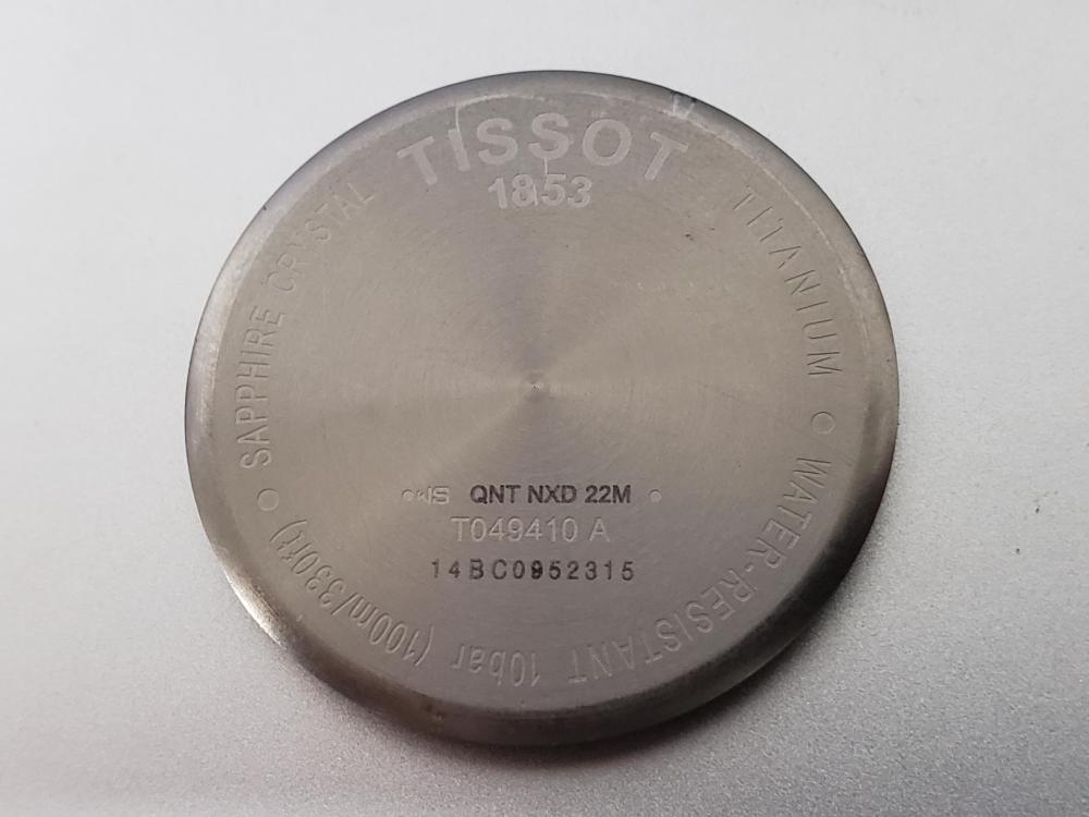

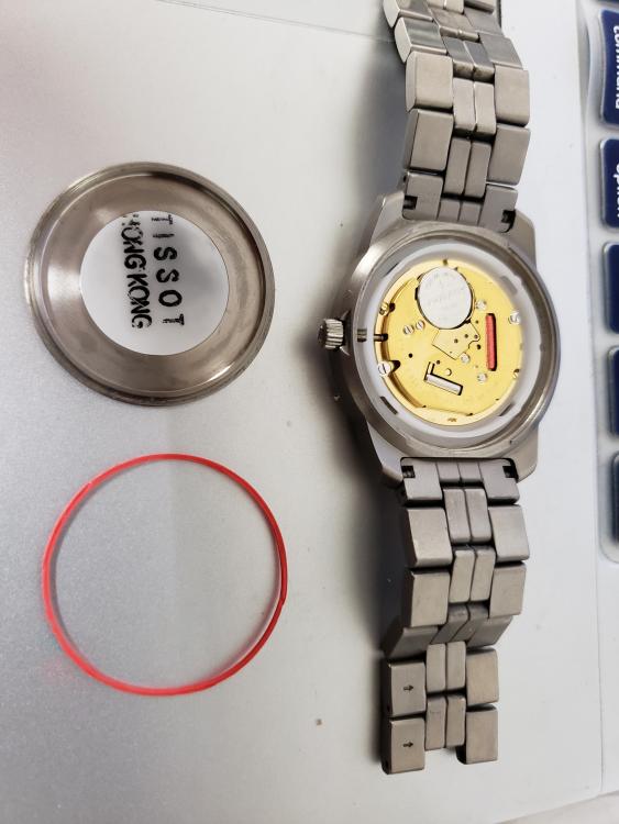

I am replacing the battery on a Tissot watch.  The back cover snapped open easily enough, but I am having a difficult time putting it back on.  It has a red o-ring that is hard, instead of soft and rubbery.  I believe it acts as some sort of wedge when putting the back cover on?
Any advice on this would be greatly appreciated, I have attached pictures below.  I believe I may need to replace the red o-ring?

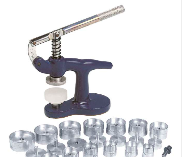

YOu'll need to press it back in using a crystal press. If you try anything else you may damage the case and possible crack the crystal.

Yes a case back press is required to pop these back on mate!
You could use a glass press to put the back on, that's what I had to do with Tissot automatic with a back that was stubborn to press back on by hand.

I have two different presses, and having difficulty with both.  I can press the back down all the way, but it does not stay.  If I put the back on without the red hard o-ring, it fits all the way down, and is loose.  That is why I thought the red hard o-ring acts as a wedge?  I believe the red hard o-ring is disfigured, so I am looking for a new one online.  Just hoping someone could confirm this is how these backs attach?

Personally, I prefer the screw down type press as they give more control.

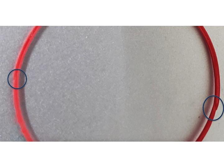

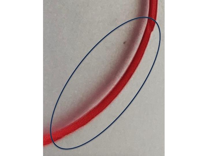

The red --ring is twisted in one place and slightly splintered in another:
Pay special attention to this area and make sure it is completely seated within the grove before pressing down gently, but firmly with the press.

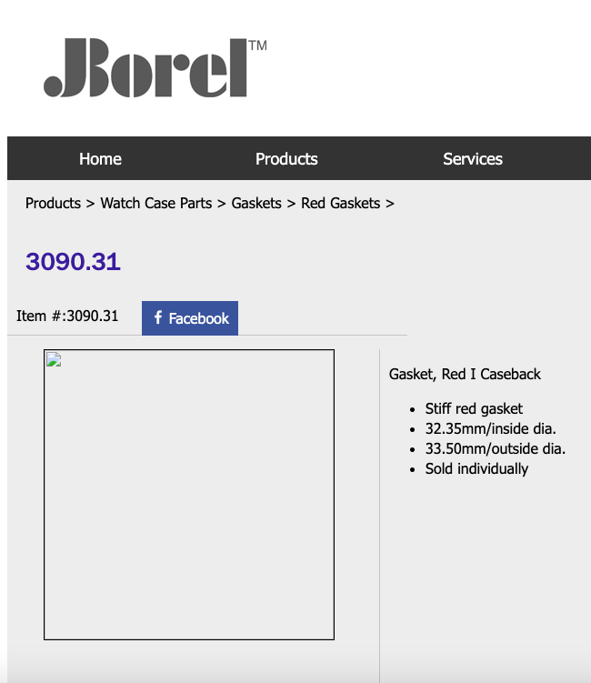

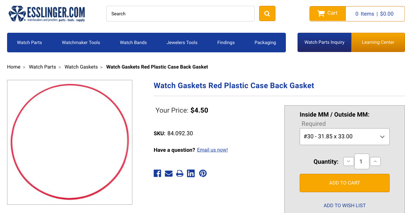

Is there a website I can order a replacement from in the USA?  I can find them overseas but cant find any locally.  The outside measurement from end to end is 33.25mm, inside measurement is 32.05mm, and thickness of red ring is 1.72mm.
Expand
J borel and Esslinger have red gaskets, but not exact size...Both are 4.50 but you need an account for J Borel ordering.. Esslinger lets you order without account. You'll have to try them and see:
