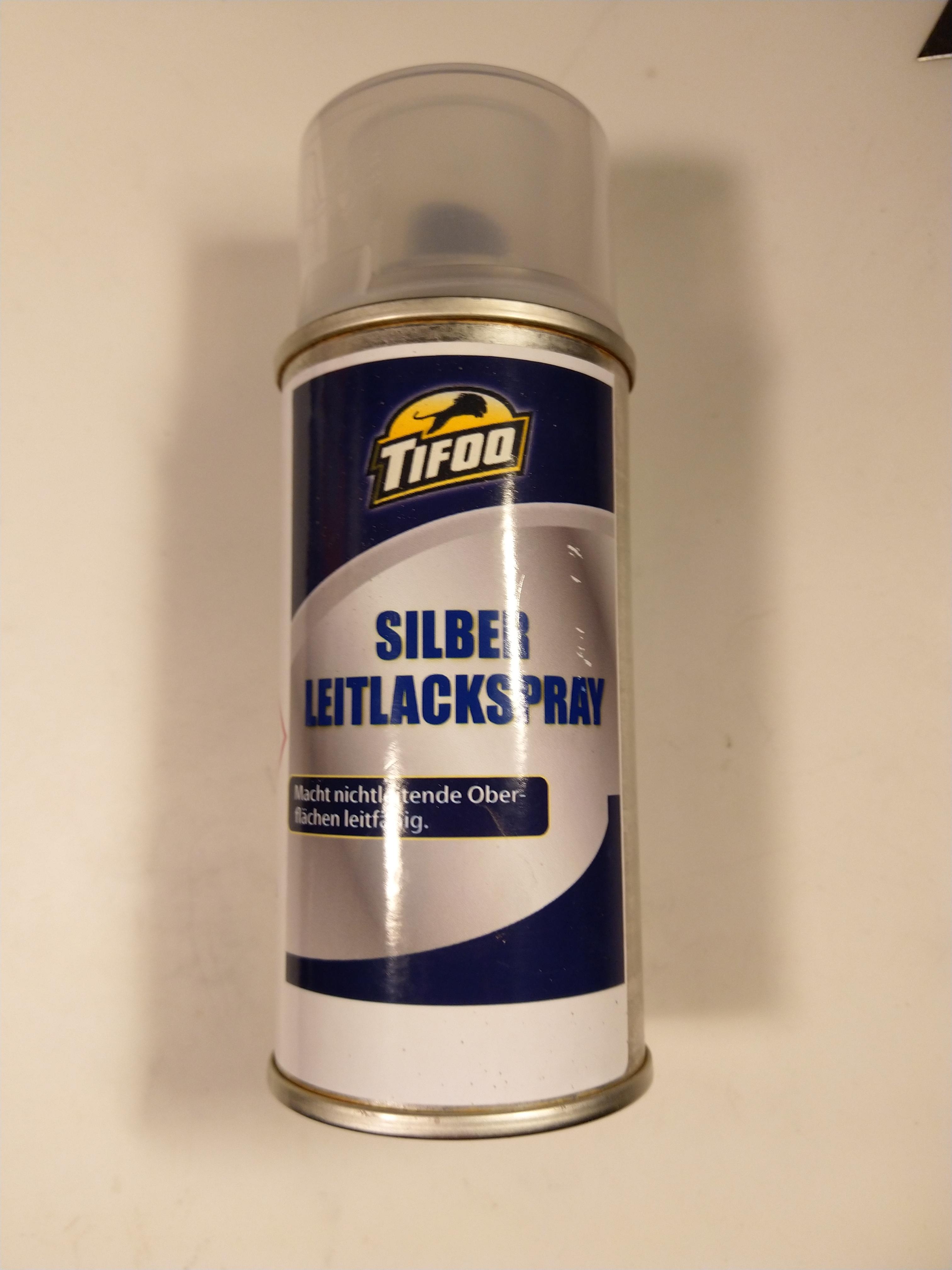

I'm not familiar with that brands products but I have used one conductive spray and the result depends lots of the preparation work.
Grinding with a fine sandpaper and spaying a couple of times with a grind with 2000 grit sandpaper after every layer gave a smooth surface. It's little like spraying a car.
I use the silverspray to make a gold plating.

The filament should do the trick too. It was a while ago i tried out these products not just on watchprojects but also on mobile phone cases, for the kids.
The only disappointment was the thickness of the plating which seemed to wear of quite fast.So it seems the product I used isn't very partyproof ;) .
