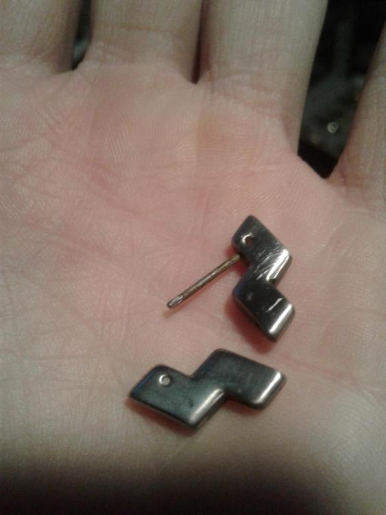

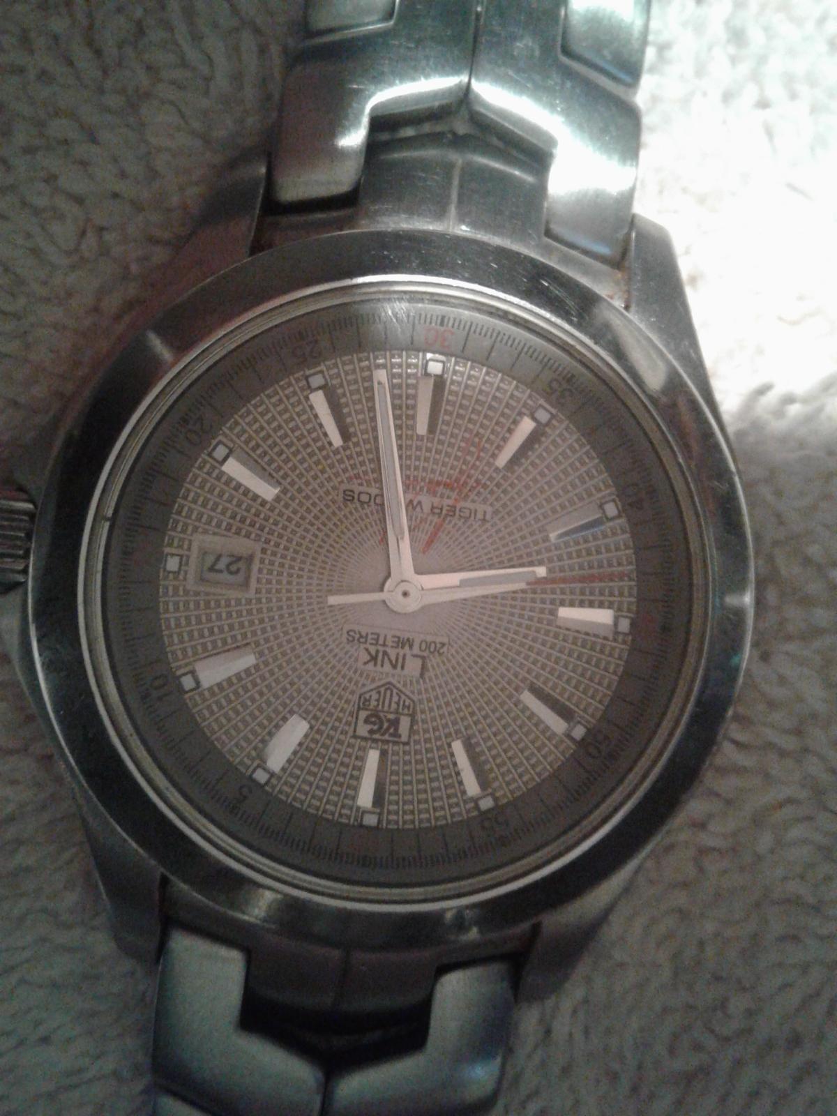

Hello. Im Anthony. I am a watch collector and i install batteries, size bands, and do simple repairs. I am working on an at home system for buffing plastic, glass, and crystal lenses. A friend recently gave me a Tag Heuer tiger woods Link watch. He has given up after breaking 3 links. I am looking for help making this watch wearable. I watched a couple videos and learned how these links work, and after getting the remaining links apart, it appears the band is a lost cause, as there is rust between the split in each link, and the bars that attach them are damaged and brittle. Now I know why he gave it away. I would like to figure out how to remove the entire band, and go another route. Perhaps modifying a leather band to fit. I am not looking to buy more expensive links. I am considering a new Link band, but I dont have the cash to put into this at this time. Just looking for advice. I will try to attach pics of this watch. Thank you. Nice to meet you all.
I am having trouble taking off the first link on each side. I cant find and info or videos that show removal of the entire band. I have found videos for adjusting these bands, but nothing about whole band replacement or simple removing the first links or the pieces that the links attach to. I dont want to declare this a lost cause. The watch face looks great and runs good too. Do I have any options here beyond buying a new band?

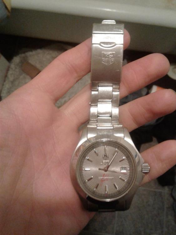

i was wondering id someone can tell me if this repplacement band i found on ebay is compatible with this watch. thanks
https://www.ebay.com/itm/20mm-S-steel-bracelet-band-strap-FITS-TAG-Heuer-LINK-series-Diamond-BA0575/163276968041?epid=7005834089&hash=item260410d069:g:~dcAAOSwhplaXKYj

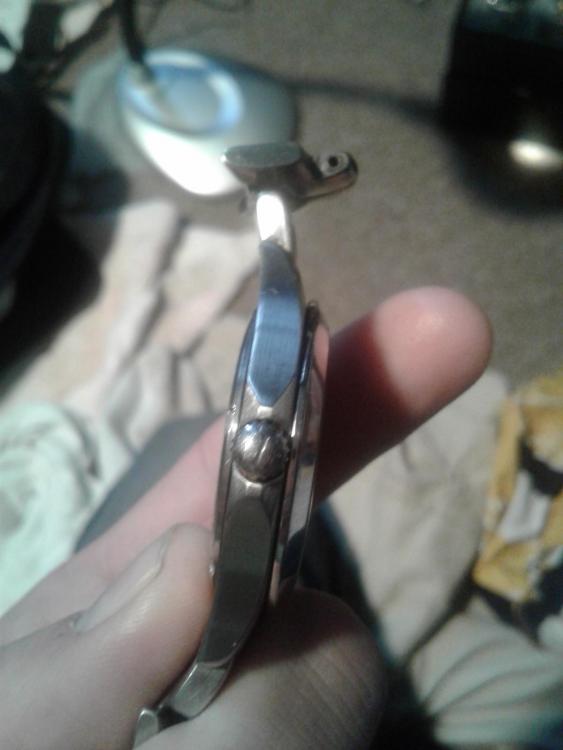

I do not think that bracelet will fit you watch. I has a different design to fit your watch case. Are there any pins you can push out at the case side. A photo of the case turned over might help, are there any holes at the side of the case in line with the bracelet?
there are no holes on the case. removing the first set of links, so that another band can be installed, seems to be the primary problem. I think this watch may be a replica. The bracelet that came with it looks very convincing. But the way it has rusted and broken at several links makes me wonder. furthermore, i cant find the model number, but when i find the watch online it seems to be a copy of WJF2113. The primarily reason I am looking for an alternative band, instead of selling it as is, is because i doubt its authenticity. It was given to me. I buy and sell alot of watches online, but i wont sell a watch that is not certainly authentic. Having bought several lots at estate sales and ebay, i have acquired several knockoffs. i have replicas of TAG, Movado, and Rolex, which just sit there as 2 are ladies watches and the rolex is too low quality to wear. cant sell them, so the only thing i can do (at least in this case) is try to get it wearable. i cant afford a TAG. My best watch is a movado. hoping theres some way to make this wearable, and either give it back to my friend or maybe trade, if its worth keeping. the face is real nice and runs good.  pics are attached.

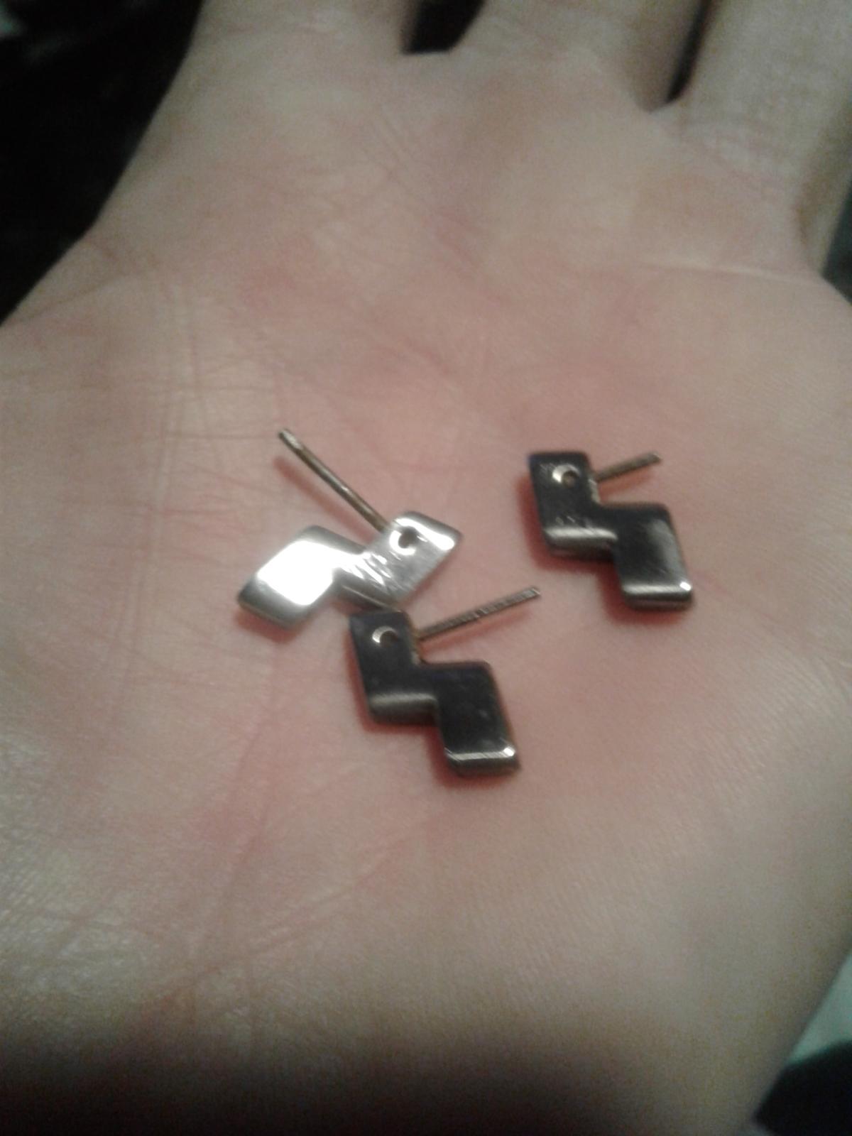

I forgot to mention: I thought maybe buying a bracelet like this would allow me to simply borrow the links needed to complete the band. the links (purchased seperately) a very costly, and i need at least 3. not to mention, I expect the links i have to xontinue to break down. i will attach pics of some of them. even the unbroken links are rusted and look like they wont hold up. I have seen the leather replacement bands sold for TAG Link watches. im not gonna pay several hundred $ for one of these, but i think i can reproduce the effect by modifying a leather band of my own. If only i could get the last links off the face of the watch. thx for replying. I know alot of people would say to throw this away, but the guy loved it b4 it started breaking on him, and not all of us can afford to buy a watch like this. thx
Anthony sorry it is my fault I forgot to get back to you. Have you tried a small blade or small screwdriver in where the red arrow is pointing and pull that pin back. That pin looks something like this.

Hi your latest pics show that bracelet on eBay could fit (I'm 93% sure) if the lugs measure 20mm. But that bracelet looks repairable, provided this is the pin thickness you need https://www.esslinger.com/knurled-pressure-link-pin-assortment-1-3mm-thick-refill-sizes/

The push pins can be removed with a tiny screwdriver. If there rusted stuck a few light hits with Jewelers hammer might work it loose. You should probably spray a tiny amount of PB blaster or 3 drops of ATF. I think your friend lived on the ocean.
What kind of movement does that watch have? It looks real.
well i got this watch pretty well squared away. once fully disassembled (which was a rusted nitemare), I was able not only fit an invicta band, but also make a prototype of a rubber band. I wanted to practice with rubber, before cutting into an expensive leather band. tbh, im happy with the invicta band. i was able to still use the TAG buckle. see pics. thanks
