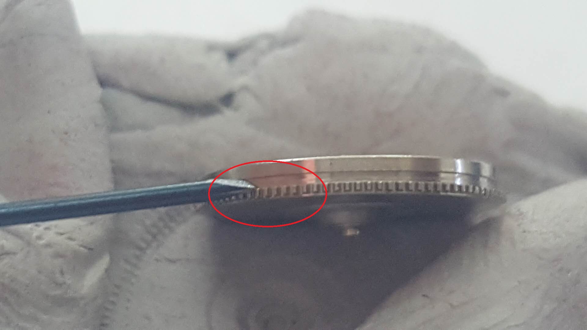

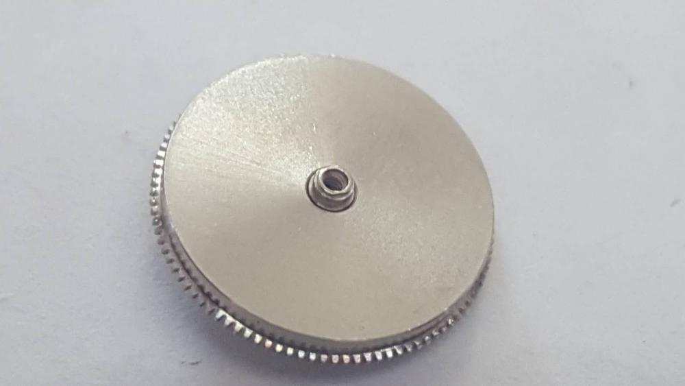

Is there a better way for the 7s26 barrel to be opened apart from a screwdriver?

What size was the barrel as Bergeon do up to 19mm but they aren't cheap. In the past I've made some of my own using stainless tube and a suitable arbor from my set. Edit If I was making one again and had to buy the tube I'd go for brass. You'd need 3 tubes of reducing diameters and a couple of plastic disc for the pusher part as sketch below.
