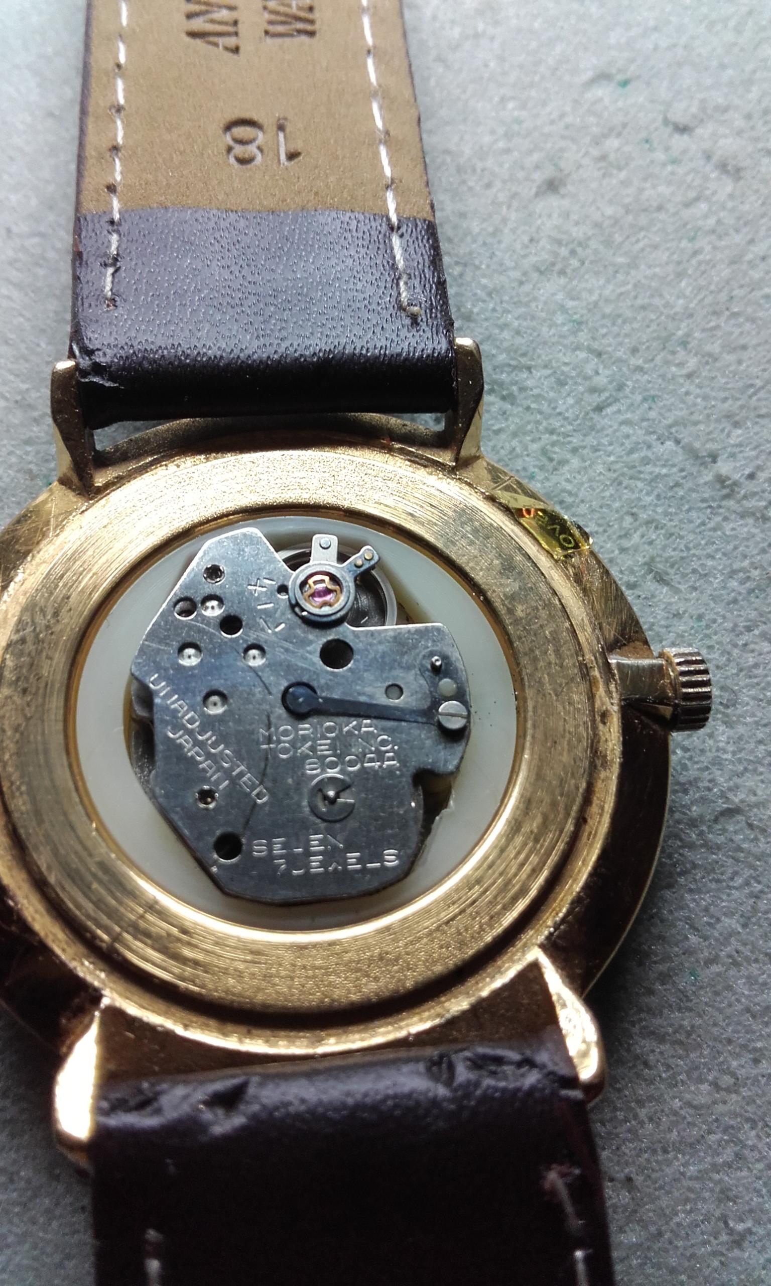

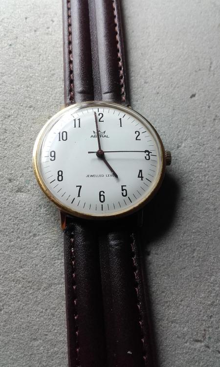

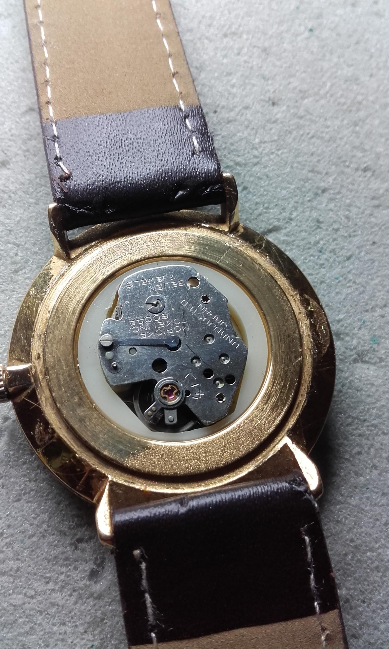

 i recently purchased a Astral watch which was supposed to be by Smiths but the movement is a Morioka tokei inc 8004A 7 JEWEL.any info would be appreciated.it is also running mega fast.thanks.B.
Edited by berniethebolt
added photos.
I have never seen this movement before. It might just be magnetised causing the hairspring curls to stick to one another.
ok thanks.w2ill try that or take it apart eventually.
