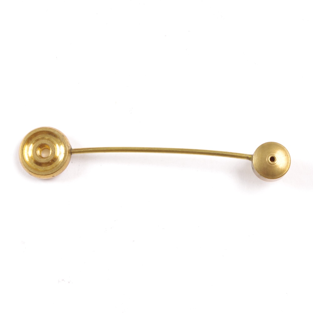

I would loosen grub screw on the hammer and carefully turn it to the side till is misses the bell/gong,
                                         regards john
                                         regards john
Not all hammers in French movements have grub screws. Those that strike on a bell are normanly screwed directly onto the brass wire that makes up part of the hammer. See photo.
