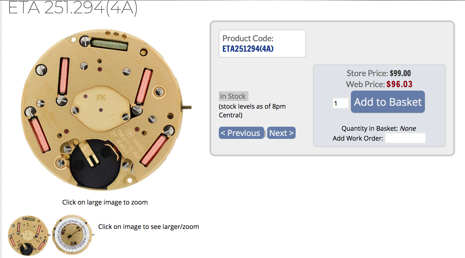

Some pictures of my movement, which appears to read 251-292
I've found two similar movements:
http://www.startimesupply.com/merchant2/merchant.mvc?Screen=PROD&Product_Code=ETA251292-4S&Category_Code=09-Movements
And
http://www.startimesupply.com/merchant2/merchant.mvc?Screen=PROD&Product_Code=ETA251294-4A&Category_Code=09-Movements
Will either work?
Star Time Supply won't sell to a hobbyist, is there another retailer that sells this movement?
I found this one on Ebay, sold by a Greece seller.  It does have the date at 4 O'clock:
https://www.ebay.com/itm/ETA-251-292-Genuine-Movement-251-292-Quartz-251292-Date-at-4-white-dial-NEW/263427762010?hash=item3d5584a75a:g:NtYAAOSwHm5ZtpAJ

I have an account with Star time. The watch movement you've mentioned is the correct one, and if you want the date at 4 o'clock then you click on the other link to specify the 4s date wheel:
5a659e86047c9_ScreenShot2018-01-22at3_15_47AM.thumb.png.95e19657c0caa28d77c5f498fe386ac4.png
As you can see, it's not cheap, so maybe the movement from Greece would be a better deal if you factor in shipping. I would be willing to order it for you if you decide that's the best choice.

Well, thanks to some help from a forum member, the Accutron is back in business.  That ETA movement was indeed the correct one.  The sweep second hand didn't fit, so the hand that came with the new movement was painted to match.  Everything works perfectly!
