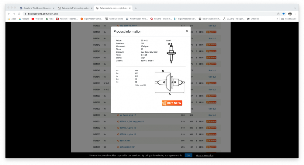

I got a 861 NS riveted to a balance wheel, but now cannot affix the double roller to the staff re: it looks like the roller shoulder on the staff is too small (it measures 0.60mm instead of what I believe should be 0.63 mm). So the double roller just drops to the roller seat on the hub. I tried to close the double roller hole but it is too hard and I don't think pounding on it is very good for the roller jewel.
Besides finding another 861 NS staff and starting over, any suggestions on how to use what I have?
According the specifications I'm looking at it's supposed to be .60 mm.  What did the old staff measure to be?
great point. i have three old staffs (861 OS). They all measure .60mm taking the new style measurement again i get .058-.059.
More to the point, when I fit the double roller on the old staffs, there is a gap between the roller and the roller seat. When I fit it to the new staff, it definitely sits flat on the seat.
So I guess I have to chalk this up to a poorly manufactured staff (I don't know if it was NOS or someone's handy work).
See below. I could be misreading these however since I'm new at this.
701351338_ScreenShot2022-02-18at8_55_08AM.thumb.png.4a5ab5274a46a8eb5da2e7edd978c206.png
1767690469_ScreenShot2022-02-18at8_51_33AM.thumb.png.3dc3f55a3ad52f50b03b4654ccb5d65e.png
Actually what I was originally asking was what is the size of your original staff? What I was hoping for was the micrometer size of your original staff and the micrometer size of your replacement staff. This is why it's always importance to measure the old versus new to avoid having a staff in the watch that's now the wrong size or doesn't agree with the original staff
then is looking at the book that I normally look at and it's very clear the size is 0.60. But then I was looking in the Elgin material catalog and it gives two separate sizes. I look at another source and its 0.60 that seems to be very popular size. So typical with American pocket watch staffs there seems to be a confusion.
