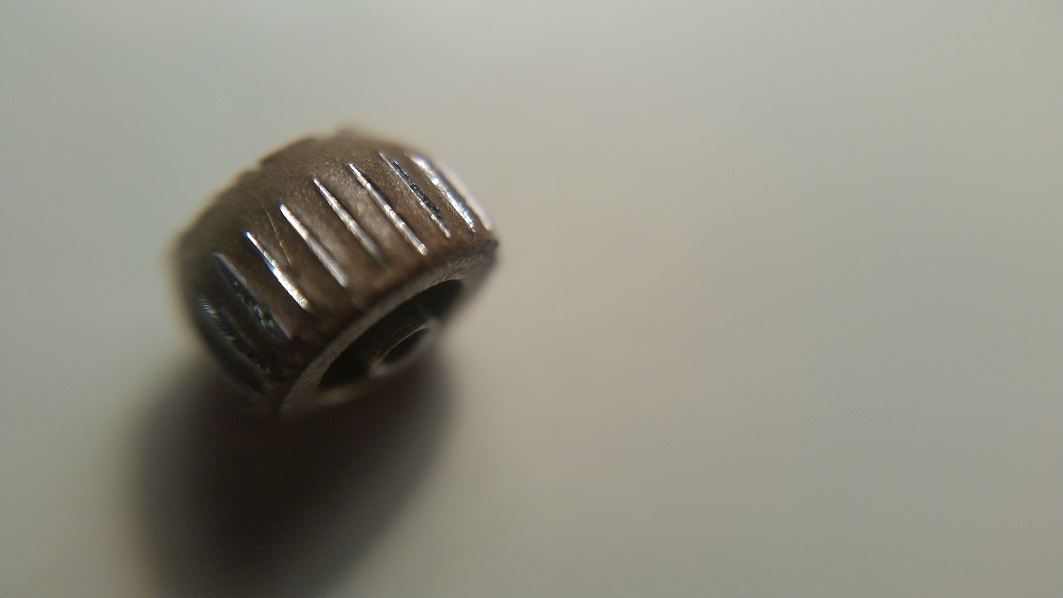

I have a watch with a very basic waterproof crown with a flush post/hidden gasket.
I've read elsewhere that the best thing to do is to simply replace these types of crowns.
However, I'd like to somehow waterproof my watch without replacing this crown.
I'm (likely naively) wondering if i can replace the post to a japanese-style post to waterproof, or if I can use extenders and somehow sandwich a gasket between the thicker parts.

It would help if you could tell us what the watch is and post some pictures, then tell us a little about your knowledge / ability. Some watch manufacturers have unique crown types which are difficult to replace. Some use very standardised parts. For some it is possible to get new replacements, for others it’s almost impossible.
Here are some photos! I attempted to take photos of the inside of the crown but its proving to be rather difficult.
I'm a complete novice, but I am willing to take this to a skilled watchmaker or slowly take the time to learn/practice to get this to work.
This is a very cheap but personal quartz Wenger Swiss Army (70181) that I'd like to try and keep original externally.
I'd like to be able to waterproof this crown without needing to get a new crown altogether.
Is there a way (I'm open unorthodox approaches) to add gaskets on this to restore the 100M water resistance?
With some bent pick, clean out what remains of the gasket inside the crown, try to measure it the best you can and order a replacement from Cousins UK. Or replace the entire crown. There isn't anything else that you can practically do.

Meanwhile, back at the original question, I think it’s important to establish the objective, and then clarify the options and outcomes. The OP describes an ambition to get back to the original 100m waterproofness, so let’s look at that.
JDM’s answer above is about the extent of it.
If you can find an accrediter repairer who has a Wenger parts account, they may be able to obtain a new crown with the Wenger logo on it.  They will fit the crown using the correct grade of loctite to attach it to the stem, if necessary, they can replace the case tube, they will lubricate the stem and seal with the correct lubricants (both different), refit the stem and a new caseback seal (also lubricated), and then pressure test to confirm all is good.  My guess is that this would cost £70 to £100.  If the correct crown is not available then a similar style generic one could be fitted and the cost could be a little less.
A quick google search suggests that someone like InTime might be able to do this.
It is unlikely you will find a repairer who is willing to fiddle around with trying to replace the crown seal.
If you want to tackle this yourself then you have the choice of trying to find a replacement o-ring as JDM describes, or a generic crown. Loctite is optional, but adds security against the crown coming off, so I would reccomend. A pin vice is preferable to hold the stem, but smooth jawed pliers would do for a one-off. Silicone grease for the seal is recommended, but you could get away with not greasing the stem. So you should be able to do all this for around £20. You may need to shorten the stem or pack the hole in the crown if it’s a little short... read the sticky thread on fitting a new stem. Let’s assume you don’t want to spend hundreds or more on a pressure tester, so you will be guessing that all is good when you've finished.
