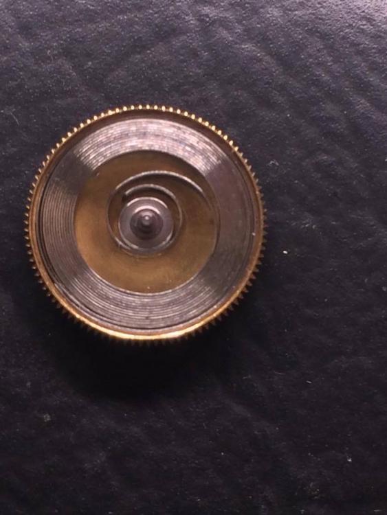

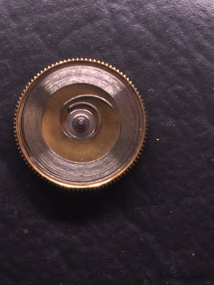

I had to replace mainspring on this ETA 2782 but after I fitted it into the barrel I found out that the end of it does not engage with the hook on the barrel arbor.
I guess this can be fixed by adjusting the final turn of the mainspring so my question is: what tool to use? I found variety of pliers on Cousins but I'm not sure which are suitable for this kind of job.
Thanks for your advice and suggestions.

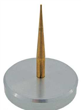

If you close the final curl make sure you have a round centre support or it will collapse. I use a Balance Bridge Holding Tool which helps me gauge the progress.

Be careful not to put a straight line bend at the point away from the arbor end where the slot for the barrel arbor is cut from the mainspring. It will almost certainly fail when wound a few times. That area needs to be a smooth curve to maintain strength.
I have an assortment of piano wire I use for re-pivoting clock arbors and I select progressively smaller diameter pieces to use as a mandrel when bending the curve. Round bar stock works well for larger barrel arbors, but lately it seems all I get is 5''' ladies bracelet watches.
