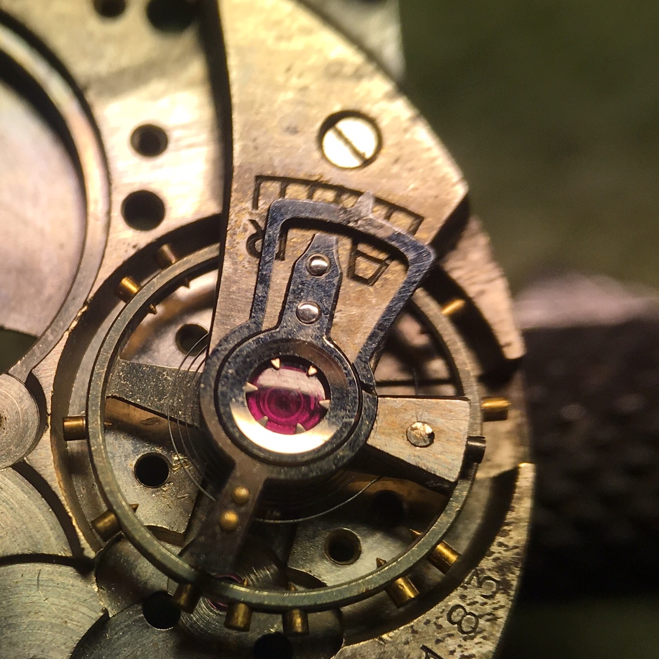

I recently encountered this type of shock resistant design on a Tissot 27 movement. I suppose this is pre-inca early design ?
Any advice available how to remove the cap jewel on the balance side?

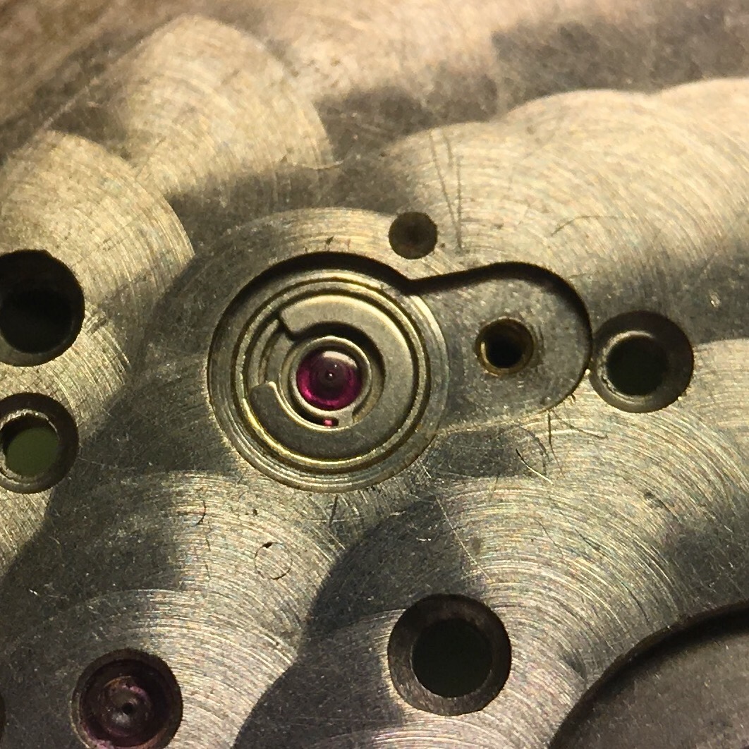

On the dial side the cap jewel can be taken off and the jewel below is exposed. I suppose it can be cleaned as it is but if there's know how around on the dismounting procedure, I would appreciate it.
I know my memory isn’t what it used to be. I think under the balance cock you will find tiny screws that hold it in place. You will need to remove the balance complete in order to get to the screws.
Thanks oldhippy, will check.
So it could be the tips of those screws that are visible on the part sticking out from the cap jewel holder?
And it was... two tiny screws from the other side of the balance cock holds the part in place. I must say that I prefer the Inca design. I can't help wondering why the screws had to go in from the other side of the cock...?

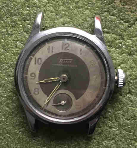

Below is a picture of the assembled watch.
The dial isn't much to write home about, but for now I'm happy that it ticks along and I proved my theory correct about the balance staff being the wrong one. Those things need to be pretty spot on to do their job...

@praezisfrom th picture it apears that the entire bottom jewel assemby is caught in a round metal piece which is friction-fit in the mainplate. I would have tried raising that.
My picture is probably misleading as it doesn't show the end stone that is fixed in a small metal plate that fits in the recess visible in the photo.
Had this been an inca-type device with jewel and end stone integrated as one item, I would assume pushing the entire setting in might have worked...?
Some - only few afaik - Incablocs may be pressed without a stopping edge. But if the staff is wrong, usually the calibrated parts of the staff, that stop the displacement by shock, are wrong, too or missing at all.
