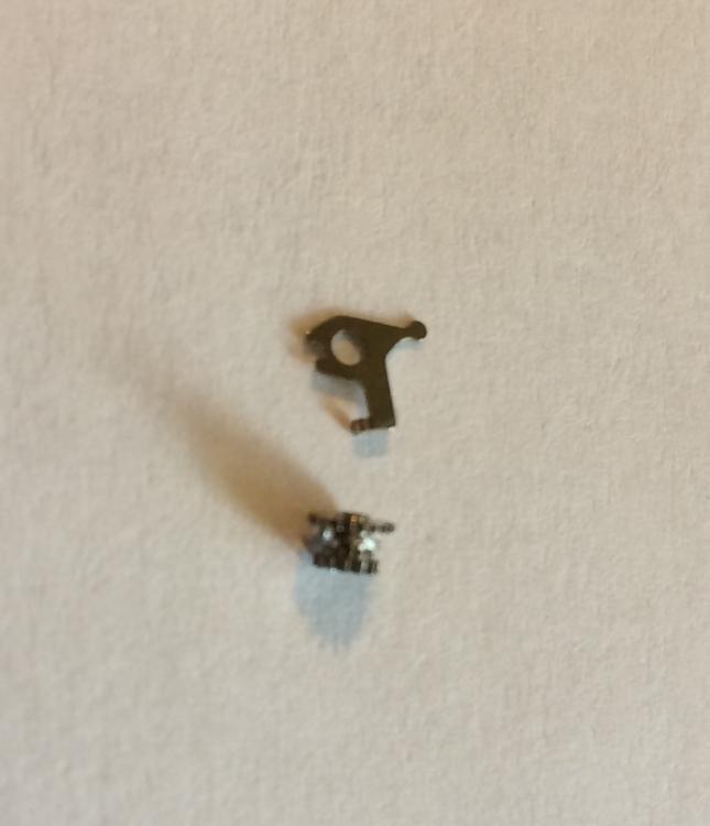

Hello guys, I don't know what happened here. Today I removed the movement from a watch with this 2813 automatic movement, it features second hand hack. I removed the rotor and then I glued a dial in a correct position (it was askew), I removed the feet from the dial and then glued it on the movement with a tiny bit of super glue. I am positive the glue didn't go in any wheel or something. However now this is what happen: The second hand hack is gone, the position for winding is gone too. I can set the hour but when I screw in the crown at the end the setting of the hour engages again and the hands go backward. I tried to remove and refit the stem several times to no avail. Any clue?
Also, the rotor moves freely in one direction and less in another, it kind seems that it's engaging the winding directly.

Sounds like you have dislodged the setting lever.
Unfortunately the solution to this requires removing the dial... which is just one reason why it's not a good idea to glue them on. Assuming this is a calendar movement you will also likely have to remove the date wheel. Watch out for the springs!
The rotor will feel slightly stiff in one direction and free in the other as most of these chinese movements only wind in one direction. As long as the rotor winds the watch under its own weight in one direction then this is normal.

I detached the dial, a tiny screw fell off from under it.
Edcqck9.jpg?2
For me putting the hacking lever back in the correct position was a bit hard. As i remember there is enough room to put it back in the wrong order. I had to understand how it works and then it was all clear how to reassemble.
The movement is meant to be simple so the plate holding the hacking lever has multiple roles.
You should also reassemble the setting mechanism with the stem in place.

So I disassembled the part, does anyone sees where the hacking lever is? What should be done here?

Ok so I understood where that tiny screw was coming from. I reassembled but I am not sure it's working nor setting all the three positions.
Well done so far mate, but as a previous member said, the hacking lever is actually on the train side of the movement, you will have to reassemble the calender side and go in from the other side. It is actuated from the setting levers where you are at the moment but it is actually a small thin ( hairspring thin ) bit of metal that almost looks like a bridle on an auto mainspring. It is located on a post and one end is pushed by a setting lever whilst the other then in turn touches the balance wheel and stops it swinging.

You are suggesting that I need to remove the back plate again? it was a nightmare to fit it back in.
Where is this lever in the picture? I don't see any lever, I think maybe in this movement the hacking lever is on the other side. I will take another picture.

I see, well, what am I supposed to do with that? It seems to me that part is not movable and should be this on the other side:
The hacking lever should be under the clutch lever.
In all the time I've been working on these movements I have not come across anything I'm afraid, they are all similar but again all have small differences. I apologise for possibly sending you a bum steer on the eher the hacking lever was located, I haven't come across one that hacks from the stem area, only from the train side as I said.
I got it, it was not a lever but the clutch being disengaged to some lever, you can see it in the picture. However current status is: tiny spring jumped somewhere and disappeared.
Spring found and refitted (I think it was the hacking lever/spring). Hacking now works but still there's something that is not working correctly. There should be three positions, unscrewed nothing should happen, mid position should wind the watch and all the way out hacks the second hand and you can set the hours/minutes had. What happens the movmt winds when all the way in and nothing happens in mid position.
I think the problem resides here, what is the role of that plate and how does it go on the clutch? Why the clutch has an inner part that is freely moving?
