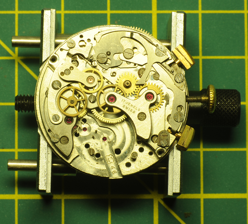

Good news ....... the Landeron 48 arrived today !! In reality it was even better looking than on the pictures and the hands were less bend than I thought. All seems to be within my capabilities .......... I hope :jig: We'll see... ;)
Here my own pictures, but unfortunately, due to the artificial light, not a whole lot better than the sellers pictures......
The chronograph functions seem to work fine and, maybe my wishful thinking, the balance-wheel showed attempts to get back alive agian. However, upon further inspection the first Gremlin stuck his head out off the winding hole.

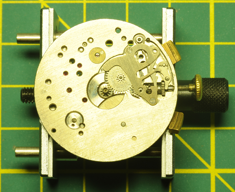

The Landeron stripped off its chronograph components, screws replaced. Next is the removal of the barrel-bridge and the wheel-train bridge.

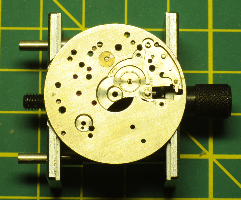

With all the wheels removed, except for the center wheel, the movement is flipped over. I don't have a fancy cannon-pinion puller, so I use brass tweezers and the main-plate as a base for the leverage. Thereafter off with the keyless works again.
Main plate empty......... so far I haven't noticed any obvious broken parts. Slight surface rust on some screws.

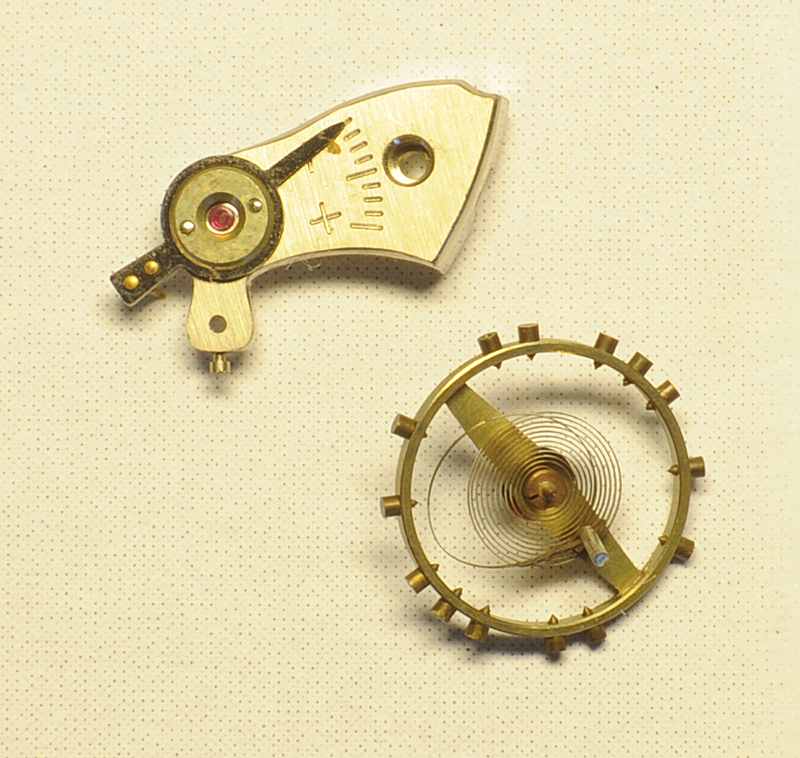

Put some tension in the spring and tested the pallet-fork, all looked very promising. I went ahead with installing the balance assembly, but noticed that the hair-spring wasn't happy at all. It was twisted (touching the balance wheel), out of center and had a kink . No way this was going to run. Disassembled the balance wheel and as you can see, it isn't happy;
Current status is that the kink has been removed, but this hairspring needs much more attention;
The plan forward is to lift the hair-spring off the balance staff and start repairing it. This will be my first serious hair-spring disablement and repair......... not sure whether I should feel happy :thumbsu: or sick :sick:. Either way, it will be a nice learning opportunity

After watching the video's I commenced operation "hair-spring".
I couldn't get the hair-spring off the balance staff (the collet was too close so I couldn't get the hands levers underneath). It had to be done in situ. I managed to get the spring back in a horizontal plain, pretty concentric and made a proper end-curve for the regulator.
Next is to test the hairspring alignment to the regulator path (see 2nd video).  To see if the roller jewel is in beat, i.e. in the center of the banking pins, I have to disassembly the watch partly and install the balance assembly. Make adjustments to the spring collet if required ........ but that will be for another day ...... this was enough adrenaline :nurse: for today.
