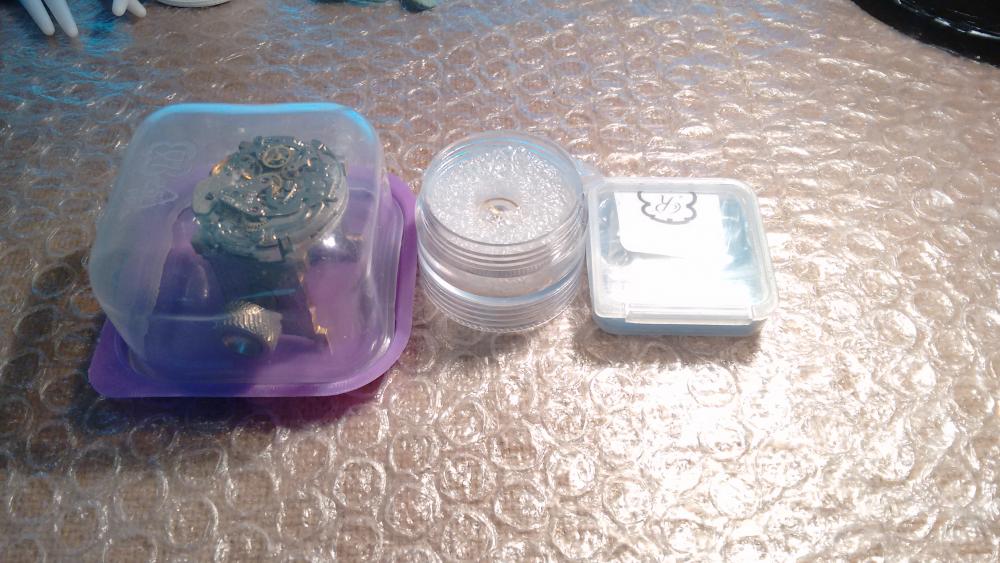

And today I received the third movement, which is almost complete except for the balance wheel and balance cock(or balance bridge if you will).
Here's a pic of what I received: the almost complete movement on the right, a not so bad case and its back cover below, and some goodies inside the plastic box...
The plastic box contains another white dial with English writings, hands, the pallet fork and its screws, the stem and crown and the glass for the case, that I fear though belongs to another type of case since its border is too high. Pictured below the two white dials: on the left the dial that came with the Admiral on the right the new one. They are almost identical, where it not for the English writing and different font for the Roman numerals.
A close up of the movement, which is not so dirty as I expected to be, shows that, considering the style and position of the markings on the chronograph bridge, it was probably made around 1991.
And.... the third movement has been cleaned... and will be, without the parts that I need to use for the Admiral Watch, put back together. At the moment I am checking all the parts, one by one, to asses their status. I already saw that a couple of parts do show some rust, unfortunately.
