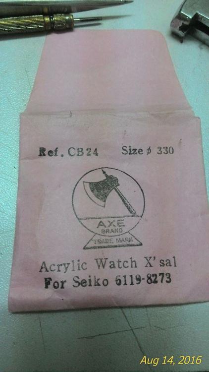

I was looking thru my parts stash for a 330 crystal I could use and found this..This would have been a typical replacement crystal here in Asia back in the day and has survived well. Not surprising it is the correct size and shape as its marked 6119-8273 on the packet!
Crystal install went without any drama as the gasket was still serviceable.

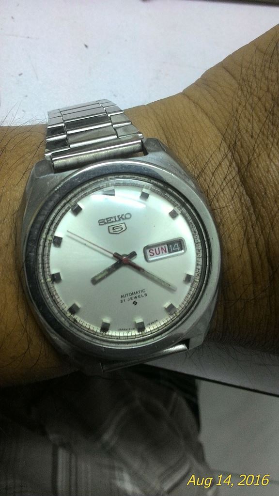

Sides were polished to get rid of the many little scratches.
And here it is on my wrist! Couldn't do much about the condition of the chapter ring but at least its aligned properly!
I really enjoy rescuing these watches and giving them a new lease of life. Hope you enjoyed the pics.
