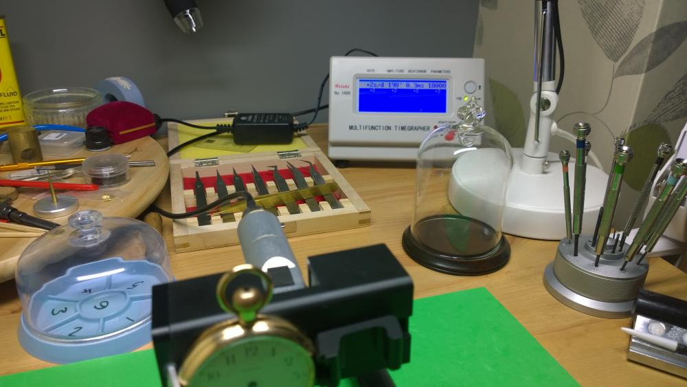

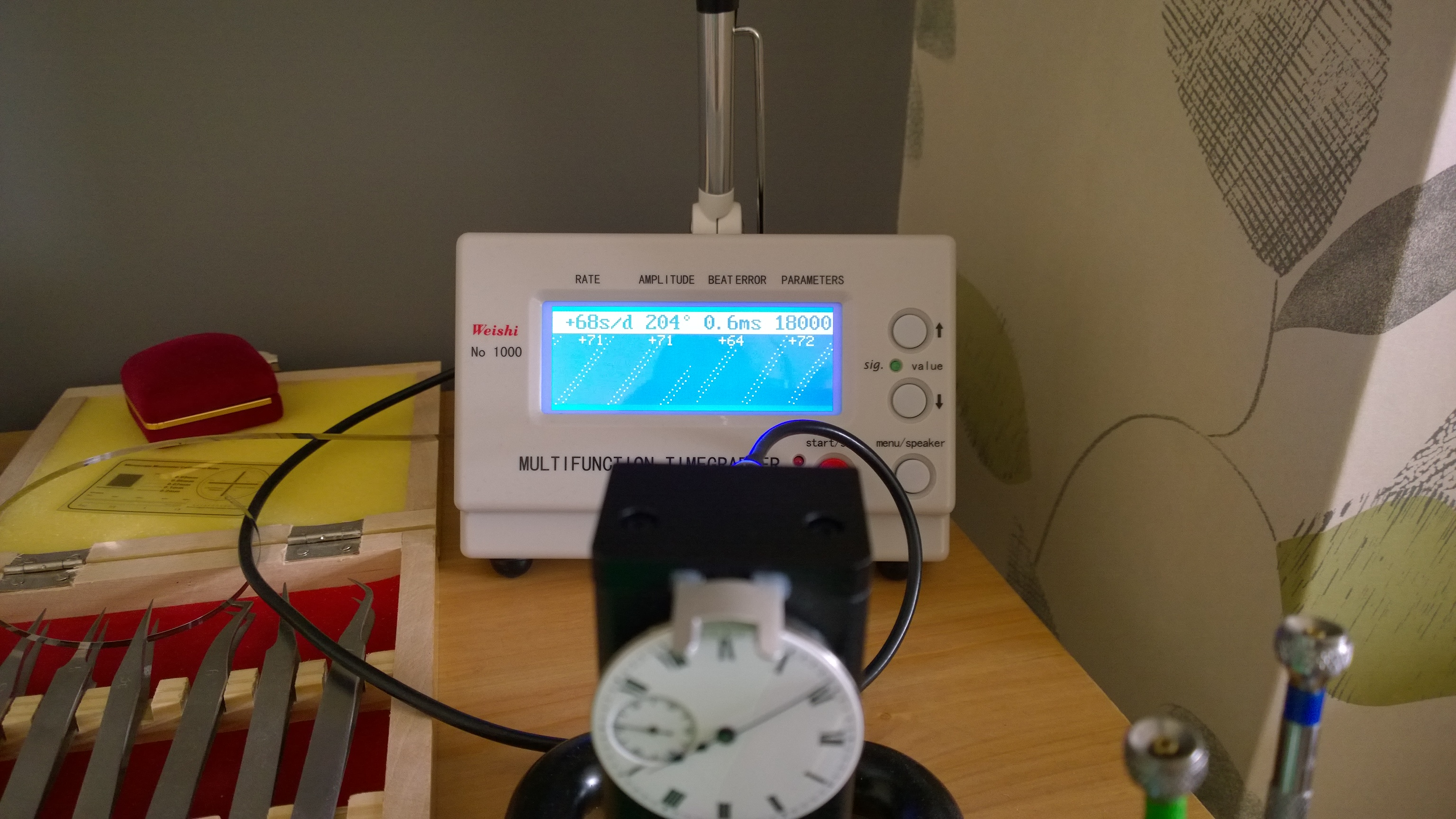

If the lift angle is not set correctly on the timegrapher the only difference is a very minor inaccuracy in calculating amplitude. Nothing else is affected.
No I couldn't really agree with your statement. The lift angle setting not only affects the reading of amplitude but it also effects the reading of beat error. Though I appreciate that most modern movements lift angle is between 48 and 54. So a fairly accurate measurement can be taken at 52° but it's far more desirable to have the specific information as to the correct lift angle setting when regulating a movement
Sent from my SM-G920F using Tapatalk
The beat error is not affected by the setting of lift angle, imho. Witschi manual describes the beat error computation. The LA is only used for amplitude calculation.
No, lift angle set on the timegrapher does not affect beat error reading at all. One can test that easily by varying the angle and observing. See pictures for the two extreme values of range available on my machine. Only amplitude reading is marginally affected.
2 minutes ago, matabog said:
You just had a timegrapher near by, hadn't you? ;))
I don't even turn it off mate. Mrs jdm does, however :biggrin:
Edited by jdm
Looking at your readings I would have to agree with you . There's noticeably no difference.
I don't even turn it off mate. Mrs jdm does, however [emoji3]
Because I believed i could get a false reading of beat error if the lift angle wasn't set right I spent many hours regulating this Waltham pocket watch. I've just put it on the timegrapher. See pics. It's not perfect but you've just made my life a lot easier in the future. Many thanks482ea9fcab0efe841d8b7474045bfc50.jpgd4d734eff6fcfed9695424ce353cfe02.jpg
