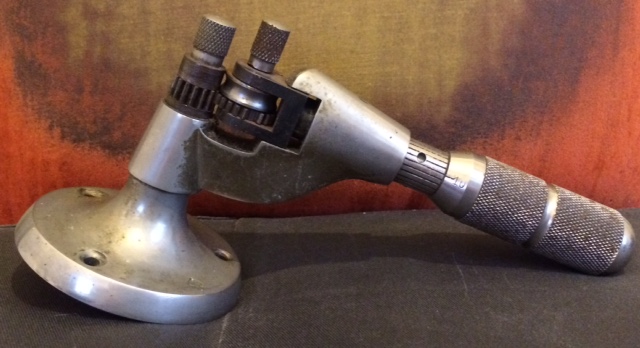

1) Well this is a the watch opener tool, pretty much the reason why I bought them.
Not sure what make it is though, no markings, and I think some bits are missing.
The pins I think some from other sets will fit in fine.
But the bases I'll probably have to make.

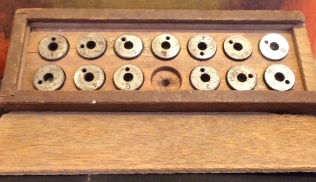

Picture 2 Is the interchangeable rings that goes with tool from picture 3

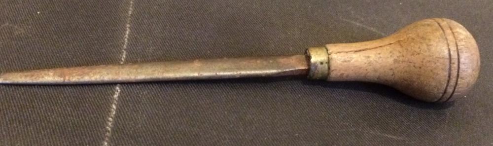

Picture 3 Ring sizing stretching tool for rings without stones, such as wedding rings. The idea is to find the right width to fit the ring by changing the one on the right, the ring to be made bigger is put over the left side and in line with the right side, screw the thing close to the ring to be stretched then move the tool by tightening it and keep moving it back and forth. What will happen is the gold will stretch and increase in size.
