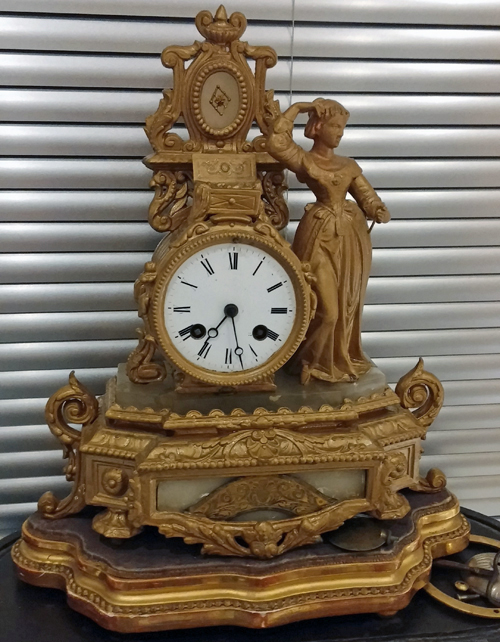

A friend threw this thing at me recently:
Bought at a recent car boot sale for the princely sum of £10, it also has a glass dome (not shown) in good condition.
The bad points:
1. Lots of thick gold paint.
2. The figure is missing something in her hand (a mirror?).
3. The alabaster base is cracked in several places, with a section missing at the back.
4. The alabaster on the front is cracked, too short on the sides & has had a non original brass plate fixed to the front.
5. Hands are rusting.
6. It looks like it's taken a few heavy knocks in the past.
7. The sub base is very poor, worn gilding, moth eaten velvet & cracked.
8. Very, very dirty.
The good points.
1. It runs.
2. err..
3. that's it.
Right, lets see what we can do (a polite request to the conservationists among you- look away now, you may not like what you see!)

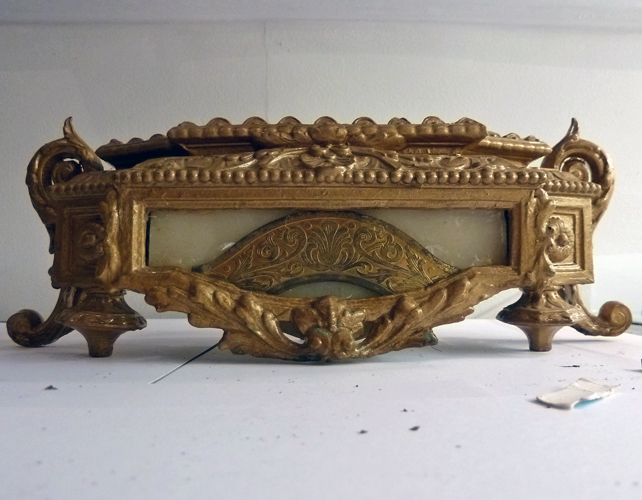

Movement out and seen from underneath the previous attempts at repair:
The studs holding the figure & the clock case to the base have been replaced with various odds & ends. The base has had some interesting repairs with epoxy:
Copious amounts of gold paint:
The base with the ill fitting stone & brass inserts:
After stripping with Nitromors, acetone & an old tooth brush, were back to the original gold plate (what's left of it). The holes in the treasure chest will be filled with epoxy:

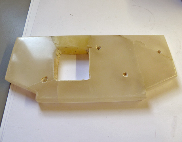

The cracked alabaster base is soaked in acetone for about a week to remove the old epoxy then resembled using clear epoxy:
The missing section is remoulded by laying the item face down on baking parchment, fashioning a couple of dams out of old Rodico & filling with epoxy (Araldite in this case):
Mould removed, more clear epoxy applied to fill the cracks. Also the front stone is extended using the same method:
Filled & sanded using wet & dry papers. The colour match on the front piece was adjusted for a better match by adding a little more of the clear Araldite. It looks like it originally had a couple of rosettes fitted:
Given a further polishing with diamond impregnated polishing pads it begins to shine, unfortunately alabaster is almost impossible to repair invisibly so we will have to live with the cracks. It is however somewhat more stable:

The case was originally (very thinly) gold plated, showing the copper base coat & spelter in places. As electroplating is too expensive, gilding using gold leaf was attempted first but the colour was far too bright yellow, so the case was repainted using a couple of thin coats (to preserve the detail) of Rustoleum brilliant gold (Valspars equivalent was also tried but looked to brassy). New screw studs for the clock case & figure closely matched to the original ones still in the figure were sourced from www.ba-bolts.co.uk . The alabaster stone base inserts still looked a little dull, so were given a thick coat of clear acrylic high gloss varnish. The non original brass plate covering the front alabaster insert was replaced with 2 brass rosettes from Cousins & painted to match case. The gilt sub base was sprayed gold & the fabric recovered using purple dressmaking velvet with gold rope trim. The wood main base (not shown in the final pics) was cleaned & french polished. Movement regulated. Dial cleaned. Hands re-blued etc:
..........and this is what it looks like now:
