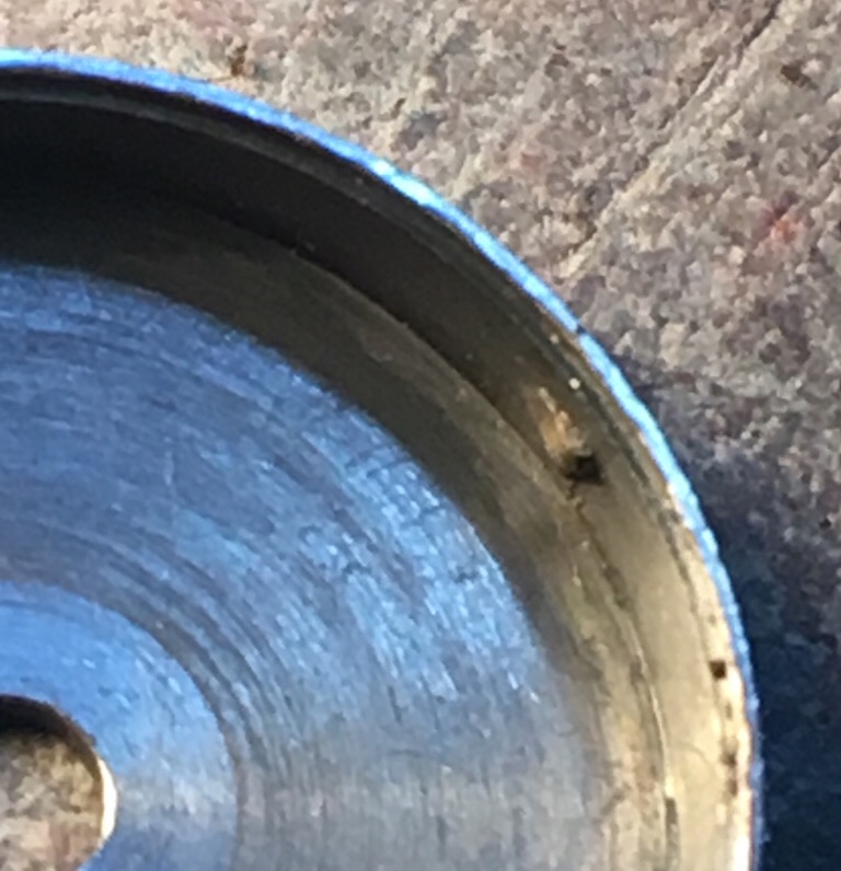

anyway, I am looking for help with an old 1941 military issue 6E/50 pocket watch
the watch winds with a decent tension, but then there is the faintest click noise and the tension seems to drop. The watch will only run for about 4 hours before stopping.
I am guessing it's the mainspring, but my previous experience with mainspring issues is no tension at all.
the movement says 15 jewels, Swiss made, 30. There is no brand name anywhere on the watch.
thoughts most appreciated.
My suspicion is that the mainspring is slipping from its attachment inside its barrel. Some mainsprings are attach with a hook-like tip. It could be that the tip is deranged, and cannot hold in place when the spring is tightly wound. As it slips loose (with a click), the spring expands in diameter, reattaching to the inner barrel with less tension, just enough to run for four hours. If I am correct, you will need to repair or replace the mainspring.

+1 @Swordfish. MaIn spring slipping from hooking point on barrel or possibly from the arbor hook (unlikely though ).

Time for a new mainspring!
Looks like the bridle has broken off the outer end and someone has softened the end of the spring and folded it over instead of fitting a new one. The outer end of the Spring (at 3 o'clock in your photo) should sit firmly into a step in the outer wall of the barrel. With a proper welded bridle, that short section that doubles back sits flush against the spring and the barrel wall. As the Spring end is soft, it has bent over and won't firmly in the step. (Unless you have any holes in the barrel which would indicate a different type of bridle)
The arbor end of the Spring should wrap more snugly around the arbor too.
Best way to find a new spring is to identify the movement, and order by movement type. If not you will need to measure up the old one.

As Stuart says, the hook on the outer end of the main spring is the problem. A new main spring is required.

Just wanted to say thank you for all the help, the spring arrived today from Cousins and the watch now has a beautiful strong heartbeat once again
