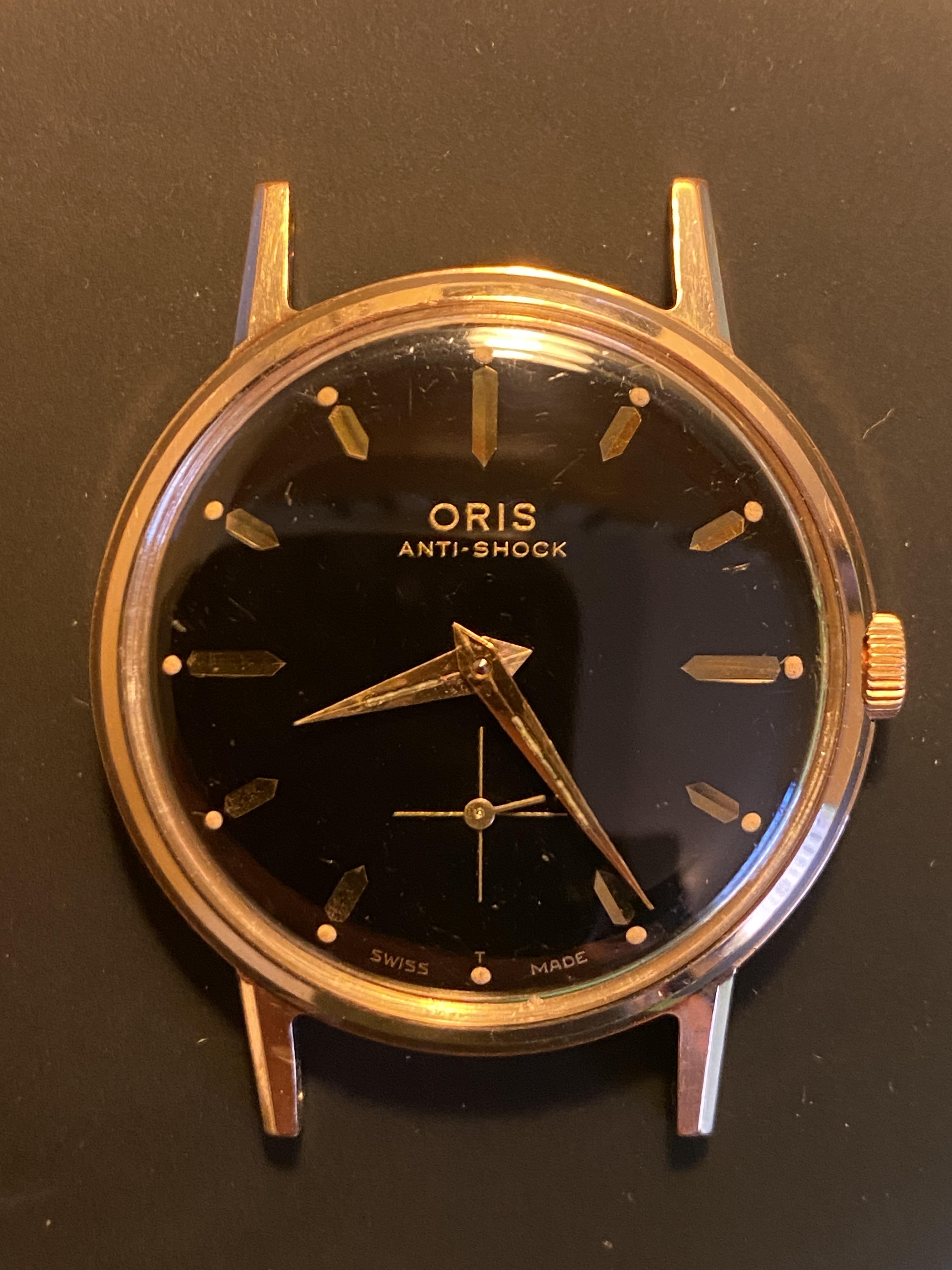

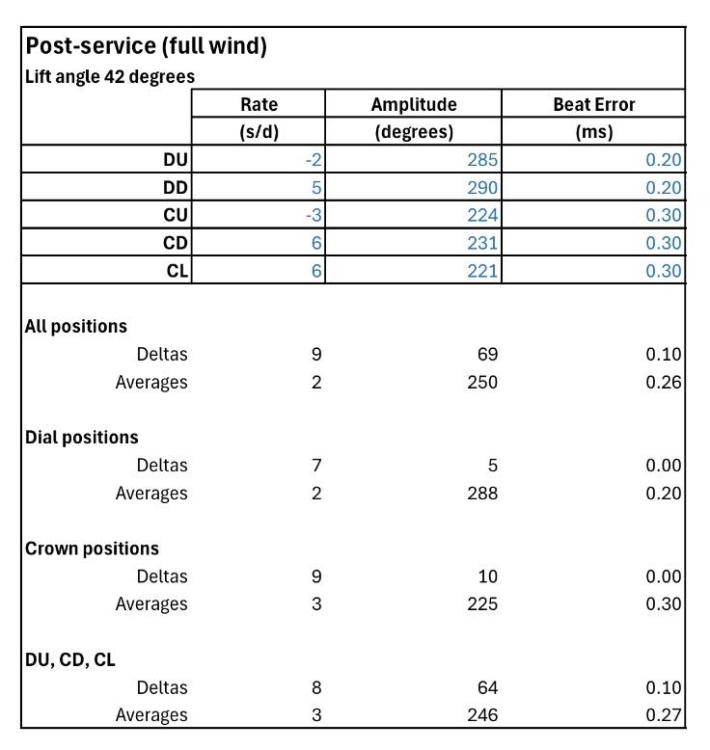

I have just cleaned and lubricated an Oris seven jewel pin pallet movement. It was not running on arrival and now, to be honest, I’m pretty pleased with how it’s running

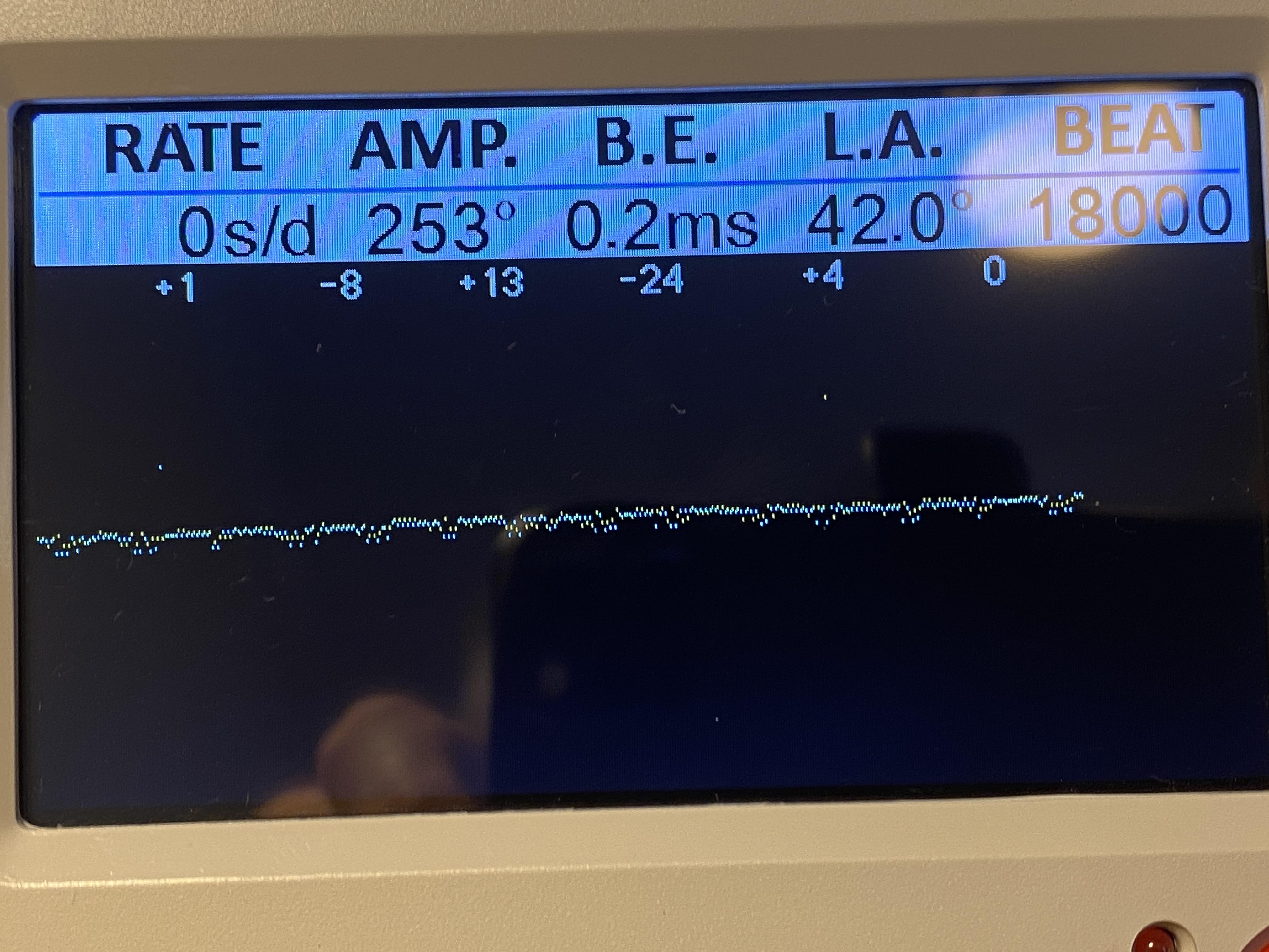

but the timegrapher trace looks strange. The trace is a bit noisy and it seems there is a repeating pattern. It looks to me to be repeating every 5 or 6 seconds. Could this point to some issue with the escape wheel perhaps?
Im going to wear it for a while and see how the real life performance matches with the timegrapher results but it looks like somethings is t right so I’d like to at least understand it, even if I can’t fix it yet
Grateful for any insights. Thanks.
edit: I should have said that this trace is dial-up about 8 hours after a full wind and all positions have a similar pattern

Definitely the timegrapher trace points to something with the escape wheel. If you have been running the watch less than a day, let it run another 24 hours. A little periodic blip like that could be too much or too little lubrication on the escape wheel teeth if it has not distributed fully yet. Little disturbances to the trace like this often tend to smooth out after a couple of days running.
But if you have already been running it for a few days, the lubrication should be distributed. And this could then be just something like speck of dust on one escape wheel tooth or a tiny bit of debris or rust in one of the escape wheel pinion leaves. Since the disturbance lasts for 5 or 6 beats of the balance, I would look closely at the pinion leaves - that seems more like it is interfering with interaction between the escape pinion and 4th wheel than if it were interfering with the pallet stones and escape teeth.

It’s been running for a couple of days. I’ll let it run for another day and check it again - I think I was a bit clumsy with oiling the escape wheel teeth so maybe I overdid it.
Very interesting information about the escape wheel pinion. I will take a close look at it (or as close as I can with a 12x loupe) and check for debris or rust.
The movement was completely filthy when I first opened it (hair, fibres and some small metal flakes which I think came from the ratchet wheel, which is missing a couple of teeth), so I may strip it down and clean it again!
I definitely want to get to know more about what the timegrapher says about what’s going on inside the movement, and not just how fast/slow it is running.
