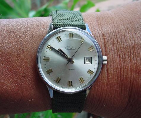

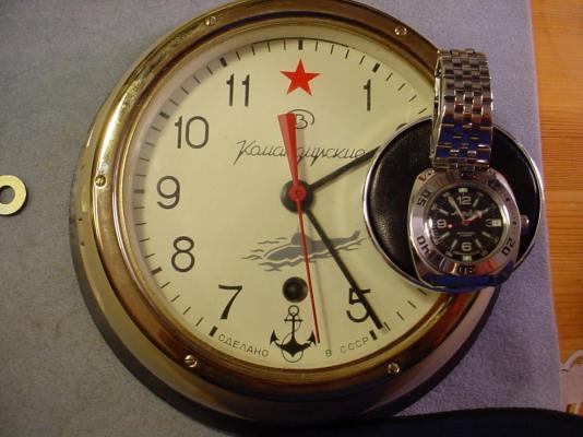

Nice clean watch you got . Nice price too . I have a few Russian watches and I have seen the prices go up in the last year as they get more popular .
I have a Vostoc ships clock ....next to a Vostoc diver .
 I put a Slava watch on a Green canvas strap that seems to suit it . The Slava has 2 mainsprings btw .
