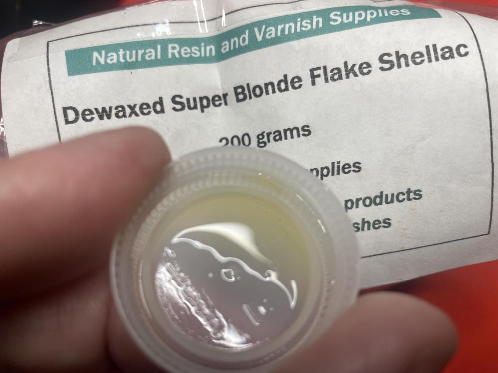

I've just tested the IPA again, in case I was confusing myself - I have tried different solvents at times to get away from the purple methylated spirit colour. (I now have industrial type, clear, denatured alcohol).
This is dewaxed shellac in electronics cleaning grade 99.7% IPA; totally dissolved:
It is slower dissolving than with denatured alcohol, but using IPA as a cleaner, it will be dissolving some amount of shellac with each wash.

Yes but not causing rust. The cleaner fluid went a milky colour, never found out what caused it apart it must have been something on the watch movement.
So keep in mind this was my bench solvent i I washed these in and not part of my normal naphtha>Ipa>Ipa>Ipa  wash routine. I used the perchloroethylene bench solvent for shellacked parts due to the insistence that ipa will destroy my shellacked parts.
The only thing that i can think that could have gotten into it is moisture from the air. Basically I took a break from watchmaking my nearly nearly airtight benzine jar for months and months, maybe only half a centimeter evaporated off and i didnt' think much of it and just topped it off to work on this watch.
Not only did it rust two parts but i've been having a comedy of errors with this watch i'm working on and low amp.
It rusted my original balance and pallet fork, but now i'm seeing it also deposited a thick but nearly invisible waxy residue that neither fresh perc or naphtha and a q tip could get off, so that's on my balance cock and probably new pallet fork, hence the amplitude issue.
At the recommendation of my other watchmaking place that has their professionals, iv'e been told to put the balance on the mainplate and put it and my pallet fork through my normal 4 stage wash/rinse cycle.
The rust makes sense to me if moisture got in and settled in the bottom or contaminated my perc bench solvent jar...this waxy residue...i have no clue what this is. Does perc spoil? Is it a reaction between the water, the trace oils in it and the perc?

This has been fiercely debated over the years. As a result of practical experience I’m in the camp of those never letting IPA anywhere near shellac.
Recently someone suggested that only dewaxed shellac is immune to IPA. I haven’t investigated that yet but will eventually do.
