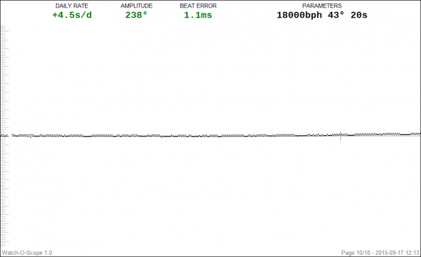

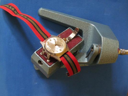

Today I have today been really impressed by Watch-O-Scope v1.1.
I connected my Chronografic mike via a Kemo preamp with only x100 amplification. Amplifier power was from a LI-ion battery. The whole lot was floating on the PC earth.
The signal to noise was fair, and after applying the Watch-O-Scope broad band filter it was excellent. Here is a sample measurement made on a home-built watch with an ETA 2824 movement. The PC clock was calibrated following the instructions in the user manual.
And here is the same watch, dial up, in my Timegrapher 1000. A good agreement for timing but proving my suspicion that the Timegrapher, although accurate for timing, is low on amplitude measurement.
What a nice clear readout Colin, I can see how you are impressed with it. Do you think your timegrapher has alway been wrong, or have the results changed over time?
It has always been low on amplitude and I had assumed the need for more cleaning and oiling or replacement of mainspring (this last I have done twice). But my suspicions were aroused when I made a video of the balance swing and could fairly clearly see that the amplitude was larger than that reported by Timegrapher. Now Watch-O-Scope has confirmed this.

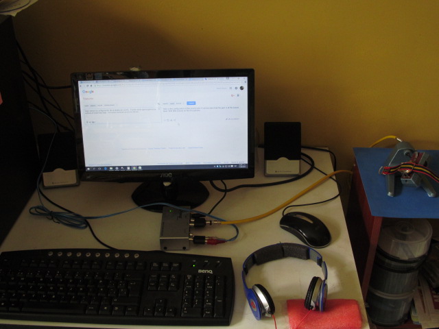

I enjoy visiting this forum. I have learned many things. Now that it is addressing the issue of software Watch-O-Scope, I also want to share my experience with this application.
Here I include some reading I've done with microphones that I built. I also have one of an old machine control clocks.
I tested the performance running on Windows 7 and Windows 10 and is excellent. Here Running on Windows 10.
Regards.
Here are some photos of the microphones I use. Even that is a professional unit "timing machine", I had to change the microphone cable, by one of three two signal wires and shield.

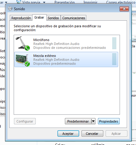

Sound settings in Windows.
Disconnect any microphone.
Go to the sound in the Windows taskbar click the right mouse button and choose recording device.
Enable stereo mixer or similar.
Click Properties.
Enable the LISTEN AND THEN OK.
Run the audio file Calibration.

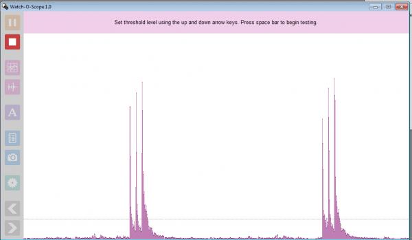

In the Scope mode we can see the intensity and appearance of the waveform. You can make adjustments to the volume control.
When configuring sound sensitivity thresholds should take at this level:
At this level. They climb to where they are the valleys between about peaks.
