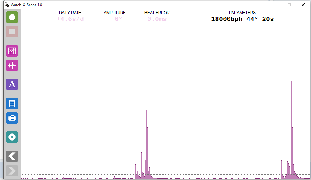

Probably just a slight poise issue, but that timekeeping is pretty good. The dial up / dial down positions show consistent rate which is why I suggested it may be the balance poise by the way.
."poise issue" "balance poise"? Could you elaborate, please? (I am quite new at this, so to speak)
So, should I accept this sample? I have until friday to decide, I guess. It looks great and was an amazing deal (Chinese New Year Special)  (yes, I realize I sound like Trump:))
The lines are a bit "off" here and there, but is that "normal" for a 2D tourbillon, or only for inexpensive tourbillons?
Again, I have yet to see any print from any  €90,000 tourbillon. Please, if anyone has one..?
Hi, yes, balance poise. Poise affects the vertical rates because as the watch (or in your case, also the balance) rotates, the heavier and lighter areas of the balance wheel are affected by gravity which changes the rate of the balance slightly depending on position.
It looks like it will keep good time, so I would keep it. Your easiest way to time it is just to wear it for one day and adjust for the offset in seconds.
If you want to confirm it really is balance poise, then measure again at a low amplitude, say between 140 and 200 degrees; the variations in rate as the tourbillon rotates should be greater.
I consider the performance to be a good one: -1/+10 s/d is not bad. Beat error lower then 0.5ms, around 280deg amplitude.

I would keep it. I don't know if it's normal, but I would consider it acceptable, and I also would expect to see this sort of periodic variation in a tourbillon. Even if the poise of the balance were perfect, is the toubillon cage (and its contents) as a whole balanced? If not, then I'd expect the rate to speed up and slow down as the cage rotates, since first more and then less effort is needed to rotate it.

Yes, once fully unwound (you could hold click from locking the barrel and let it unwind completely) you have to start winding as in one or even half a turn and the balance will start oscilllating. Once it's roughly 180o put it on the timer...

A watch microphone is bound to give better results than the piezo setup. I designed the piezo setup as something that would work reasonably well, and was easy for almost anyone to build.
However, a standard phono preamp is unlikely to work well. A phono preamp amplifies low frequencies much more than high frequencies (because low frequencies are attenuated when cutting a record, otherwise the needle would bounce out of the groove). That's exactly the opposite of what you want.
Also, without knowing the output levels of your watch microphone, it's hard to know how much amplification is needed. I suspect that the microphone already has its own amplification built-in, and simply needs power on two of the five pins of the DIN plug (no idea which two).

I've been using this one with very good results. Have room to go up in amplification in even the most quiet of the watches...
My Achilles heel is my mic. I've shaven the rubber off and it's better but still I know there must be something better out there.
I also have a 5pin Witschi and got adapters to plug it up to the amp but the signal it's giving is mostly noise. Nothing I can amplify and clean with the peace equalizer. I haven't had a chance to fool with it yet but I'm interested in following what you get.

Keep in mind that any modern timegrapher (i.e. one with a display instead of paper tape) is a software timergrapher. It's just one that you can't run any other software on.
The big difference, if there is one, would be in the stability of the reference clock. In a dedicated timegrapher, this is probably a very stable, possibly temperature-compensated, oscillator. In a PC-based timegrapher, it's the quartz crystal on your sound card, which may or may not be as stable as that of a dedicated timegrapher. (It definitely won't be as accurate, hence the ability in Watch-O-Scope to compensate by up to +/-100s/d).

Great analysis, now I understand why the beat error increases during phases of the of the graph in the CR and CL positions.
