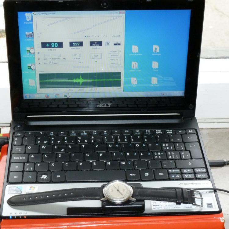

Added a photo of my setup, microphone has the mentioned 1-transistor PA:
Regards, Frank
Hi praezis,
This sounds amazing! I really would like a small amplifier that draws the power from the Mic Bias! No need for a battery and the unit can be made very small.  Any chance you could publish the schematic diagram for your 1 transistor amplifier, including component values, please? Maybe even photo(s)?

7 hours ago, tourbillon said:
Hi praezis,
Hi tourbillon,
no problem:
Frank
Edited by praezis
praezis, I'm going to have to try the 1 transistor amplifier. This won't work with a Line-In connection of course (because it expects a stronger signal, and has no bias voltage), but my current PC only has a Mic input anyway. (On a related note, I've always found Line-In, when available, to be much less noisy than Mic-In.)
