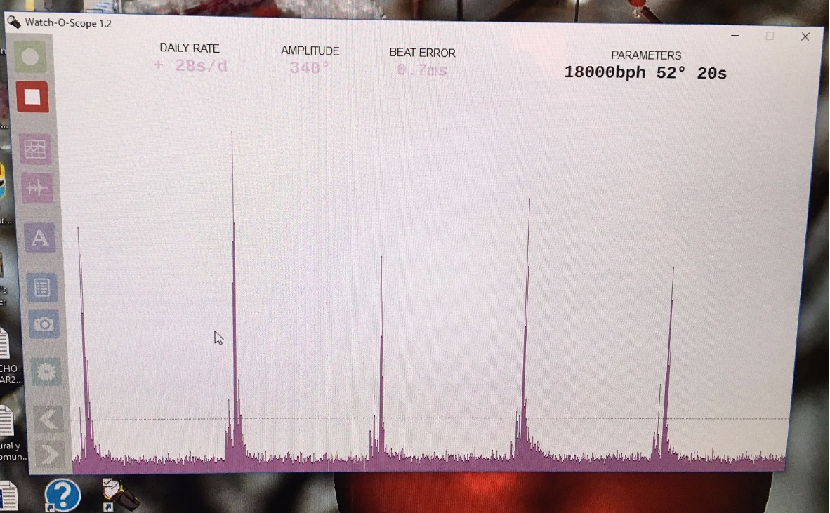

Great suggestion!
I peeled off the foam from the sensor and got better signals. Now I see some waves reaching the top of the monitor.
The beats seem pretty inconsistent and I wonder if it has anything to do with the signal processing. I tied a couple of reliable movements and they too seem irregular. I checked off signal enhancing form windows mic and the strength went out the window so I had to click back on.
The Windows mic signal processing options do things like echo reduction, and to do that, they probably need to mess with the audio timing.
You're right!
The quartz was loud enough that I was able to turn off enhancement and the variability improved dramatically:
Now back to needing more boost but also a more sensitive microphone because if I learned something is that simply boosting a crappy image will give off wave signals that can't be interpreted by WOS...
Great! I think I might need to add a "boost" option to Watch-O-Scope itself. Like any software-only "amplifier", it doesn't really amplify, but just considers at a tinier range of input voltages to be "full scale".
UPDATE:
For the electronics-naive like me, this may be of interest.
Plugging and unplugging a few times testing the system ended up freezing my laptop so I took it to my desktop computer with surprisingly good results.
The soundcard is more powerful in the desktop CPU, I don't know if it has anything to do with power consumption choices for the laptop or not, but when going to the settings menu of the recording devices, the boost for the mic is more than twice what was available in the laptop (went to 30 from 12 dB). It's also important to make sure that all Sound Enhancements are turned OFF.
I also removed the foam cover of the mic and this all resulted in a loud waveform which actually required me to decrease the amp level to about 50% on a reasonably loud watch.
This waveform was obtained with amp at 50%
I was able to test most of my watches this way, although there are still a couple that are totally quiet that I'm expecting to have to open up to test if necessary. I also analysed a bare movement (Seiko 6139B) and the waveform was off the chart needing me to reduce the amp to about 30%.
I'm pretty pleased with the set up. I think it's functional and useful at this point. Now the quest continues to finding the best way to secure the case/movement to test on the 6 positions.
I hope this helps folks trying to set this up.
