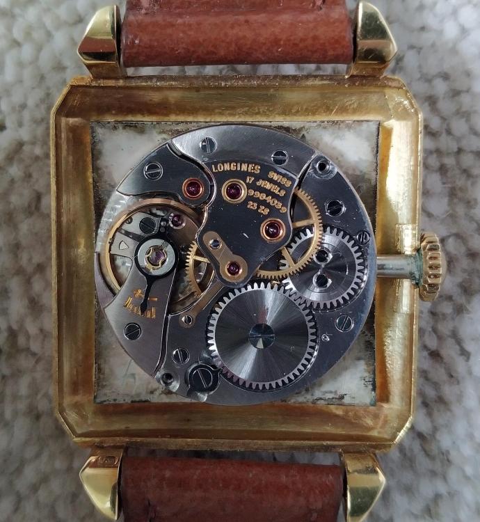

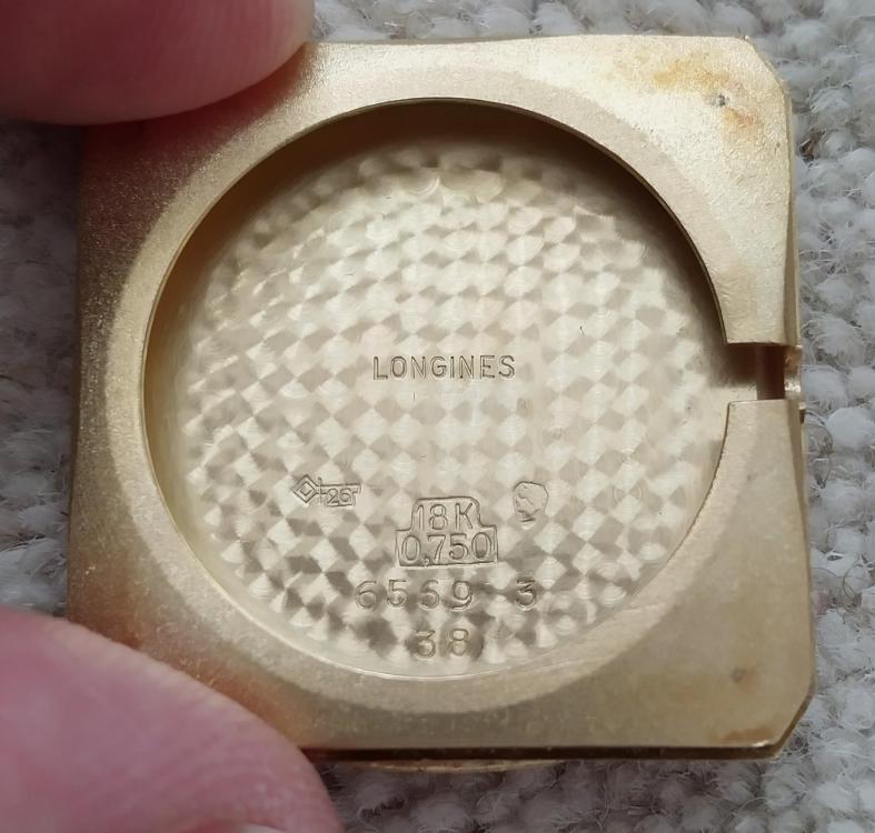

Hi Alain,
My friend in England has shown me a Longines watch which he would like to have cleaned (maybe even serviced). He had some doubts about the authenticity of the watch as a watch repairer told him that it was not worth a cleaning. I am far from beeing an expert, but when I opened it I found out that the movement is a 23ZS and the case could even be made of gold!
Could someone tell whether there is a reliable watch repairer in Dorset?
Here are a few pictures
Definitely gold, with the key of Geneva stamp and a genuine movement.  "Not worth cleaning " etc is code for they weren't interested or skilled enough.  It is definitely worth a  service but I can't recommend anyone.
Who ever gave you that info is bloody stupid. As already pointed out it's 18k. Longines watches are high grade. Go here this is the  B H I site and download accredited watch repairers and look for Dorset.

A Longines that is not worth servicing???  I concur with @oldhippy - bloody stupid advice.  I have a couple Longines and I love them both.  They are extremely accurate and look positively dashing; everything a fine watch needs to be.  And what you have certainly looks genuine from the pictures.  And it looks superb!  A service by a reliable professional should soon have it running in top form.

Second Hand Ladies Longines 18k any thing from £1,000 you have to take into account the weight of the gold so if its heavy the price will increase a lot.

Keep a big distance to that "watch repairer" who said it wasn't worth cleaning. Just look at the "anglage" on the bridges of the movement. Gorgeous and most likely finished by hand! That's nicer a finish than that of pretty much any Rolex you'll find.
