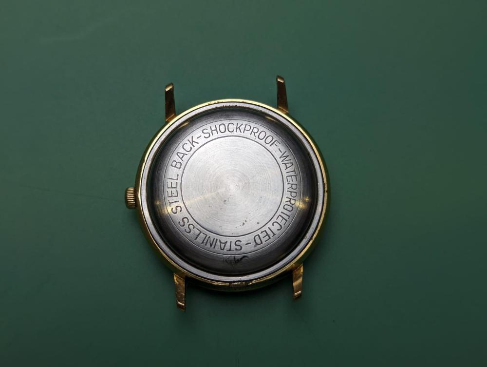

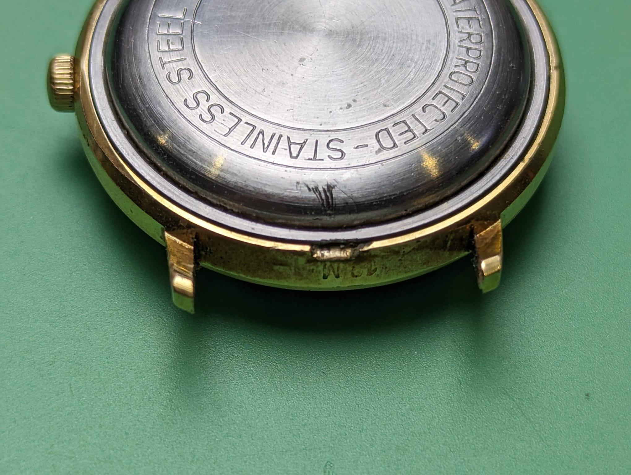

Hi, sorry if i'm being an idiot here. I have never run into a caseback like this before and I am at a loss for how to remove it. The watch is a front loader, the dial is too big to come out of the back. There are no clear notches for a case knife on the back, only a small hole that looks like it could fit a screwdriver. Looks like someone else has tried prying it open which made me think it's hot I open it. I tried prying it with a screwdriver, but felt that if i applied any more force it would just scratch or damage the case so i stopped. I took off the crystal and dial, to see if the watch had a split stem however it does not. I cannot access the setting lever screw from the front so am unsure of how to get this movement out. Hoping that I am just being a noob and the answer is simple.
Thanks in advance for any help.

 You have a gold plated case and stainless steel back (two different metal), this tells me the back is removable.
The one piece cases, ( which I think are called monoblock ) tells us it has to be a front loader.
I would place a piece of 1/2mm thick  cardboard on the " hole" and pry the back plate with screwdriver, the cardboard will hopefully keep the case from getting scratched.
Removing the winding crown might let the movement to come out.

Update: The caseback is finally off! The case knives I have are too large to fit inside such a small indent, and I also sadly do not have one of the screw in tools with a very narrow tip, which is what I most likely needed in the first place. In the end i just forced in a screwdriver with a bit more force that i was really comfortable with and the caseback shot off. Somehow I did not damage the case any further which I am happy about.
Thanks for your advice, next payday I will most likely increase my caseback removal arsenal.
Also for anyone interested the movement inside is an AS 1795

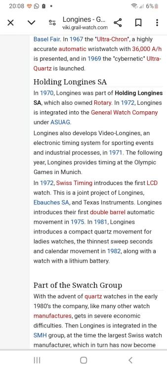

I used to think that ancient history was at the best flakely but modern history isn't so much better.  Personally I think that Rotary and Longines weren't connected but I could be wrong.  Who knows, with all the conflicting evidence ?
The place I worked we were longines agents. I had all their equipment all there service manuals. We were also agents for Rotary. Longines are in a different class. Rotary were bog standard. Again I say they are different and have no connection. Don't believe all you read on the internet.
There isn't much evidence at all to say they were , just that little piece of info , no idea how accurate that might be but i could not find anything else. The two watches are curious though , both claim to be Olympic editions and they're surely from the same factory the design is almost identical with a slightly different case, maybe just a one collaboration that has been made out to be more than just that.
