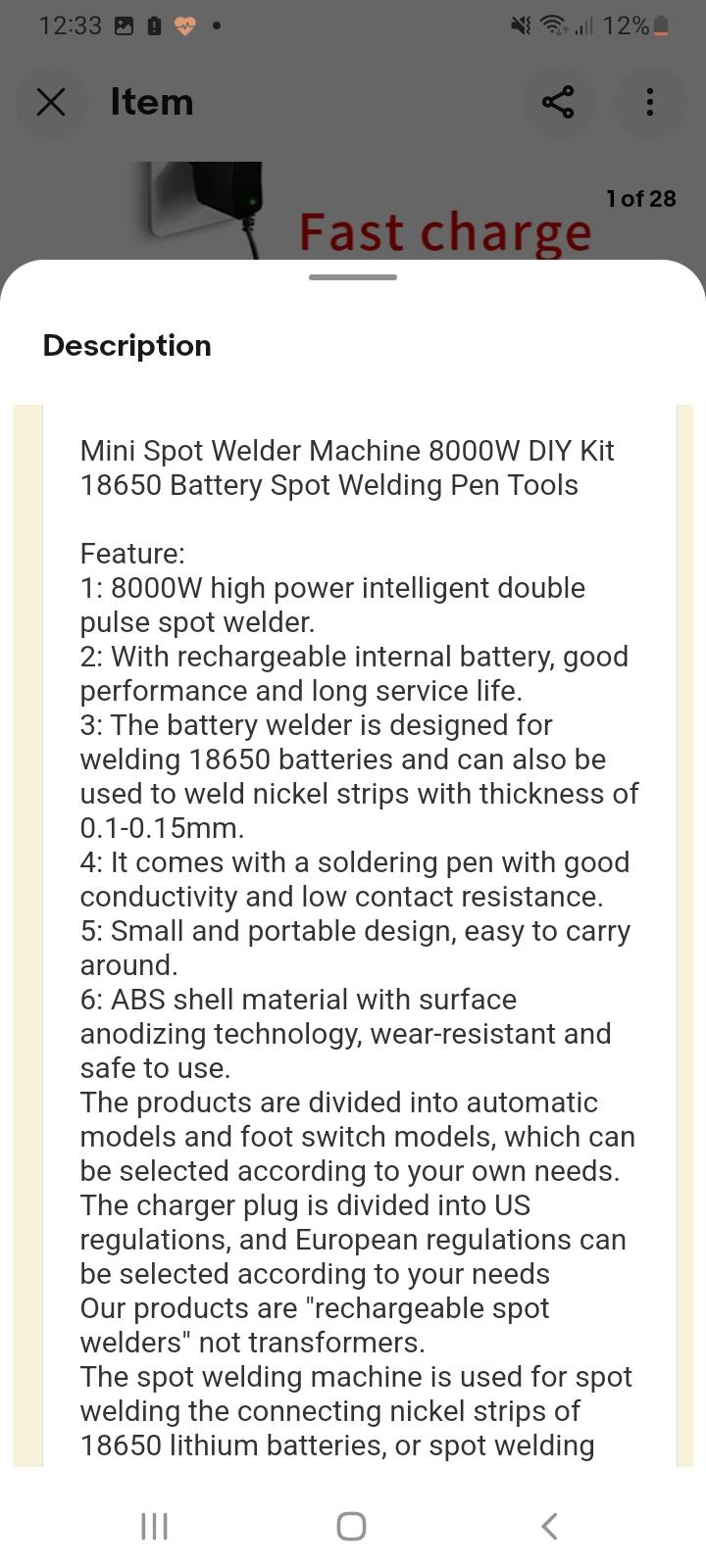

For interest, I looked up spot welders. The cheap ones, used for battery packs, amongst other things, have decent reviews.  Probably not very powerful but should be enough for a mainspring.

🤔 maybe something like this that welds upto .15 nickel strips.
I repaired one of the rechargeable spot welders for my mentor a couple of years ago. It used a flat, 12V lead acid cell, like those found in uninterruptible power supplies.
I was surprised that at the maximum setting, it was more powerful than my dental tabletop unit.
The only problem with these spot welders is the power supply. The battery is so small that it is easy to overcharge it and cause sulphation. And if not charged regularly, it would go dead and short out.

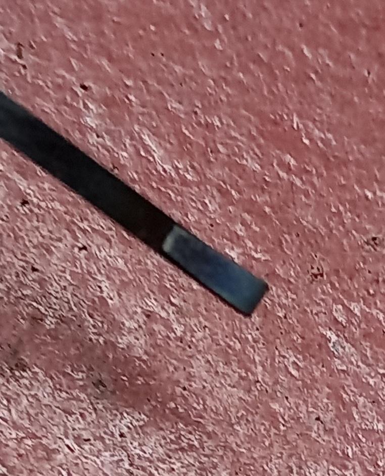

The piece i heated up is really soft, maybe overheated it ? I thought whatever i heat to cherry red and cold quench would fully harden. So anything beyond where it hits red would be annealed ?

Heating to cherry red and leaving to cool at room temperature will anneal the metal.

Experimenting with this piece of spring which has a slight golden colour ( blue steel ?) even momentary heat from a lighter to blue softens the steel enough to bend easily without breaking it so much so that it takes several reverse bends to make it snap. Trying the same with an alloy spring is different again , that stuff needs to reach cherry red.
You wouldn't be able to reharden just the bit that has been annealed, without annealing a bit further along. By the time to get to the center the whole thing would be annealed- except the center! They work fine un-hardened at the end, it's actually less likely to break, and you would almost certainly break something in the winding system before deforming anything.
Spot on Nicklesilver even the slightest of heat anneals this spring.
