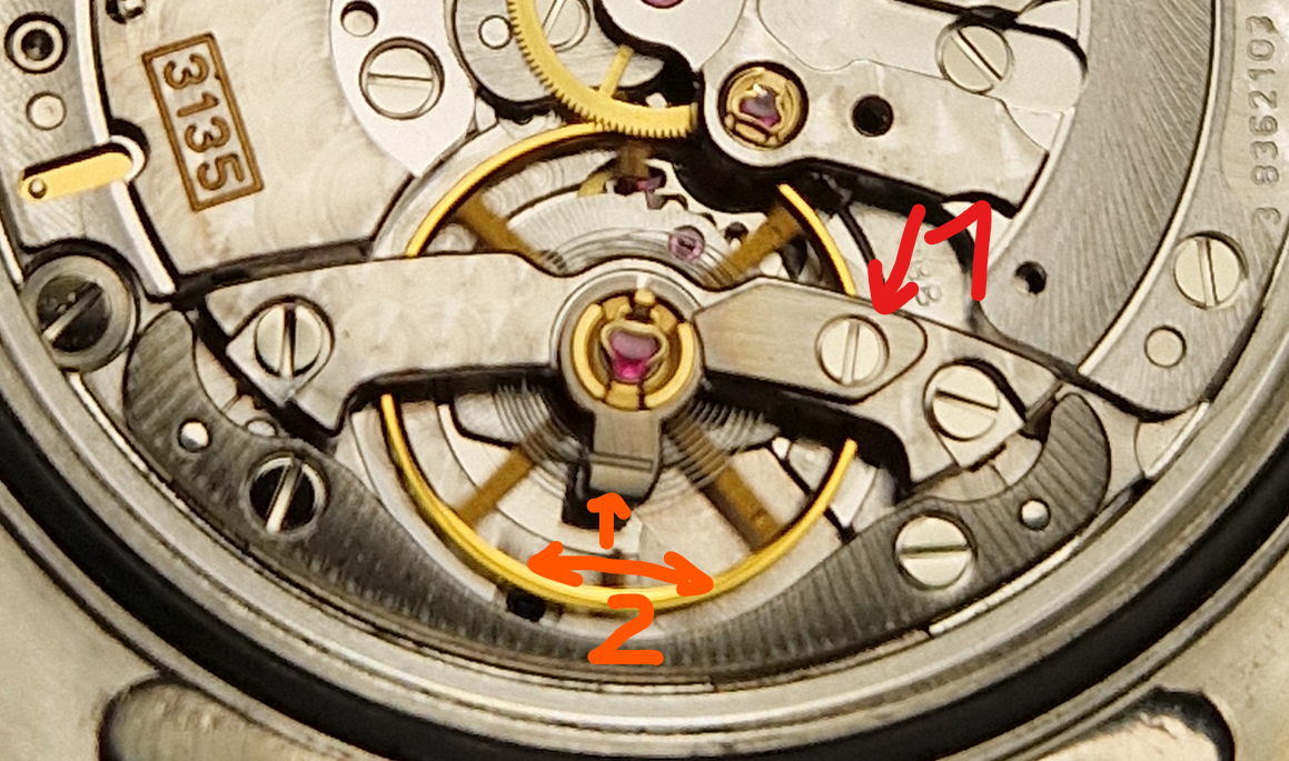

Yesterday a Rolex cal. 3135 landed in my hands housed in a Rolex Oyster Perpetual Date reference 15200. Having analysed its running (fully wound) using @praezis excellent PCTM software, nothing is alarming or acute, nevertheless, my conclusion is that it's up for and could benefit from a service. I'd like to know if someone has a different opinion. Pictures to follow...
However, what is alarming is that the rotor is loose, and unfortunately, I think it's pretty bad as the rotor won't even oscillate when the watch is in a dial-down position and gently shaken.  It also makes an unpleasant metallic sound when the rotor is spinning, so I hope it hasn't caused too much damage. Unfortunately, I have not been able to confirm this visually as I do not have the correct tool to open the case back and do not want to take chances with my JAXA opener. No doubt a repair is needed, and if a repair is done a service should of course be done as well. I guess I just answered my question 🤨
After reading this thread started by @dibs1, I guess that the rotor axle is worn out and needs to be replaced. dibs1, you mention that you replaced it "using the proper staking punch". It would be interesting if you (or someone else!) could tell us a bit more about how that operation is done. I also read somewhere that "There is a brass 'bearing' or similar, in the movement that wears out and starts to leave brass shavings in the surrounding around".
I have no doubt that I would be able to carry out a service but I feel a little unsure about how advanced the rotor repair is and what tools are required. So any handy tips would be greatly appreciated!
The rotor replacement is really easy. It's like anything, if it hasn't been done before, it holds a little fear.

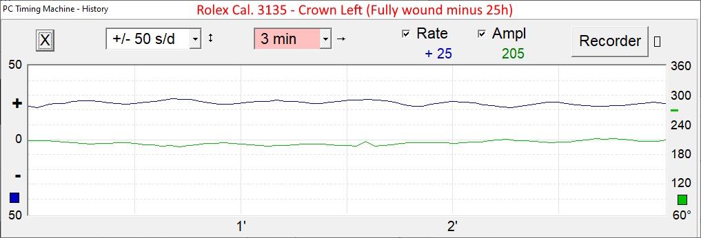

Your varying lines look weird I'm used to seeing normal graphical display versus whatever this is showing?
Then it be interesting to see your timing 24 hours later that will really give you a clue as to whether you need servicing or not. A lot of watches even vintage pocket watches you can wind them up tight Then they will look pretty good on the timing machine but 24 hours later they'll totally crash and burn.

Fortunately the Rolex is sealed up you don't have a presentation back. Because rotors with worn and/or broken axles can actually Rob on the plates and not good at all. Shouldn't affect the running of the watch but visually it won't be as pretty as it used to be.
I needed to go find the timing specifications and your slightly out of beat. You can have a maximum of 0.8 ms in any of the positions. Then the clue to servicing would be 24 hours where you have to have a minimum of 200° in any of the crown positions.
On a Weishi timing machine, it is an average of rate and amplitude that is shown while my pictures show rate and amplitude instantaneously. PCTM also shows the averages but I chose to show only the instantaneous values. Hence the crooked graphs. So it is not as bad as it looks. The average shows nice straight lines.

Here are the results of the measurements after just over 24 hours (more like 25 to 26 hours). What do you think @JohnR725? Maybe it is on the limit of what is acceptable. Anyway, I think a service is in order if a replacement of the rotor axle is done anyway, or what do you say?

This one is easy and I can give you the definitive answer. See below picture.
First, loosen (not remove!) the screw indicated with the red arrow. Second, adjust the beat error via the stud holder (orange arrows) as usual. Don't forget to tighten screw 1 afterwards.

The rate and amplitude are just about acceptable, I guess. But if I bought it like this, let's imagine, I'd service it.

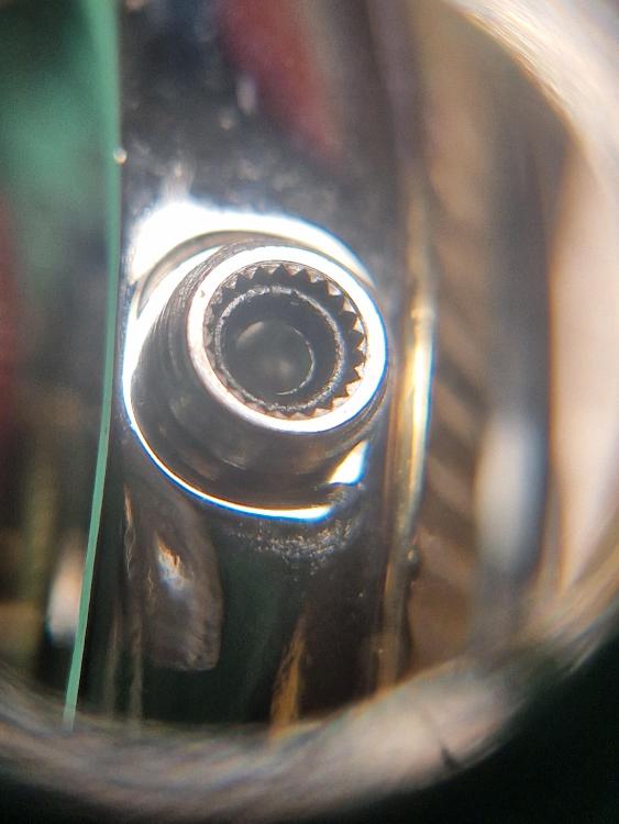

I wonder how the gasket is replaced in the crown.
I assume the watch will have a twin lock crown and therefore two gaskets. One in the crown itself (which is a flat ring and replaced like any other crown gasket) and one in the crown tube (which is round).
The latter is a bit fiddly to squeeze in without damaging it. But not rocket science.
See a picture of the crown tube gasket below:
