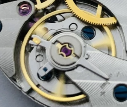

Thanks to this video I undid the tangle.
The spring is still out of round and the watch is still not starting when I put the balance in place.
Since now I have a second movement, I’ll try swapping the balances to confirm that is the issue
The result is not very conclusive. Swapping the balance didn’t make the first movement work. BUT, when putting the good balance back in the good movement I had a hard enough time doing it (it did work in the end but I think my problem is managing to sit the balance pivot in its bottom jewel or to fit the impulse jewel into the fork) that I keep wondering if the failure in the case of the old movement is because I broke it or because I am not good enough at reinstalling balances.
I confirm that the main issue is between the seat and the tweezers.
after more effort the first movement with its own bal and ou of shape spring started.
No doubt the time keeping will not be good but IT’S ALIVE!

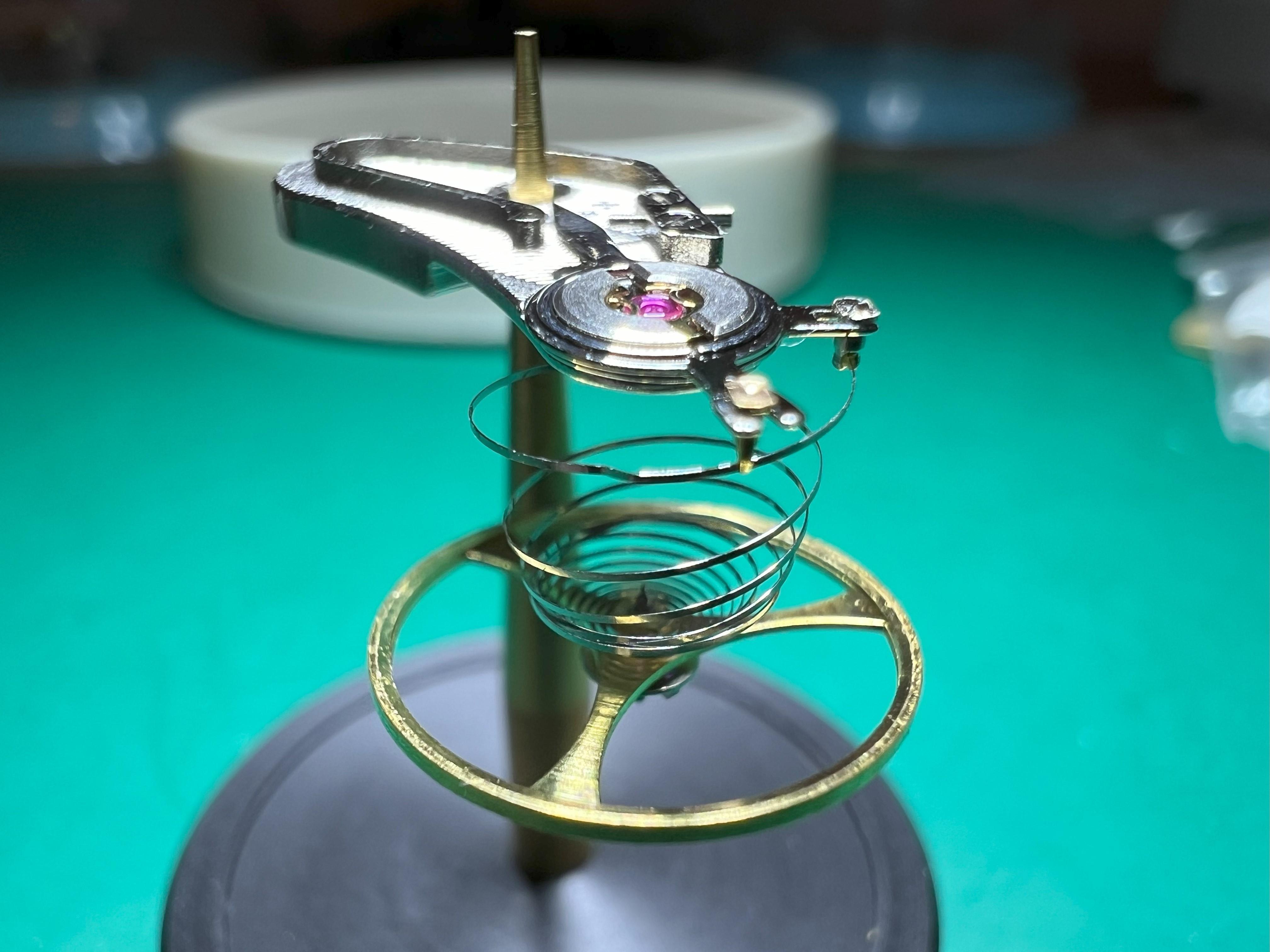

@Neverenoughwatches here are all the angles I could think of. If some are missing I can take more. Sorry for the quality they are taken through a phone.
Note that after I was so happy to see it oscillate I screwed the cock and it stopped. I have been trying to make it restart since

I was initially thinking the pivots and roller pin needed to be viewed very closely as you thought you may have damaged them. But the hairspring looks out of shape and bunched up . Its important for its shape to be concentric so that it can oscillate freely without any of the coils touching. I would begin by opening up the regulating pins by turning the brass etachron stud, this will free up some breathing space for the hairspring, the stud can be readjusted to close the pins back up when the shape has been fixed. The beat arm holds the steel coloured stud, this should change the spring's shape to something more concentric looking. This is the kind shape that you want to make.

The hairspring is overlapping at the spot where the arrow is pointing. As @LittleWatchShop said, put this away until you have gained more practice.
Fixing this involves removing the balance from the cock and then removing the hairspring from the balance. Then you'll need to reshape the coils until you have a smooth spiral, refix the hairspring to the cock and reform the terminal curve and centre the collet.
All that is advanced work but doable when you have more practice and improved your dexterity. And you'll need a microscope for that kind of work.
In the meantime, bag it up and put a note in the bag stating the fault, in case you forget in a few months time. (Don't ask me how I know.) And stick the bag to somewhere prominent, to remind you to work towards being able to fix that.
You'll ruin a few more watches in the near future. Trust me, we have all done that. When I broke my first watch, my mentor told me, "Learn from your mistakes and move on."
Good luck and don't give up. Practice practice practice.

I initially thought the same Hector,  but i dont see an overlap in the hanging balance 🤔.
The hairspring collet is so off-centered that when the balance is put in it's pivot holes, the 2nd coil overlaps the 1st.
There is a double kink or Z bend around here:
👍 some adjustment of the stud's  etachron screw should set the coils position better.
