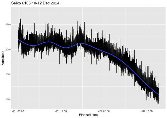

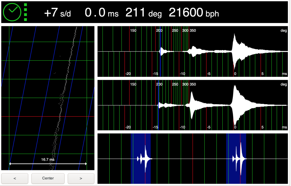

For a timegrapher, I use TG-Timer software (https://tg.ciovil.li/) on a Mac. Some report success with headset microphones but I threw together a Piezo microphone circuit. I sometimes think a commercial timegrapher would be simpler to use, but the software gives me things that a low-end commercial timegrapher wouldn't give such as graphs of the sounds, like below, and I can use the identical setup with Audacity to listen to the watch, too.
I recently modified the TG-Timer software slightly (the beauty of open source software) to write rate, beat and amplitude to STDOUT once per second where it can be captured in a CSV file for analysis. This allows me to log the behaviour of the watch I'm testing as the mainspring unwinds over time so I can analyse it to produce graphs like these:
amplitudegraph.png.1f4e06b06710173c14b03ee07aa14a2b.pngrategraph.png.0cf18572df8e42c78d30d2bb30c73839.png
I can also zoom in to look at cycles like these that show evidence of imperfections on the centre wheel (once per hour spike), the third wheel (once per five minutes spike) and fourth wheel (once per minute waves).
amplitudegraph3hafter24h.png.4e01299adb5588a5805bc29f9ee6f083.pngrategraph3hafter24h.png.0af97869681a717e21c8f0076e19eea0.png
I'm still learning how to make full use of this but as I become more ambitious with my repairs I can see this being a useful diagnostic tool.
If anyone is interested, I can provide details of how I made the piezo microphone, the changes I made to tg-timer and the R Shiny code I use to generate the graphs above, but that's off topic here, I think.

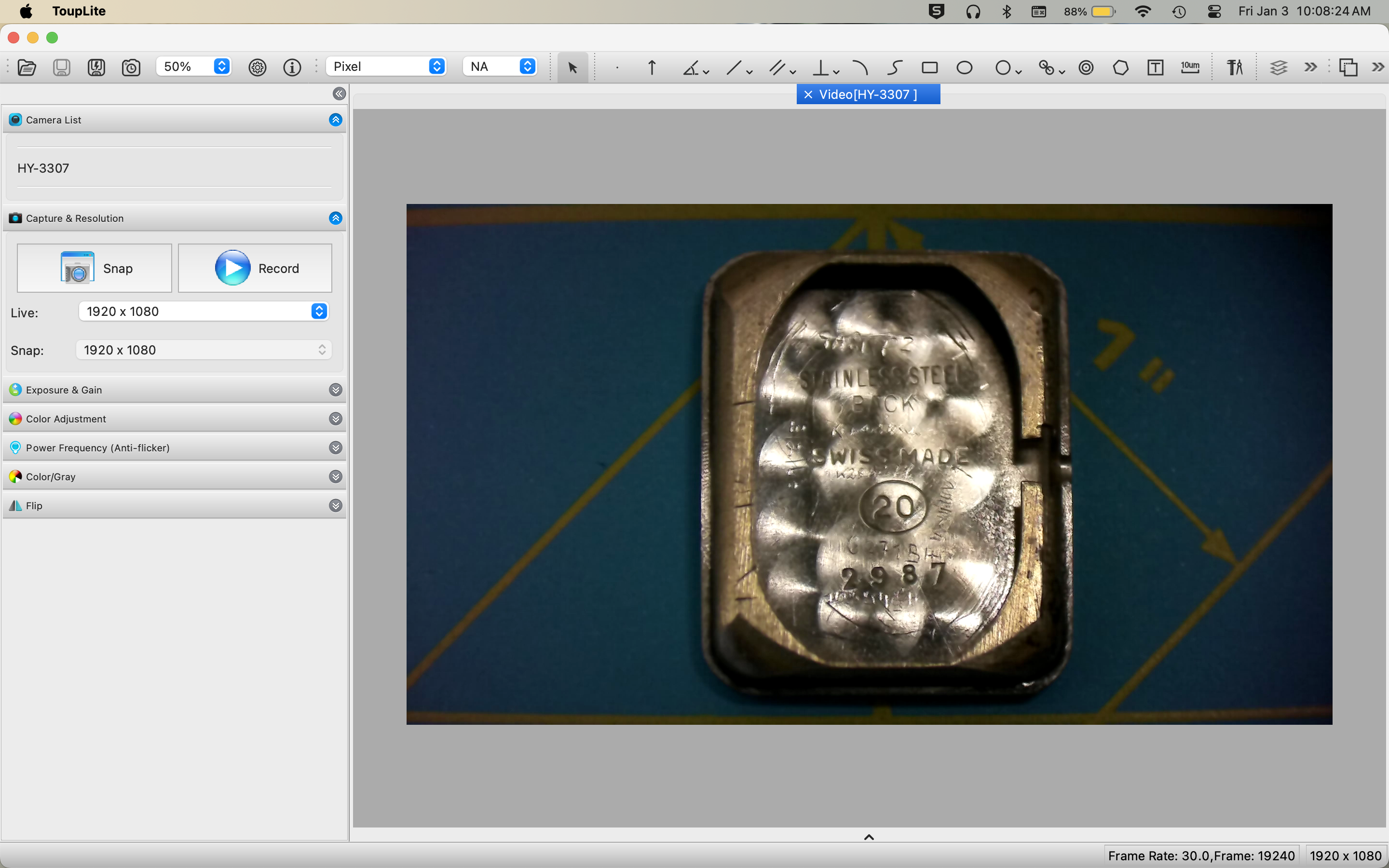

Instructions with the HAYEAR camera were not great but enough to get going. There are basically two different ways to use the camera:
First, I tried connecting camera with an HDMI cable to an external monitor. Works as advertised but I didn't like having a big LCD monitor on my workbench, and my HDMI cable is a bothersome brute that I also didn't like having around the workbench. When using this setup you need to power the camera with the supplied power adapter, and photos and videos could be captured to an SD card (not supplied) placed in the camera. There's a remote control (that didn't come with a battery, or even an indicator of what kind of batter was appropriate) that is used for taking pictures and such. I didn't like anything about this setup, but it did work.
Second, I tried connecting camera to my MacBook Pro with the supplied USB cable. This eliminates the power adapter, the LCD monitor and the unwieldy HDMI cable from my workbench. Much better! Tricky part here was getting software on the computer that could capture photos and video. HEYEAR's website has software, but it is a bit hard to find and install, and didn't work well. I ended up downloading software called ToupLite from another microscope vendor. It is the software that HEYEAR's is based on, but with all the functionality I required working properly.

Here's a screenshot of the software:

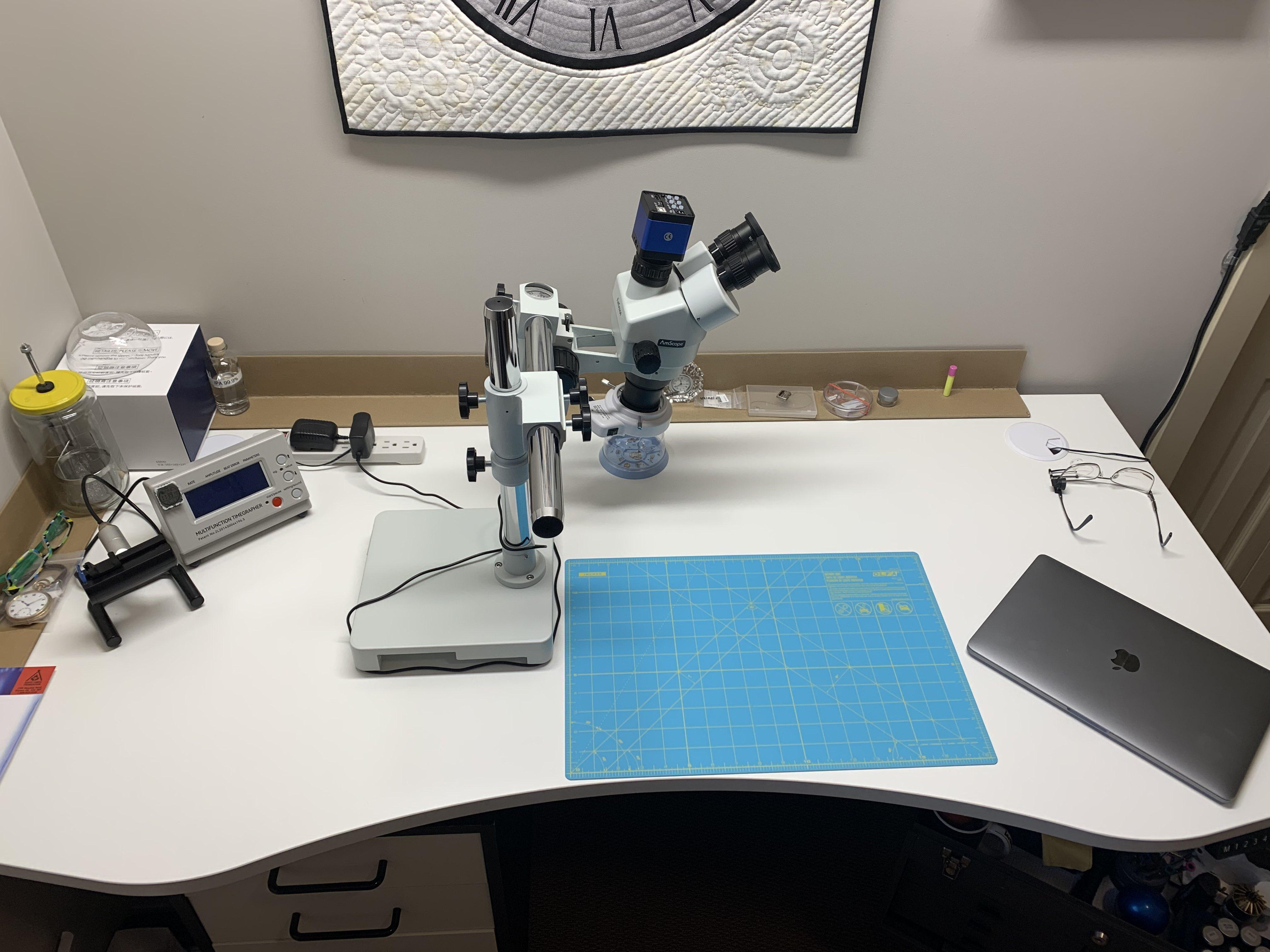

Here's a shot of the microscope in its working orientation:
And swung out of the way:

If I recall correctly, the USB connection will not provide the max resolution of the camera.  For that, you would need to record to the micro SD card.
If you are running Windows, you can use the built-in Camera app and view/record/take photos from that.

It wouldn't work with Quicktime to record?
Edited by AndrewR
I hadn't thought of that. QuickTime Player will record a video via the Hayear camera. But I haven't found a good way to simply snap a photo using the software that comes with macOS. Photo Booth gets you close but has annoying quirks. Any ideas?
I do use Photobooth for snaps. But you do need to make the settings flip your image to normal. You can also turn off the annoying countdown as well, or at least use a button combination that bypasses it. (ChatGPT/Google Gemini are your friends)
Otherwise I just take a screengrab from Quicktime (cmd/shift/4)
