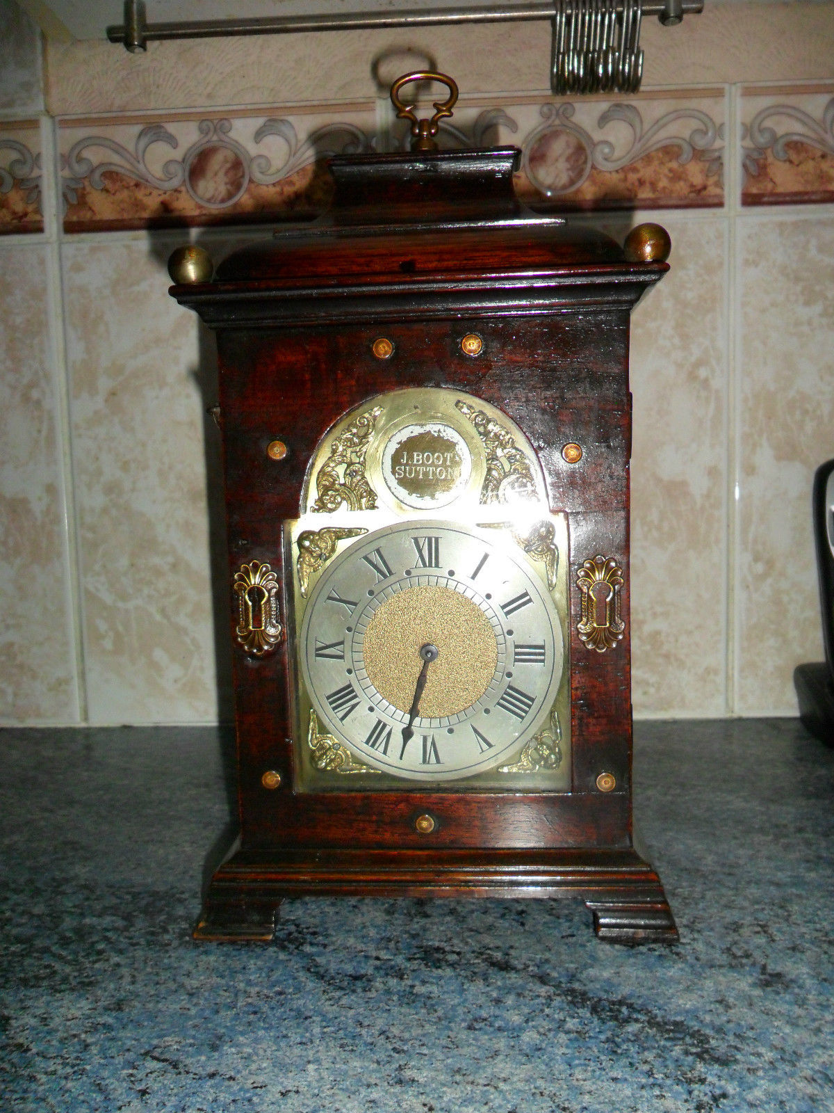

Finished! Well, not quite, but I've done all I can. I used the original hand for the minute counter. The running seconds hand is a central seconds hand with an extended tube - I just snapped off the long bit. It works I think. As I couldn't source an hour reset hammer I left the hour counter hand off. I hope the owner will be happy. It's all working and keeps good time. I did recommend he got a professional to do a proper job, and he could still do that in future if he wanted to sell.
