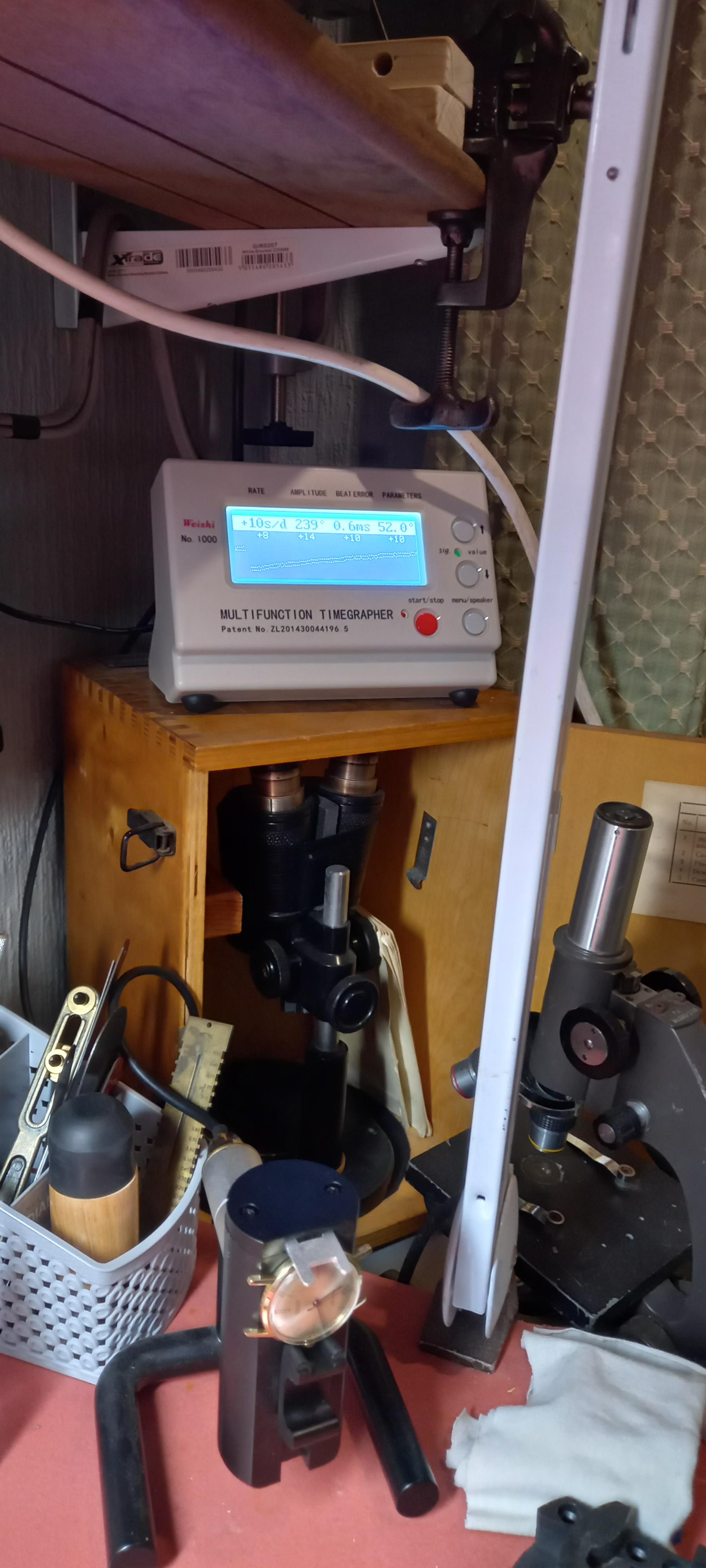

I think it was just designed for balance staffs, i had a bent escapewheel pivot on a restoration from a while ago that had been put aside so i thought why not give it a go, its my first time using it. I've literally just gotten around to casing up the movement, busy sorting out a load of old movements i bought and making washing machine devices. Here we have it running dial up and crown down an hour after a full wind, i think the pivot survived the ordeal and is doing well.
