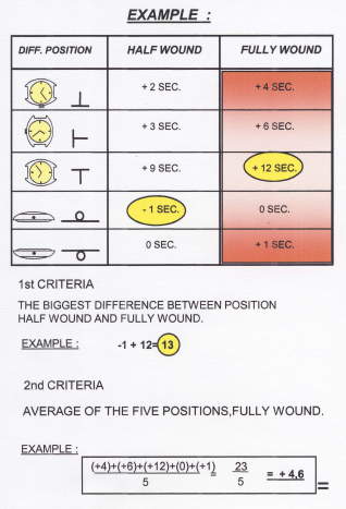

Here's something Rolex has half wound is 24 hours later fully wound up with courses fully wound up. Notice how in one position its 12 seconds fast how horrible. Except their criteria system so the first criteria is basically the isochronism the difference between a fully wound up and 24 hours later. The second criteria is averaging. Now this is where most watches are going to fall down this example is pleasing a timing machine.
Then what about real-world timekeeping? Notice once again they average their numbers so on a instantaneous particular day at might look bad but the overall average is good.
