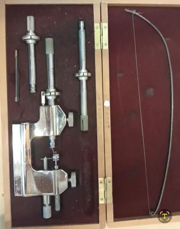

Hello everyone,
I'm thinking of adding a Jacot tool to my collection.
I found this one from Steiner (now Horia). Apparently very clean (waiting for more photos).
But just in terms of completeness, does it look good?

You would want to ask the seller for pictures of the lanterns hidden under the covers. These can often be broken.
It look good and complete even with the bow which is normally missing. it is in its rightful box as the indentations in side the lid match up with the tool. Do as Neverenoughwatches said get good clear photos
What folks are concerned about are the lanterns, thins discs on the opposite side of the runners (under the protective caps), that allow working on the pivot ends. These are often chipped or worse.
Replacements are available from Horia for 70 bucks a piece. This set doesn't have the double ended runner for center wheels, which is handy. It's not missing, it's just a smaller set. Those cost a cool 490... so if it's something you think you will miss, it's worth looking for the larger set that includes it.

Thanks all again!
Here are the missing photos. You were right, there is damage. Two holes missing..
I'm still tempted because I could have it for less than 100 USD.
I'm wondering if these can be replaced / where to source them?

Thats not so bad a couple of holes missing, the pivots dont have to fit holes exactly, you could get away with  what you have. A hundred bucks seems ok if the rest of the tool is fine, you could wait a while for a better deal or pay a whole lot more for something crappier.

Got it! I got the photos and indeed the 12 and 13 size are broken 😞

You won't find replacement parts for any other brands. First, Steiner was one of the only ones to make the ends of the runners replaceable, and second, they are the only ones (Horia) still making these.

👍 100 bucks for a Steiner is a good price, it might not be a big set and some low damage but as far as i know the Maker is about as good as you get. Personally i would go for, you will always get your money back plus with reselling it

My inherited Jacot has those "lantern" discs in perfect condition.  However, I do not know how they are used.  I am an amateur and it shows!!
The lantern discs let the pivot end stick out, thus their thinness. So you can work on the end, round it, whatever. But- there's (almost) always a burr! Very tricky. I make balance staffs regularly, procedure is: turn basic staff, harden and temper, cut pivots (leaving ~0.005 to 0.01+mm diameter), rivet, and roller taper. Rivet to balance. Finish pivot diameters in jacot lathe. Chuck in normal watch lathe and finish ends.
I haven't used the lanterns for finishing ends since last century.  But- they are handy for straightening pivots on 4th wheels and chronos! So all my Jacot tools have all their lanterns intact.
