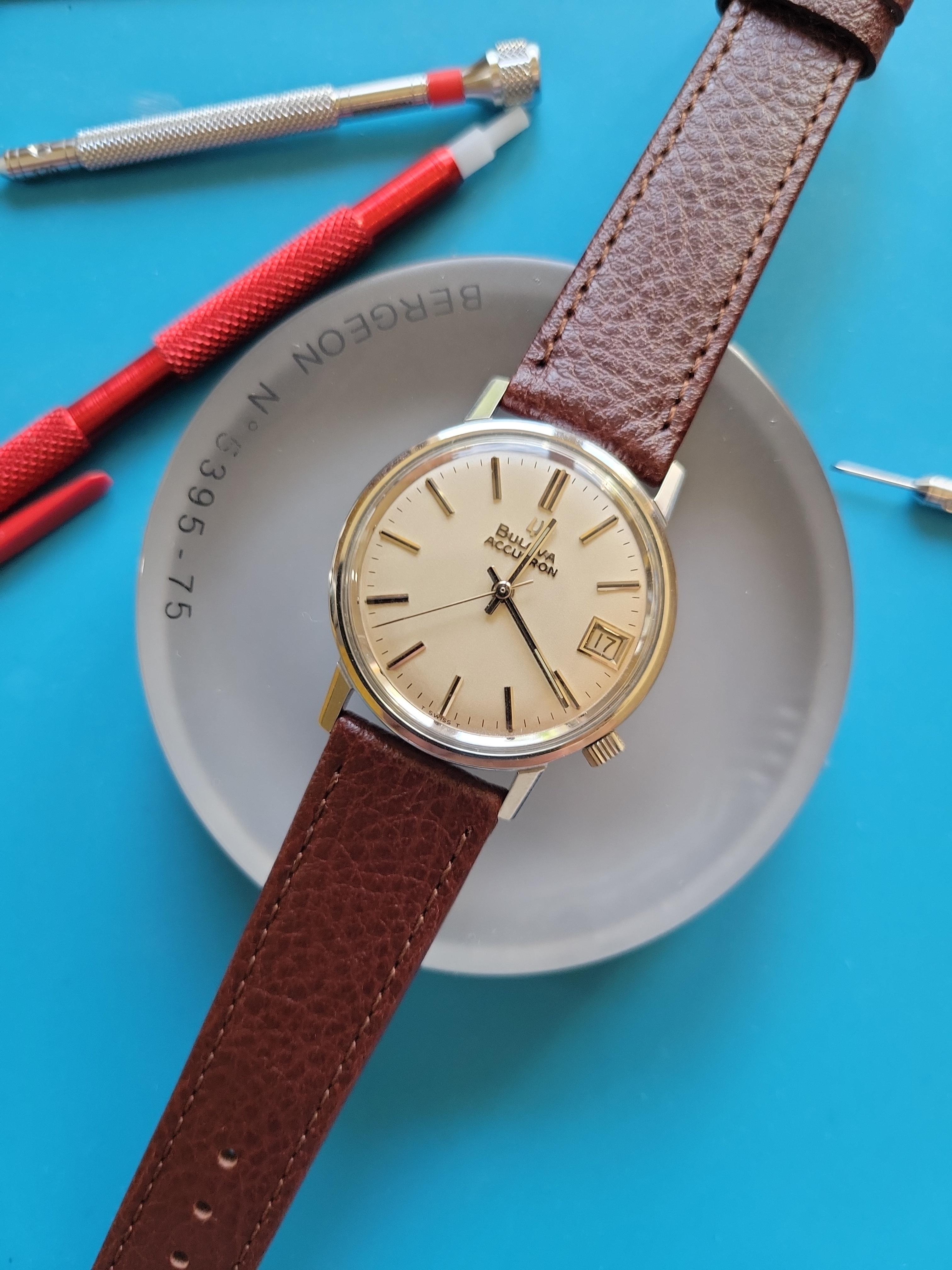

I thought I would share where I am up to with my latest project. While doom-scrolling Ebay I came across a soon-to-end auction for tidy looking Bulova Accutron 2181 and chanced a bid. The seller was upfront that the seconds hand turned but the minute and hour hands did not move. I had already read elsewhere that this was a common problem and figured I should be able repair or at least replace the seized parts. This is my first Accutron...

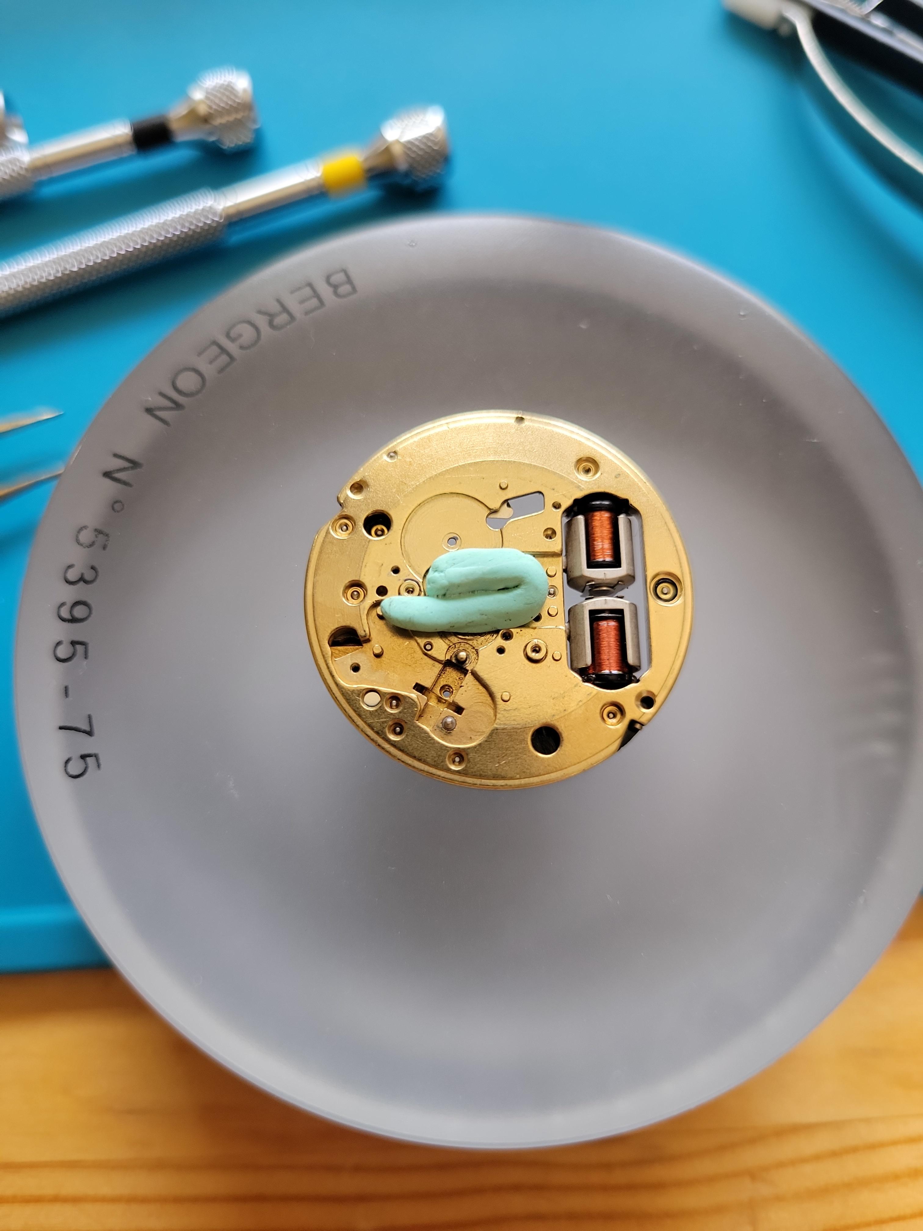

The project is a simple stainless steel dress watch with a silver face and simple baton hour markers. Should look nice on a black leather strap.
On first inspection after opening the case it is obvious there has been a battery leak. It looks mostly contained to one area and Im hoping it will clean up.
I checked the "fingers" and while dirty, they look ok. So far so good!
I started by disengaging the fingers from the index wheel - apparently any rough handling during hand removal can cause these to break.

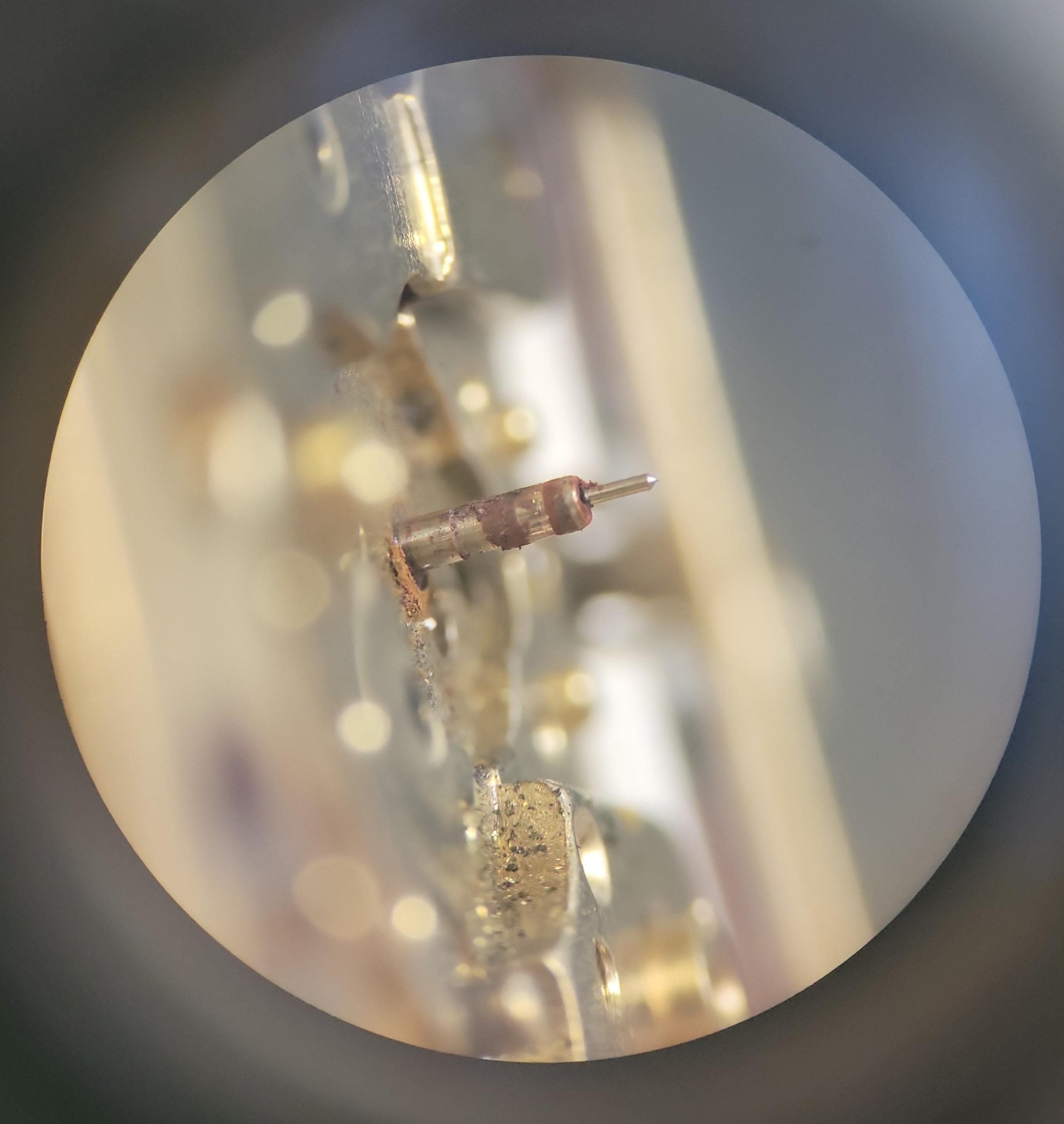

Once I had stripped the dial side down I came across the reason why the hands were not moving. Indeed the canon pinion had seized - and properly so! The minute wheel teeth had been striped!

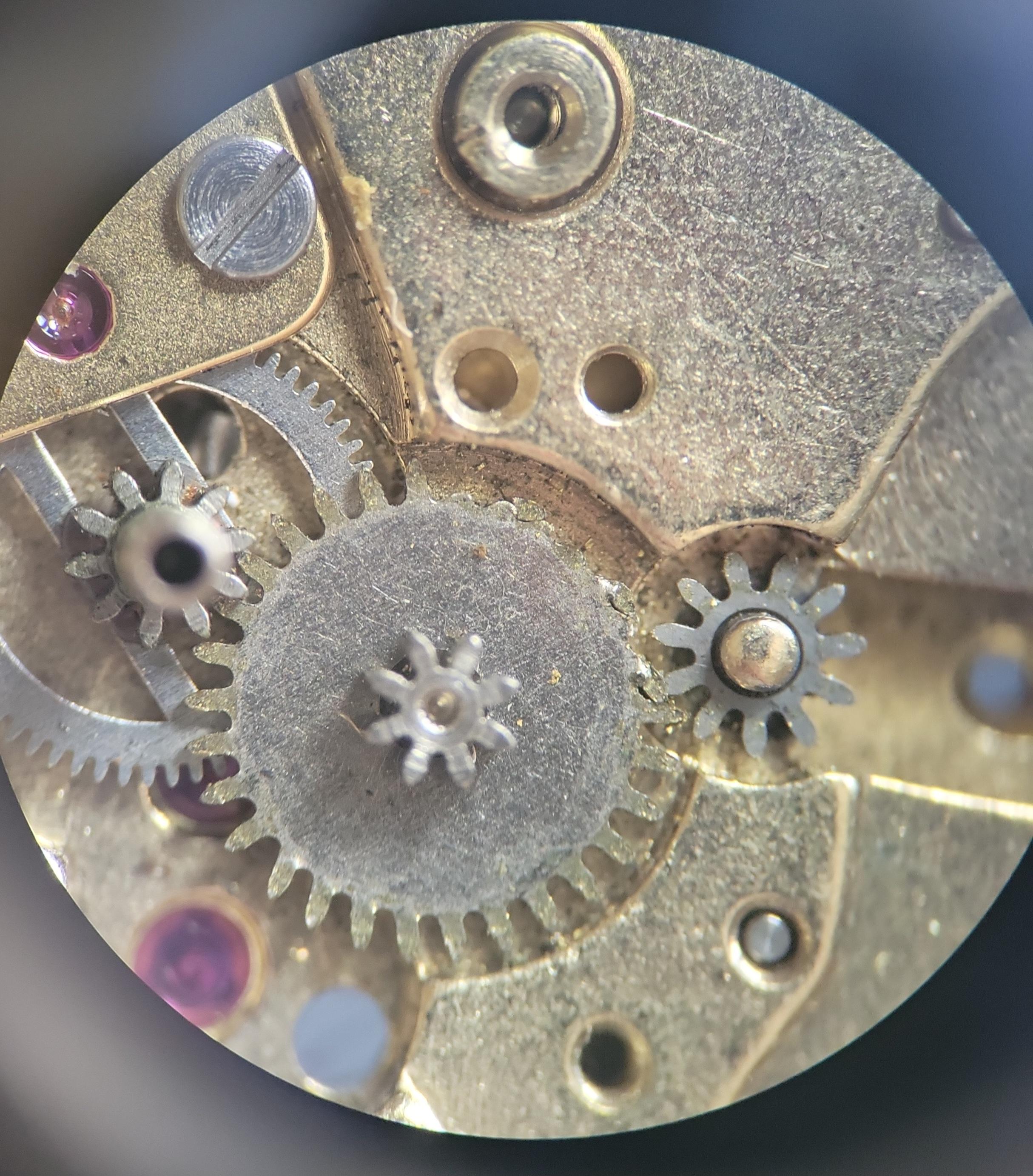

After wrestling the centre wheel away from the movement it was clear it had rusted solid and the previous owner had attempted to free it up using force applied to the crown.
I used a bit of Rodico to clean up the rust and teeth before proceeding as the forks are magnetised and will attract any ferrous material. Also of note virtually all the components were magnetised to some degree or other so will need to deal with that.

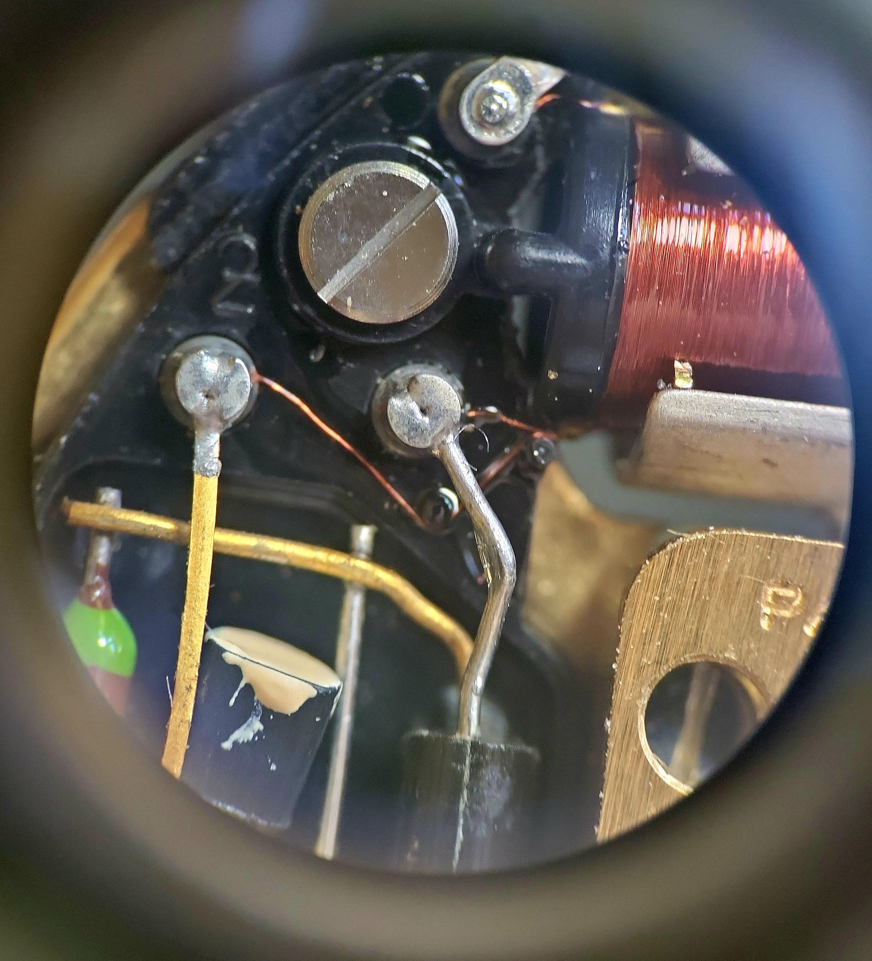

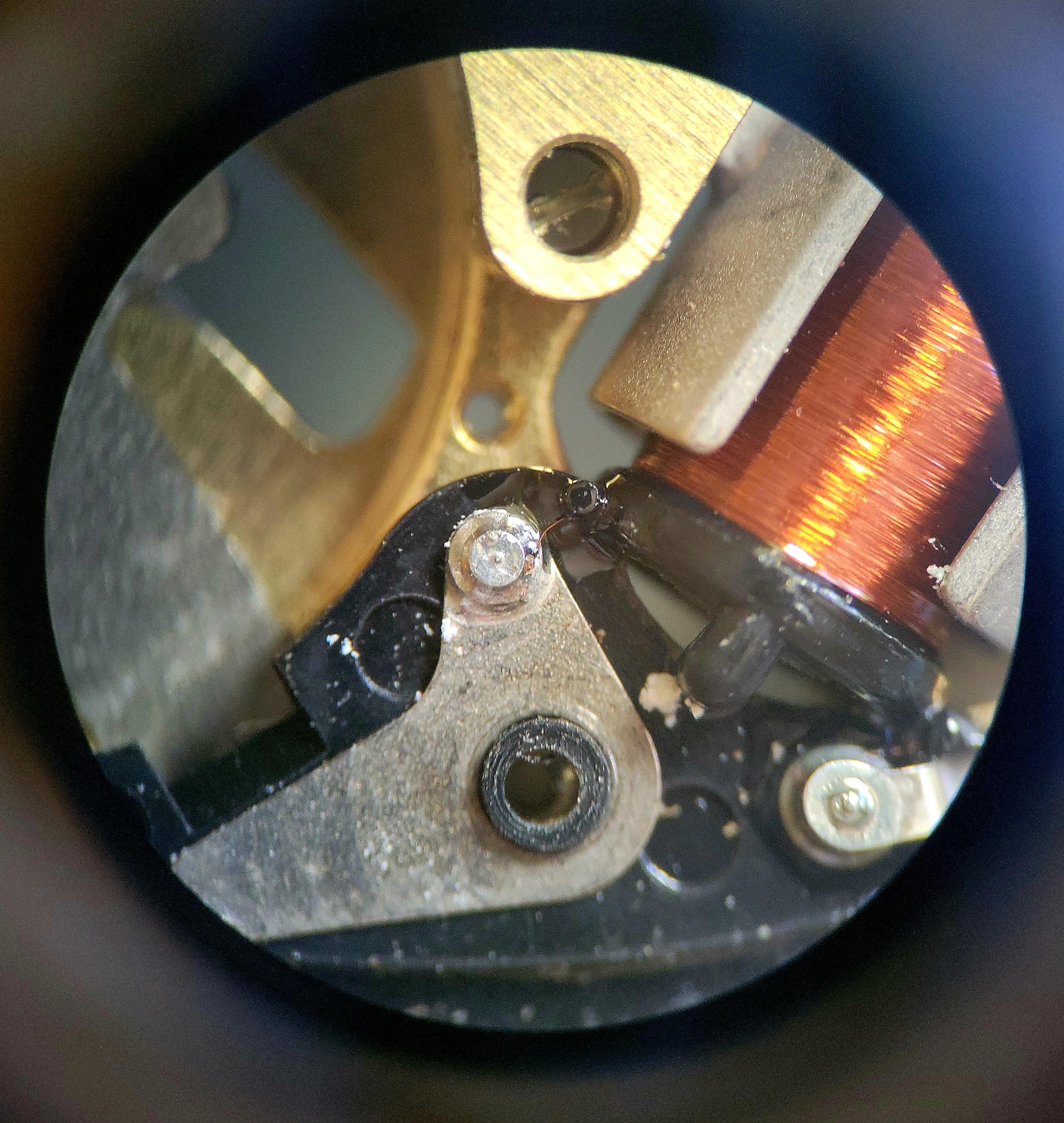

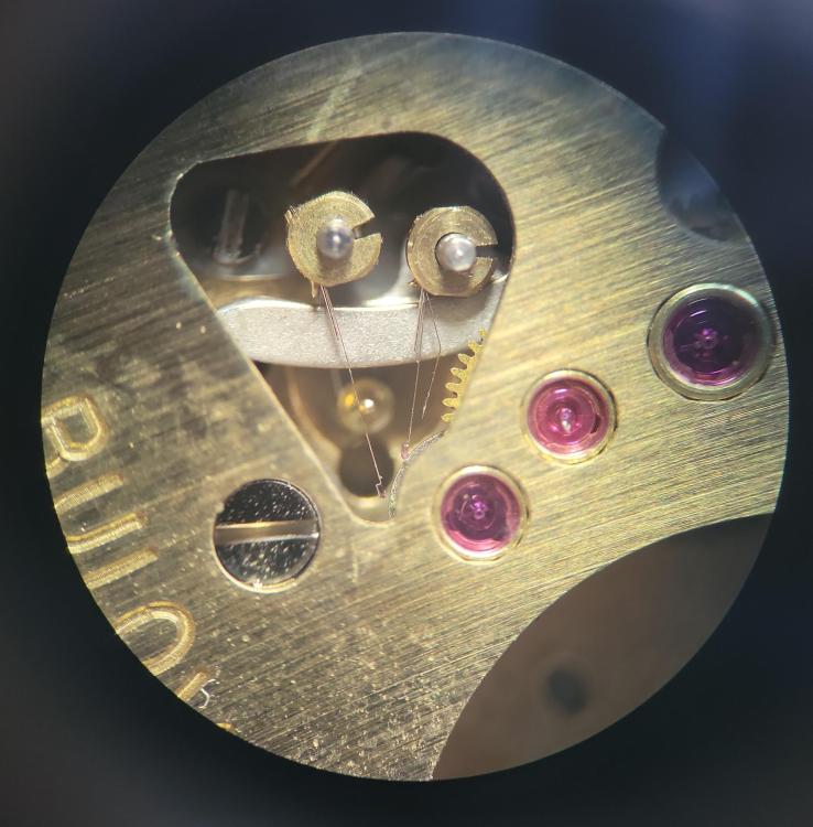

A couple of shots showing just how thin the coil wires actually are!
I finally made it down to the tuning fork and got stuck trying to remove one of the two screws holing it to the plate. I was putting significantly more force in to turning that screw head than I was comfortable with so decided to place a drop of penetrating oil around the screw in the hopes it will have loosened up by the morning.

The screws for the fork were surprisingly tight on both of mine as well. Expect the fork to be extremely tight on the studs once you get those screws off, as well.
If you don't know, the docs say not to pry on the fork to lift it up, but to push it up from the bottom using the hole in the main plate. I put a bracelet pin tool in the hole and gently tap it to release the fork.

The classic problem of the center wheel assembly has rusted itself to the post. Then a minute and hour hand no longer turn the secondhand churns the friction part of the center wheel assembly is totally destroyed. Occasionally can flip the wheel over and buy yourself a little time but typically you'll have to replace the wheel. Then if you have really enthusiastic user you'll end up with a minute wheel stripped also. I would recommend not following the lubrication  specification of whatever they say for the center wheel to avoid this ever happening again.
Oh and when you finally get the screws off and remove the fork be very careful because typically underneath our spacing washers. The color-coded to refer to their thickness. But I find it's usually best to just put the screws back in once you've lifted the fork out of the way that way you don't have to worry about which washer is where and basically is random whatever you going to find. The purpose is to tilt the fork so it agrees with the circuit.

We end up with a certain unknown here that style of wheel with friction is common a lot of watches but it's a classic in this watch if it freezes up it's because it's now stuck to the post with what looks like rust. So the best guess is that the lubrication they recommended went bad. My current favorite lubrication is 9504 but basically a grease should work fine just not the one that they recommended.

Then yes this is a definite problem sometimes we take them out they will practically literally spin with a puff of air because they are so incredibly worn out . But because you have nothing to lose you can try to tighten it. I think I've seen people use concave punches in the staking set in an attempt to squeeze and bring the metal in word not quite sure how you want to do this but you try something is worth a try

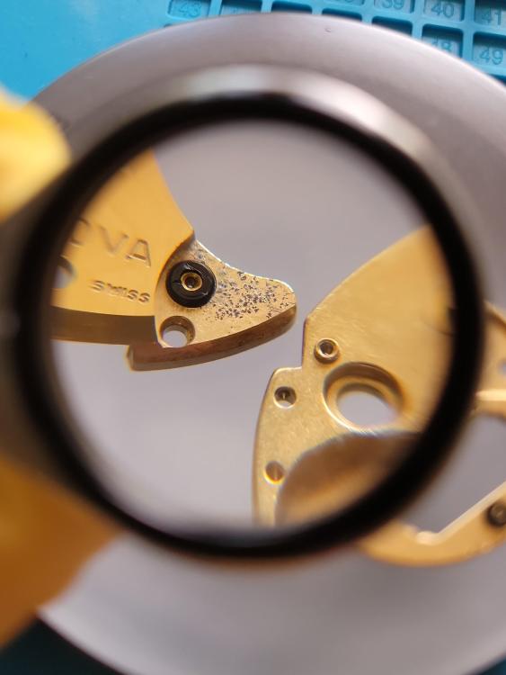

Oh thats a shame. The battery leak reacted with the bridge plating. Its not serious but spoils an otherwise blemish free part.  The main-plate seems to be relatively unscathed tho so small mercies.
The tuning fork screw finally budged but will admit it looks less than new now. Its a learning experience...
I am also looking at the main wheel - I have cleaned it, soaked it in Evapo-rust (at this point I figured why not) and cleaned again. The pinion still appears to be frozen.

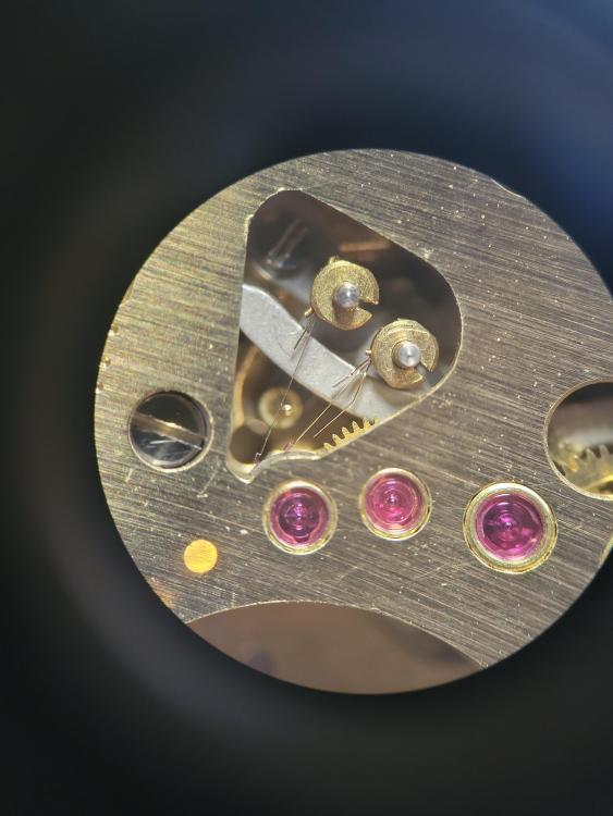

I needed to remove the retaining spring of the back of the movement. First screw and I slipped straight into the hole where the fingers are visible. Sighed, stepped away, finished my coffee, went for a walk, contemplated my life choices.
It was a disaster. Both fingers had been mangled. I had also gone in with enough force to bend the finger posts! I went for another walk.
At this point my options were to look at dismantling a perfectly functional spare movement or try to somehow fix the damage. With nothing else to lose, I figured I would see if it were possible to straighten out the fingers and reposition the posts.
I separated the fingers form their posts and very gently, with a pair of brass tweezers and a microscope, I managed to reset the posts on the fork and pawl arm back to more-or-less vertical.
The fingers required a lot more fiddling. Where ever there was a kink I needed to place the tweezers in such away that when bending, the kink would straighten out rather than add a new kink. I also needed to readjust the vertical positioning of the fingers and stays as they had all been forced down. Lots of bending and preening at 20x magnification....
I reassembled everything without much hope that the hours of work I had just put in were going to pay off and installed the battery. It started running!! I have no idea if it is running "well" but it is running. Im also guessing I may have weakened the fingers so will be keeping an eye out for future spares...
I did not take any pictures of the damage (I really should have done for this thread) as I was simply too angry/embarrassed. I will get a better final shot when I have better lighting.
This was.... a learning experience.

Final post.
I had a go at phasing the movement using the link provided by @ManSkirtBrew tho I did struggle with step 4:
Quote
4) At this point, raise the power supply voltage to about 1.75v. See if the index wheel is running normally or fast. If fast, then very slowly adjust the cam a small amount either way to find a spot where the watch again runs at normal speed. Be very careful not to depart too far from the original position found in step 3, or you might end up in another "cycle" of phasing (ie. + or - 1 whole tooth) whereby the pawl finger tension would be wrong.
I mean... how do you tell if it is turning normally or fast without putting the hands back on and running it???
But it appears to be running at a more normal speed compared to before I tried to phase it.
OK, so here is a pic of the fingers after I had straightened them out. If you look closely at the root of the pawl finger you can see there is still a kink that I could not quite get to. The index finger has a scar from where I made contact with the screwdriver... Lessons learned...
Random step-down power supply purchased off Amazon (verified the voltage using my multimeter just to be sure)
And finally, after it is all beck together.
Many thanks @JohnR725@ManSkirtBrew for your help and advice!
