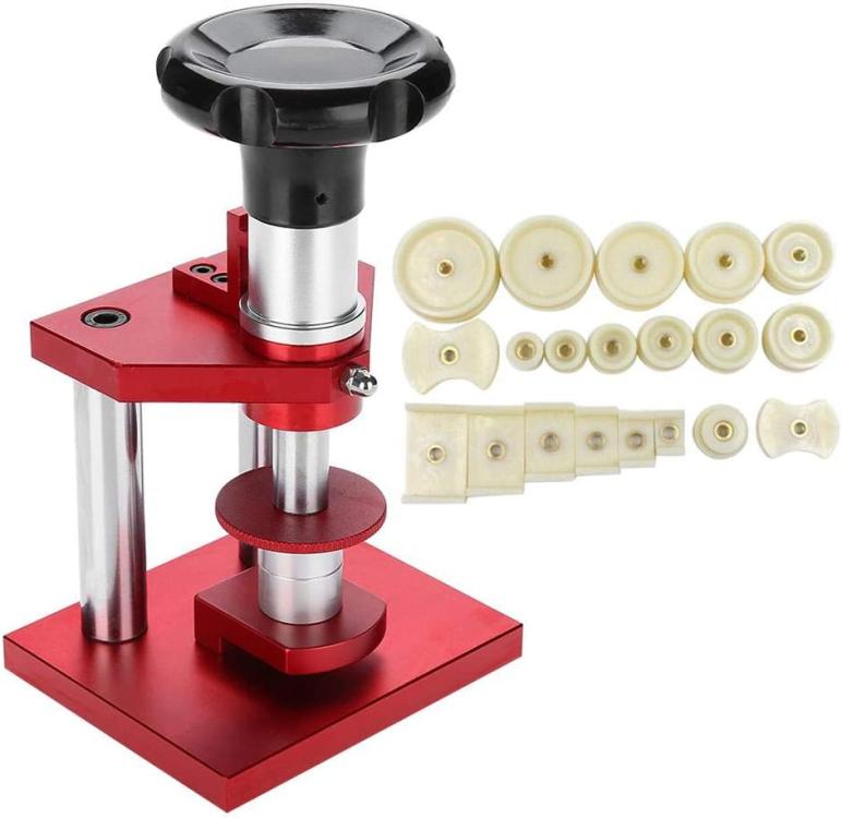

I bought a watch case closer / crystal press off of AliExpress.  It binds when trying to cycle it.  I unscrewed the lower collar for the top and found a 3mm set screw in a 5mm non-threaded hole.  It is not a surprise that there was binding going on with that set screw swimming around in the hole.  The set screw was gouging up the shaft and damaging the collar threads (was rather hard to unscrew).  Has anyone had the same issue with these cheap Chinese presses?  I know that you often get what you pay for going on the cheap, but with some products you can get something that will work well without having to pay a premium price.
This is my first time ordering through AliExpress.  I contacted the seller and got the "I will check with our technical department. And I will let you know when I get the answer" and "but if I don't respond to you for a long time, Would you please contact me again?".  With that, I'm not optimistic dealing with the seller.  I regret not getting the press from Amazon.  Easier to return things or get a replacement.
If I don't hear back in a reasonable amount of time, I'll likely try to fix it myself.  Get a larger set screw and thread the hole for it.  Then clean up the shaft and grease it all up.

It looks like a basically sound tool but assembled with the wrong grub screw. Should be an easy enough fix if it doesn't have to go back.
If the hole was actually threaded, then I could simply try a new set screw of appropriate size.  I do have a tap set and could thread the hole.  I'd expect at least a partial refund if I had to fix a brand new tool.  If I go that route, I'd probably tear it down to parade rest and then threadlock the screws and grease it up the shaft pieces.

You mention that you have one of these presses.  I'm curious, if you can get the collar off without too much trouble, what does yours look like there?  I imagine on my press, that they ran out of the proper set screw for that hole and grabbed a smaller one.
I took the cap off just now and had a look. The grub screw looks like the correct size but of not a great level of quality. I think I will look at upgrading that at some point.

Thanks for checking that.  The only purpose that I can see for that set screw is to keep the shaft from rotating but allow the shaft to freely move up and down.  Shouldn't have much stress being applied to it.

I expect you will get a full refund, either from the seller or Aliexpress, if you are insistent. If you don't have to send it back then you get a serviceable tool in exchange for some email correspondence and a bit of fettling. Let's hope it works out that way.
I sent in photos of the issue to AliExpress and requested a refund.  I already have a resolution.  They provided a full refund and I don't need to send the tool back.  I would have been happy with a partial refund since I was able to fix the press.
I put in a proper sized grub screw.  It took a minor bit of sanding the bottom of the screw, to make sure the collar would clear the screw head.  Secured it with a dab of loctite.  Cleaned up the gouges in the shaft keyway.   Loctited the rest of the screws and greased up the inside and outside of the shaft.  The press cycles smoothly now.  There's no issues with alignment of the top to the bottom.

For what it's worth, mine came incorrectly assembled and I had to fix it (though I'm still not sure I did it right either). But on mine, that is not a grub screw. It's just a short aluminum rod and its purpose is only to protrude into that groove and keep the shaft from rotating while while still allowing it to slide vertically. If I unscrew the collar, the little rod can drop out. The hole isn't threaded.

I was thinking that it was probably a pin that should be in that hole, not a grub screw, since the hole isn't threaded.  The advantage of a grub screw is that you can adjust it to make sure the shaft can move up and down freely be in the keyway enough to not allow it to rotate.  The grub screw I put in had just enough bite in the hole to stay in place.  A dab of loctite helped.  The grub screw did need to be filed down a tad so the collar could be threaded back on.
As for operation, there are two sets of threads.  The outer threads you can see with the press all of the way up.  Those allow the press to go quickly down until you contact the watch.  Then the inner threads, which are much finer, kick in and allow for a slow and controlled compression.  I did have to file the little limiter, in the back of the press, to make sure there was no rubbing of the outer sleeve on it.
I was not able to get any movement out of the fine threads for a long time, owing to high friction between the black knob and the large silver collar with the heavy threads. But after I deduced how it was supposed to work, I just put a lot of force into the knob and it started to move. It's still much stiffer than I think it should be, after I worked a little 3 in 1 oil into where the knob meets the sleeve. I should probably disassemble the whole thing again. The first time I had it apart, I could not figure out how to detach the knob from the big sleeve so I suspect there's still something not assembled quite right.
