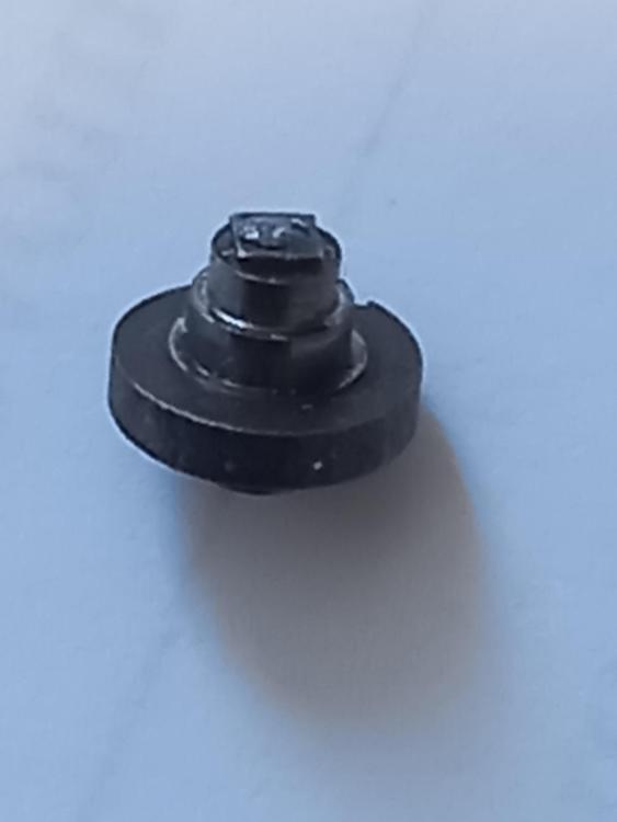

Can the Bergeon 30209 Screw extractor tool be used on left hand thread screws? Being a Numpty, have an arbor which has a right hand thread hole, and I have inadvertently put a left hand thread screw into it. I broke the head off. This was a year ago, and I now feel capable of attempting the removal. I'm thinking of purchasing a Bergeon 30209 type extractor tool. There are only a couple of videos on Youtube that show its use. They all show a right hand thread removal, hence my question. Can anyone help with a definitive answer please?

However, you may have cross threaded the arbor and you may need to replace it. Find a replacement part or buy an assortment of arbors...all cheaper than buying a Bergeon tool.
It's from a pocket watch. BTC. No replacements available. I don't have the facility to make an arbor. Watching the video, I think it may do left by changing the direction of the rotation.  Thank you for that.

Why does the screw look so eccentric?
The screw extractor is designed for removing screws from thin plates, where the hole goes through the plate and the broken screw is accessible from both sides.
Unfortunately, a barrel arbor has a blind end hole. The screw extractor cannot grip the broken screw from both ends. This is why you never hear of anyone attempting to use this tool to remove a broken winding stem from a crown.
Your best bet would be to use a tungsten carbide spade drill and drill a hole in to the broken screw by hand, then wedge a tapered square rod into the hole and try to unscrew the broken piece.
It might be better to wait for a donor movement to show up on eBay.
I've had a look through my x15 and the screw is actually central. It's an opitc error in the photograph.

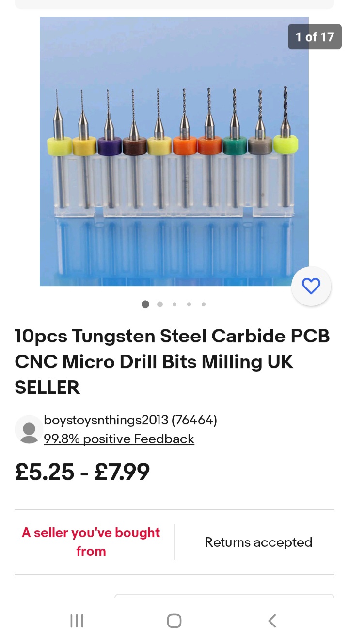

I think Hector has a good cheap answer here. A set of cheap carbide drill bits ranging from 0.1mm to 1.0mm will cost you around a fiver from ebay Manually drill the screw using 2 pin vices to hold the arbor and drill bit. You will be drilling in the direction that the screw needs to come out. Yes it will be time consuming but you maybe lucky and the drill may bite and unwind the screw while you drill. You may also be unlucky and the drill bit snaps or it winds the screw further in .I would work up in two sizes of drill bit,one small enough to start accurately in the center of the screw. Just to give you a shallow start ( too deep and it will likely break the drill bit ) for a larger one that is just short in diameter of catching the threads. Dip the drill bits in some cutting oil as you progress, take your time and back off when you feel resistance. When you have something of a hole,  use a very short cutting broach or similar in a pin vice to jam into the hole. Not to cut but looking for something to grip the screw. Hopefully this will give you enough purchase to unwind  the screw. Here are the drill bits i got for a fiver i thought reasonable quality with good cutting edges. Cutting broaches you can pick them up cheaply secondhand on ebay fairly regularly.  Always come in handy. If you are in a rush i have dozens of them and can send you something useful. Obviously it needs to be cut short or the broach will twist and possibly snap. Good luck Ross.
Edited by Neverenoughwatches
I think Hector has a good cheap answer here. A set of cheap carbide drill bits ranging from 0.1mm to 1.0mm will cost you around a fiver from ebay.
Thank you for that. I have marked a set for purchase. Getting up my courage. Also going to get a small desk vice. Gosh. Tools, tools, tools....

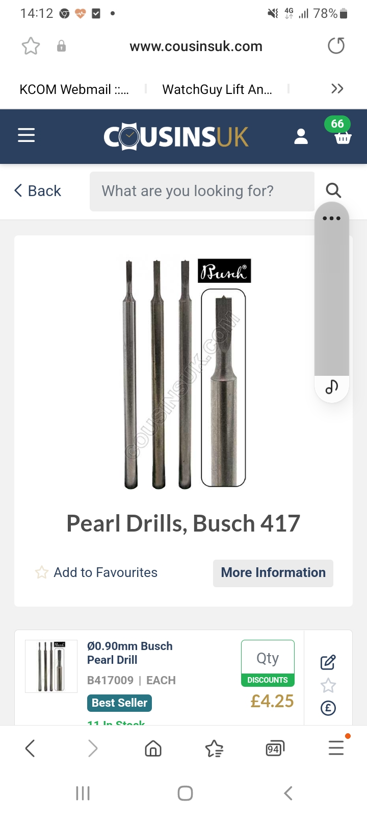

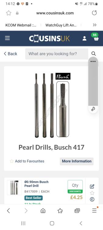

Cousins sell pearl drills, are these similar ? A bit meatier and less likely to break. Easier to remove if they do ?

Those are along the lines of a spade drill, but probably optimized for drilling- pearls. Not sure if they're carbide?

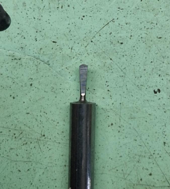

This is a "big" one I ground, 1mm; I don't usually do such a pronounced waist but this was to drill out a screw in a rare case, and the waist really helps get it out if it breaks. This was done on a carbide tool grinder, but they can be done freehand, grind basically like a screwdriver, add a bit of waist, the grind the two angled faces for the cutting edges. A square head pinvice helps to "index" in your fingers.
