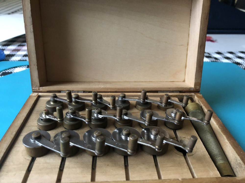

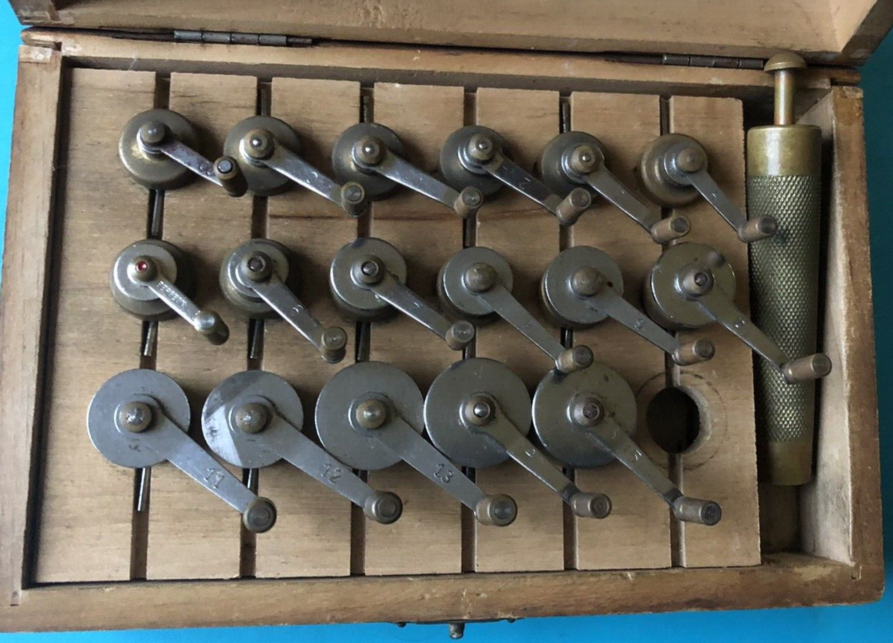

Favorite brand mainspring winders and double checking before I pull the trigger on my first bergeon ones.
So i'm always scouring ebay for good deals on tools and this turned up and it looks interestign and the price is good. It's a swiss brand called Favorite and there's a bergeon mixed into it. it's from the wife of a watchmaker who I assume has passed on. ANybody know anything about this? I'm assuming it's probably not a great idea because there doesn't appear to be left/right handed parts and one of my primary interests is seikos which are left handed often. Mainspring winders are a pretty big source of confusion as far as knowing what the correct one is. The description says they're numbered from 00 to 15. No idea what that is even referring to.
Since I'm probably going to just go with ordering individual bergeon parts (I'm really thinking about going to horology school and getting serious about this I enjoy it so much So i might as well start assembling quality tools.) I'm currently looking to get the mainspring winder parts for the seiko 7s26 and seiko 7006a movements. I was told for the 7s26 that I want a left handed handle, to buy the left handed No 7 10.8mm winder and the left handed no6 left handed arbor.
I've seen posts online saying that the 700x and 7s26 mainsprings will use the same winder set and i've seen some say they don't. Can anybody confirm if this will work for the same caliber? I got them in my cousins basket and i'm ready to order i just want to be 100% sure this is correct.

For Seiko 7xxx movements I use the Bergeon #6 winder with a left hand arbor. For 61xx movements I use a #7 winder with a #6 right hand arbour, you can use a #7 RH arbour too, but it's a bit too big and there's a risk to deform the inner coil of the spring.
I also use the #6 winder with the 66/6602 barrels, a #5 would be a better option but I don't have one.
 Interesting, so you use the #6 winder and the #6 arbor? I  was told the #7 winder works better. The 6 works fine?
ALso am i correct that if you use a left handed handle you also want a left handed arbor and winder correct?
For 7xxx movements the #7 winder is too big and I don't think it will work but I haven't tried it, #6 works fine for me. For them I use a left #6 arbor, you have to be sure that it hooks the spring before inserting into the winder, seiko springs are narrow so you shouldn't press them to the end of the arbor.
I do not use a handle, I do not have one. Of course it would be a left hand handle should I have it.

Not really, outer diameter of #6 is 9.8 mm, and #7 is 10.8 mm. #6 arbour is 3.0 mm diameter and #7 is 3.5 mm.
https://bhi.co.uk/wp-content/uploads/2021/05/HJ-Mainspring-Winders.pdf

Not always, for example 61xx and 63xx movements need right winder arbors.

Oh i guess i meant with the two calibers i'm trying to work on right now which would be 7006a and 7s26.
This is so goddamned confusing haha. For those i want left handed arbors correct?
Yes, 70xx and 7Sxx uses left arbors.

There were several makers who made the "Bergeon style" winders and from what I've seen they all interchange. Those Favorites should work with Bergeon parts. For left hand springs, you can try winding into a smaller winder barrel, then eject the spring into a larger one (that still fits your watch barrel), now it's reversed and correct. Likewise, you can save the retainer rings the springs come in, and eject into that (carefully), then into your barrel.
I never use the handle, but even the "right hand" one will work fine winding left hand springs, the barrels lock into place firmly. Maybe if winding a spring into the 15 barrel it could unlock, but normal wristwatch size no problem.
On these older sets it's worth checking the hook on the winder- I've found several that were way too long, makes hooking on the spring next to impossible, risks damaging the spring when winding, and makes unhooking almost impossible. It's OK to file them down, they really only need to stick out about a mainspring thickness.
And it's fine to use a smaller winder handle with a larger barrel, as long as the cap covers the barrel it works. Quite often the given winder handle is too large for the spring center.

Interesting. Not sure if i want to risk 230 bucks on the set not knowing exactly what it is. The seller doesnt' even really know what it is.
If somebody else wants to give it a shot it could be interesting to for the community fo find a good vintage brand of winder that's out floating around.
The retaining ring is a brilliant idea though!
Is the set left or right handed, i've looked at the photos and i can''t tell, will new bergeon arbors work with favorite winders you could get a set of new arbours then you have the option of both left and right, if i knew they were compatable i may be tempted to have a bid.
