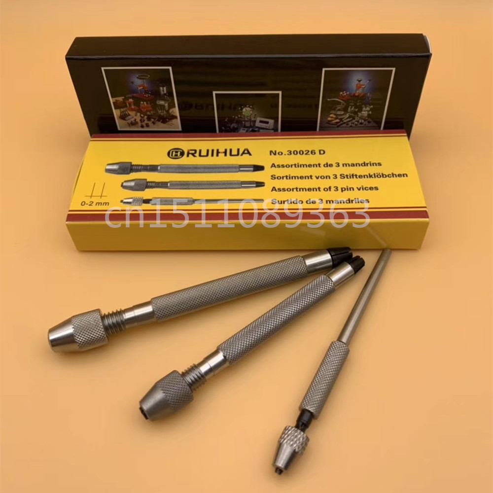

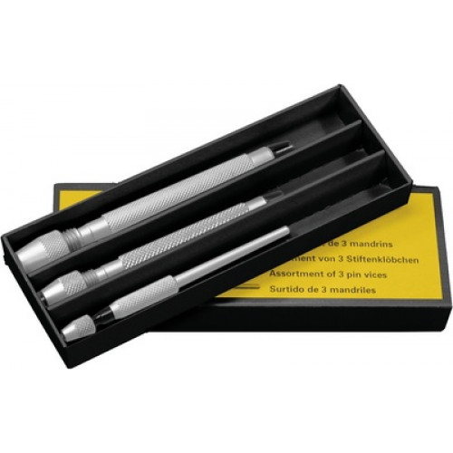

This is the set of the 3 pin vices on ali that look like the bergeon set 30026 d.
Would you say these are the same or just a good copy.
The box of 3 in photo 4 not showing bergeons name is genuine, it's a photo from bergeons site, the others  pics are from ali, do you think they're out of the same factory, as anyone got a bergeon set of these do they look the same.

Thanks i now see the difference, they're copies.
I will order a single genuine one from cousins to change my stem crown, i was thinking i'd get a set of 3 for the price of 1.
Thanks that was a good spot.
