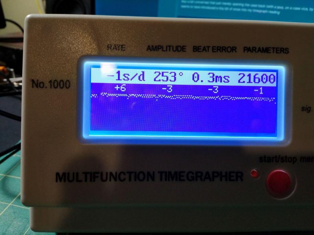

Ok my first attempt to regulate a watch. This wasn't the non runner, this was my newest one, my seiko speedracer.
Started out at +8 s/d and 1.7 beat error. On wrist was running about +8 seconds a day.
This took surprisingly long though. iv'e read a ton of writeups about regulating a watch so i knew trying to correct the beat error would throw off the s/d but i had no idea adjusting the regulator lever would also throw off the beat error. I just sorta kept moving stuff around till it feels like i got lucky. I had the beat error to .1 at one point but +33, i slowed down the watch and it threw the beat error up to 3ms.
I guess it's a balancing act? I assume there's a fast way to doing this balancing act so how do you guys deal with it? I know simply regulating a simple movement like this takes a skilled watch maker maybe 10 minutes.  I wanted to get that .3 beat error down to zero but i felt like i'd have been fiddling with it another hour at least and it would fluctuate between .2 and .3 so i figured good enough.
Does that signal look healthy? It seems....a bit snowier than before from just the moment i opened the case back and i can't imagine why that would be...
Edited by Birbdad
Hi After dismantling and cleaning etc any watch it is advisable to let it run for a while so it can "bed" in and give the lubrication time to get moving, after 24hrs or so then put it in the Tg and check the results.
Oh i haven't done that yet. All i did was regulate it. Somebody suggested i start small and i don't even have all my tools in yet to do a full service.
I did however just wind it up for a bit after not wearing it for days and throw it on the timegrapher.  I noticed with one of my other watches that wearing it for a day or two really makes it seem to run healthier, i guess cuz it gets the lubrication moving and stuff. I'm hoping that's it. I sure as hell didn't touch the hairspring. I did notice a TON of grime come out from inbetween the case and caseback, i blew it away as best i could before fully unscrewing it. I hope none of it fell into the movement.
Either way i'm wearing it now and i'll check it again in a few days after getting some wrist accuracy averages.

yeah, i wound it up some more and wore it another 5 hours or so on the wrist and now i'm getting totally different measurements.
Not sure what you mean by "regulate with a minimum of 20 seconds before taking the measurements in each position."? Could you explain that?
At the same time that doesn't explain why adjusting the regular lever is throwing off the beat error. Talking to another guy who says it means the hairspring is bent or off center. I sure as hell didn't touch it or bend it if that's true...
Edited by Birbdad
The adjusting components are all separate their stacked together which means they can all move independent of each other except they're not free-floating stacked together there's pressure holding them all together. So usually if you move one the other one can move.
The Seiko tech sheet I'm looking at it doesn't show them broken down a separate components so I had to get one off another tech sheet to show you..

yes they do use etachrons So given that the watch has never been opened till now and is fairly new what would make the hairspring off center? He told me a different procedure to move the etachrons that i'll try.
I was pushing them directly from the side occasionally from a VERY slight upward angle to clear the the grabber on the timegrapher and part of me wonders if that minute amount of downward pressure was pushing one lever into the other and causing both to move without me noticing since they're stacked on top of each other. I've seen watchmakers who do this for a living do it both ways but i'll try his way which is moving them from above with a pair of tweezers.  I"m gonna let it stay on the wrist a bit, fully wind it and try again tonight. He's also suggesting that since i'm measuring it cased that the acoustics of the sound in the case could be throwing off the beat error reading in the timegrapher. iv'e NEVER heard of this.
The 1.7ms beat error is high but both my 7s26 runners have about that same beat error from the factory.
Just for my clarification how do you know it's off-center? In other words you visually can see that it's off-center as opposed to somebody thinks it may or may not be off-center?
Then just a reminder regarding factory regulation of your watch or even service centers. If you can find the specification for Seiko watch it usually is a relatively broad range that can be regulated to. They do not try to regulate zero they only get it within the specification range. I know some people at work in a Swatch group service center and that's their guidelines they given a plus minus range all lift is get in the window and they stop they do not regulate to zero.
Yes this is actually very common with lots of watches. Lotta ties big and heavy cased watches are a problem for the timing machine. The Seiko watches probably because the plastic movement ring tend to be a problem. We've had watches at work where the Seiko looks like total crap on the timing machine taken out and put it in the holder directly without the case it looks perfect. The timing machine is trying to pick up the vibration through a very dense case with a plastic retaining ring it can be problematic at times. If you are timing with the watch in the case make sure the crown is facing out in the direction of the sensor touching the sensor preferably that we usually be the best but not IT just depends on the watch in the timing machine but yes timing in a case the right case can be a problem
I have no idea if it's off center. I'm in multiple places and he suggested that was the likely cause of the regulator lever also throwing off the beat error. I'm getting multiple opinions to try to figure out what's real and what's not and what could be causing this on a new watch. And yeah i know what the factory specs are. I just wanted to see if i could regulate it and improve what was there, start with something small like reducing the beat error and getting it telling a bit better time.
Also that's really interesting about the acoustics. They're suggesting i just wind it fully, let it run for a day and give it another go and move the etachrons from above rather than from the side.
Also where even IS the actual sensor on this thing? I dont' see one.

It's the problem with asking questions and getting answers. Ideally the terminal curve that the regulator arm moves through has to be in a very exacting location otherwise you will move the hairspring off-center. But if you move the regulator arm on a system like this you can also move the beat adjustment which will cause the exact same effect. See you have to bill of visually look at your hairspring and figure out if it's centered or not. Use the question and answers for guidance but you still have to make the call in the field where get us a super good picture. Plus you are set the figure out what that system how to get the hairspring set up properly anyway
If you look at what  the companies typically recommend for regulation of a watch is you're supposed to wind it up and let it run for 15 minutes to one hour that's considered fully wound up. They don't actually specify whether it should run overnight or not. Usually when you putting a watch together you don't just put the balance wheel in and run right the timing machine. On the other hand I never wait overnight for timing usually just regulate and you going to run a timing overnight watching the hands anyway for several days so if there's a discrepancy in timing you can put it back on the timing machine.
Then there's a picture of the sensor in the Chinese machines. As you can see it's down inside we not going to see it out of harms way. Then it is trying to pick up the vibration not the audio of the watch which is why sometimes the crown is the best thing now facing out it's because it transmits the sound better sometimes at least that's what the factories usually recommend.

I can try and get you a picture but I assume it has to be not running otherwise the spring will just be a blur right?
if i have to power it down i'm gonna make one more go at it and i still have trouble i'll take it. Just lemme know whether it's gotta be unwound or not.
Another member here says sometimes the levers just interact with each other and moving one will move the other a slight bit which is sorta what i suspected. I didn't sleep at all so i'm gonna hang it up till tomorrow.
Also the manual for this thing is the most unintelligible attempt at english i've ever seen XD I missed the thing about the crown. Man does that give a clearer signal!  Thanks bud!

Sorry if I wasn’t clear, my bad. So timegragher, dial up, wait 20 seconds before taking your measurement, dial down the same after you have made the movement, same for the rest. The watch needs to settle before you start thinking about recording that position figures.
I hope that makes it clearer, if not hit me up and I’ll do my best to help.
