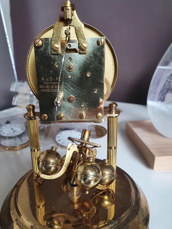

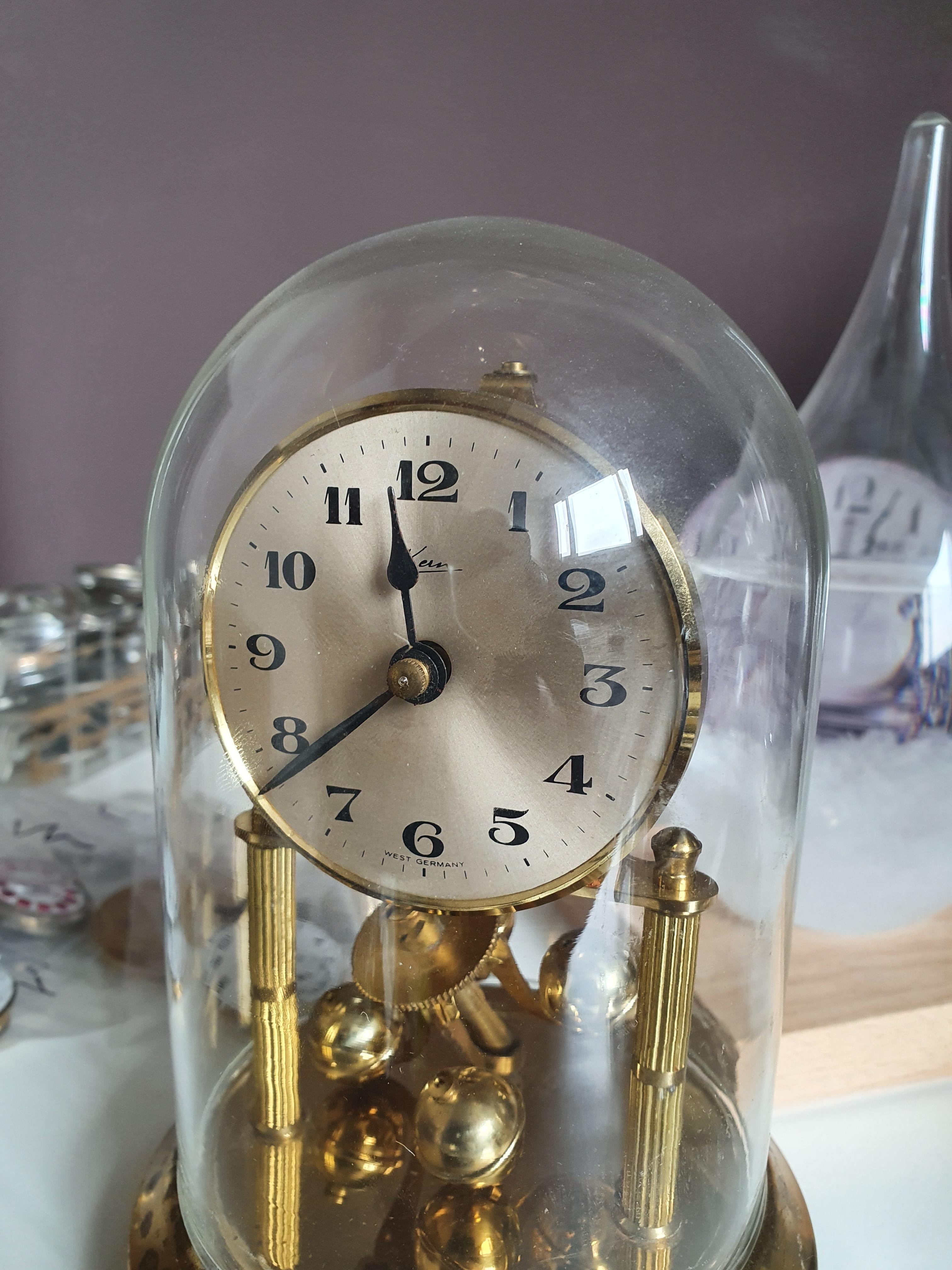

Got this as part of a job lot, probably cost me about 30 pence at the most.
First question, quality, good, bad or indifferent?
Second, I want to get it running. Do I need to strip it down or can I try something easier to start with.
Haven't done a clock before, so plenty more questions to follow.

Its low quality. It will need a complete overhaul. These clocks are very temperamental. If you have never done any clock work, this is the worst type of clock to start with. I can help you with it. For starters you are going to need a clock mainspring winder and this book   Charles Terwilliger Horolovar 400 Day Clock Repair Guide

Typical, I bought it because I like the fact that you can see the movement.  I could of chosen any, including the fancy one you like.  Anyway I'm having a go. Are clock mainspring winders as ridiculously expensive as watch mainspring winders?
Yes they are and they are hard to come by. But the good news is once you get a complete set of containment rings, you can work on most clocks. Well maybe not Big Ben.
Have a look at Cousins website
https://www.cousinsuk.com/product/mainspring-winder-ollie-baker-style
In addition to the winder, you'll need a set of let down tools and a beat adjuster.
Your clock might be missing the lower suspension block. But Cousins should have spares for that.
A 400 day clock is deceptively simply but a real pain to get it going. It's probably the 2nd worst clock for a beginner.

The problem is, I won't be working on more clocks, just that one.  I  thought it would be easy, oh fool me.

Most chiming movements need cleaning and re bushing due to wear. Sometimes springs need replacing and always if it has a pendulum replace the suspension spring.

In order to properly service any clock that has its springs in barrels it is a must to have a mainspring winder. The only other way is to remove the spring in what way you can and replace the spring with a new one. Mainspring winders remove springs in such a way that the spring is never distorted. Springs out of shape can and do damage the barrel and will cause the power to be irregular which causes the clock to keep poor time. The strike and chime springs will cause the strike and chime to work in a poor manner.
O.K., they should have been writing „assembled manually in high perfection“, right?
„PI“ indicates the movement P 400. The plates should be 54mm x 44mm x 1,3mm.
Edited by Kalanag
As OH states 400 day clocks are temperamental and will not run for a duration without every part being spot on..Example if the suspension spring has the slightest kink it will not run and if the spring is slightly under or over strength you will run out of adjustment. To summarise if you are not prepared to strip, clean and inspect every part you will spend hours fiddling and adjusting without success.

To Attempt to repair 400 day clocks is hard enough but bwithout twerwilligers book, beat setting tool, and knowledge a waste of time as theyare as mentioned tempremental and will not run unless dead level.  They are not the type of clock you fiddle with you either get stuck in and repair the thing which may take days /months to get it working correctly.  On the face of it the mechanisms are simple single train, what can go wrong ? try one snd find out. I have several of these guys and love working on them.  The last one was a Bentima broken spring (the usual problem).  They were factory produced in Germany not overly expensive unless you pock up a Gustav becker (disc Pendulum job).  all the best and gook luck if you attrmpt the repair.
