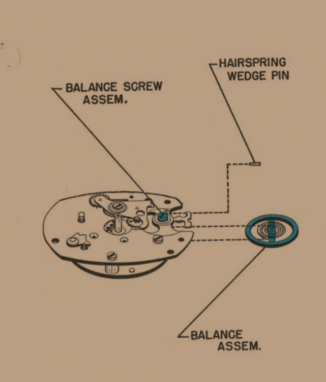

Well I've had a mishap, I tried to do the service according to the service manuals for once and while attempting to repin the hairspring, the brass pin flew off into the ether, never to be seen again. This was after a couple of hours trying to get it repinned. I've come to the conclusion that I'm probably never gonna try that again, but I thought I might as well ask if anyone has any tips that would make it easier in the future if I did attempt it. Thanks!Screenshot_20220518-002250.thumb.png.e7f47426e7262064987e50b1487461da.png
I don't know if it's the same in the watch world but I have seen in the clock world that new tapered pins are much longer than needed making handling much easier, once fitted they are cut to length. I assume it will be the same for pins supplied for watches.  Provided they are available that is, otherwise it's a case of make new pins yourself and make them longer than needed to help with the installation. Not sure how you make them yourself unless you have a watchmakers lathe.

But honestly, don't use a pair of tweezers to hold the pin. Instead, dab a bit of thick grease on the tip of an oiler or screwdriver and stick the end of the pin to it. Then carefully maneuver the tip over the stud hole and push it in. I learned this trick from @Nucejoe .

Cousins do sell hs pins. It is possible to fit them with fine tweezers.  It just takes a steady hand. Reduce one of the tips on your tweezer of choice, just slightly. Then when you have inserted the pin use the adapated tweezers with the longer end against the back of the stud and the shorter end against the pin and gently squeeze the pin into the hole. This was one of the first things i did when i started to learn watch repair it was on a small 453 Oris. If i can do it ashket , and im pretty clumsy sometimes then anyone can

Actually, they did.  This from the service manual for the 23 movement:
Quote
To clean the Timex Model 23, it is necessary to remove only the minute hand,  dial and balance. The illustrations on Pages 23.3 through 23 .5 shaw proper  procedures. Timex has found, through long and careful research, that the best  method of cleaning is with only the above-mentioned parts removed.
That was the advice given, in 1960 something.  The "cleaning fluid" was Naptha, lighter fluid.  These were watches you bought at convenience stores or the paper stand.  They were worth less new than a watchmaker would charge to service them.
So, it depends on what Timex you are talking about but the poster didn't say, hence my throw away comment.  Pre-quartz timex were a disposable that no watchmaker would consider working on.  Now of course, those same mechanical movements have a keen following.

These are the instructions from the Tech manual. I see no mention of Naptha or lighter fluid.

and again here are the instruction from the 1961 service manual - no mention of natpha or lighter fluid.

Hey JerseyMo what fluid would you recommend using, I have to admit to using ronsonol lighter fluid, then two rinses in 99% isopropyl alcohol as I understand there isn't any shellac in the movements. What should I change the lighter fluid to?
ammonia, water rinse air\blow dry, lighter fluid, air\blow dry.  basics developed my the former members of the Vintage Timex Watch Forum which I was a core member of.
