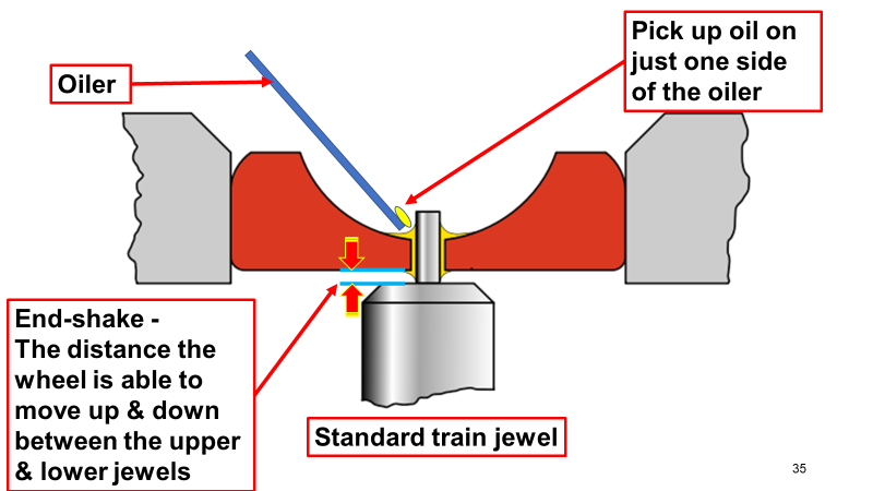

End shake is the axial free play of any arbour or balance staff
Check end shake on all arbours of gear train including barrel that of the barrel.
Adjusting a jewel might be all your watch needs.

You move the jewel in or out in the hole its in, so to create some end shake needed for gears to turn effortlessly.

Yes,the issue is in the gear train and is very  likely an end shake one and we are trying to show you how to spot it.

It's a pity we can't post a video. I've got a great one I show my students how to check end-shake, filmed under a microscope
So, if when the screws are screwed tightly, you may have the jewel Shown in red in the pic) which the pivot passes through bind tightly against the shoulder of the pivot (which passes through the centre of the jewel shown in red) which doesn't allow for any up and down movement of the wheel, therefore the power can't flow properly, stopping the watch. Sometimes the jewel has moved and needs pushing out to regain that end-shake, which really requires a special tool. It could be either the jewel in the mainplate or the bridge, so either top or bottom jewels, so with tweezers you would hold the spoke of each wheel and see if it can move up and down slightly. you should feel it more than see it. more end-shake on the bigger wheels and less on the escape wheel and balance.
I must say, I like your enthusiasm starting with a 7750, regardless of being a clone or not! He who dares, wins!
BTW, that was a slide from a lesson regarding oiling, just in case you thought what oil had to do with anything... lol
