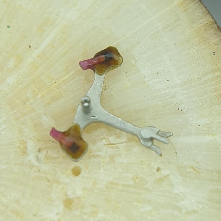

I popped the back off and found that the balance wheel could be turned but it bangs into something. I assumed that the balance was overbanked, probably from a hard bang during transport.
But when I took off the balance and inspected the pallet under a microscope, I found that the entry pallet is so deep that the escape wheel can't unlock.
Just look at the amount of shellac on the fork!
So the entry jewel can't unlock, how did the seller test the movement to be accurate to 2-3 minutes a day? Are they checking the watch at the same time everyday, so the time on the watch shows the correct time?
Haha yes it's extremely accurate but only twice a day. My guess is the seller was just a little bit shy on the truth. Its kind of nice looking though in a dodgy non genuine wasted some money kind of way. Nice bit of shellac as well, I could french polish two mousemen sideboards with that. 👍

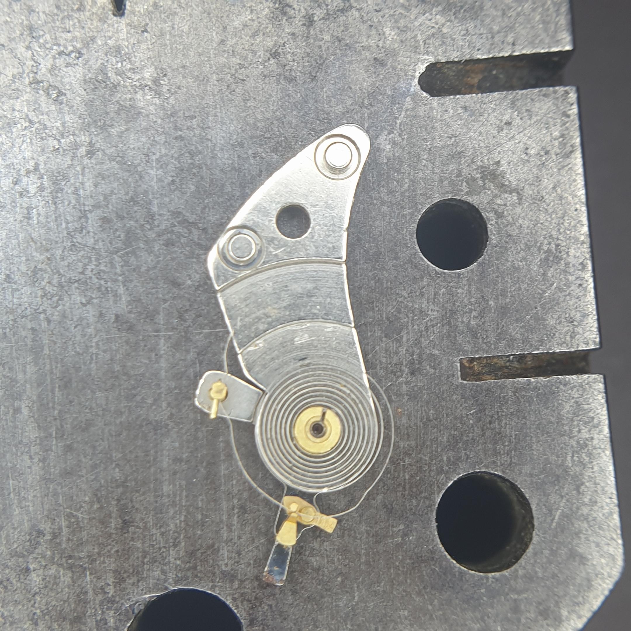

I took the hairspring off the balance wheel and fixed it back to check the centering and this us what I found.
There was no endcurve form at all.
Another interesting feature is the strange regulator boot. Never seen this before.
Got the endcurve formed and centered the hairspring.
Now to check the poise of the balance wheel.... if I can find my piosing tool....

6 minutes ago, Nucejoe said:
The hairspring doesn't look original to me, lets hope you get the right rate out of it.
Fat chance. If it were original, it should have an endcurve already formed. I don't think the balance is original either.
No shortage of ST96 balance with broken staff pivot in India, this one might have been restaffed.
Mumbi specials are good for newbies to practice on. You, however, can find a challanging task here, build a well poised balance complete out of these parts, you make an A+ in my books. Original Indian made hairsprings are of low quality too.

I've seen worse readings and looking at the amount of shellac on the pallet, I'd be thinking of counterbalanced the other end with a house brick. 🤦‍♂️
At lest it resembles shellac, I've seen a couple where I'm pretty sure someone had used superglue.
